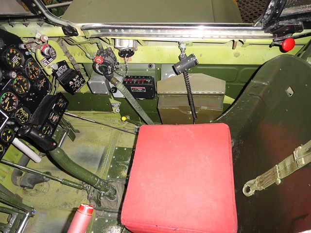

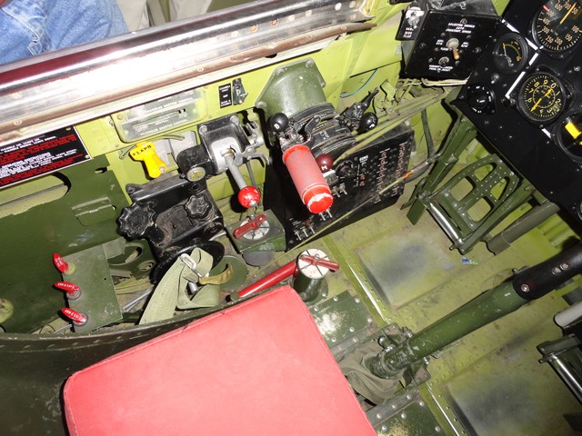

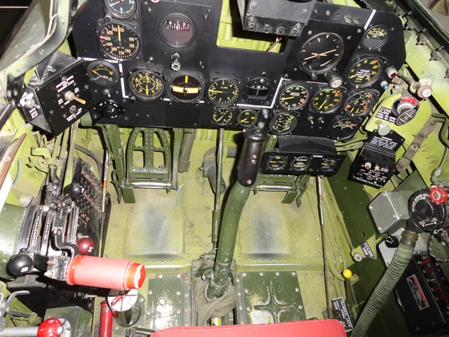

I had the opportunity to climb into the cockpit a P47-D about 4 years. I did not measure the panel, but I do recall it feeling very roomy. I'm not sure if these will be of any help to you, but I included the photos I snapped of the cockpit.
You can see that the outer frame of the rudder pedal mounts are just inboard of the instrument panel (like you described), but the pedals themselves are quite wide. You can also see that the wear marks on the floor are more towards the inner edge of the pedal, so, the seating position might not be as uncomfortable as you think.
Hope this helps ...
Hope this helps ...

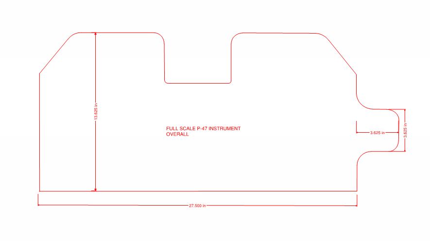

@john534: Thank you, that's exactly what I was hoping to find. If you don't mind me asking, where did you get those figures from? If it's some book or publicly available source, then it may come in handy in the future, both to me and to everyone else doing a P-47.

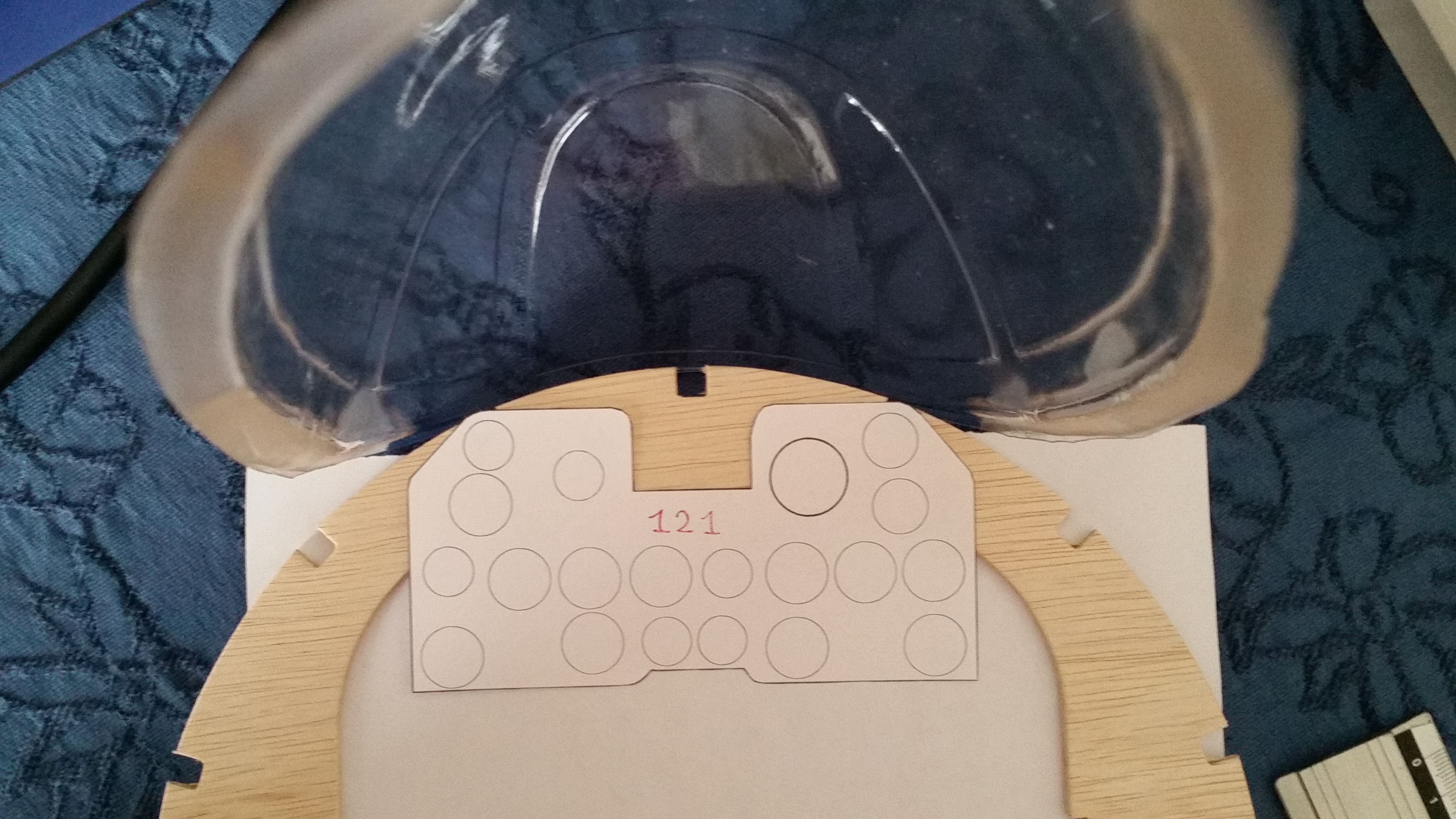

Anyway, I printed a paper template of the instruments panel to the scale size (27.5" / 5.75 = 4.78" = 121.5mm) using a template that I already had (even though it lacked size information, so I had no idea how big it had to be). Then I placed fuselage former F3 and the canopy one on top of the other (leaving a gap to account for the thickness of the sheeting), and finally played around with the position of the panel. The former should be of the correct size and shape (according to the 3-views that I have), but the canopy may not be 100% scale, so I may have to find (or make) a more scale canopy later.
Attached is a picture of the result. I'll also attach a few photos that I used as a reference. Opinions? Does it look reasonably close?

To my eye, the template you printed up looks a bit small. In the photos, the tapered portion near the top seems to stick up above the natural curve of the fuselage and actually comes closer to the forward canopy frame. But that is just eyeball accurate, so take with a grain of salt
). If the figure reported by John is accurate, then the size of the panel should be correct. And the former seems to match the 3-views that I had blown up to the kit size. So I don't know...As for the position, that's a doubt I have as well. The photos that I posted seems to suggest that the panel should be higher, but when checking the 360° posted by bunsen one can see that there's a complete fuse former behind the instruments panel. And it looks to me like the top corners of the panel more or less line up with the outer contour of this former. Back to the photos that I posted, one can just about see the top of such a former behind the panel. When taking into account the perspective distortion, it seems to me like the corners of the panel do indeed line up with the edge of this former.
So I suspect that this should be the correct placement, but again, I'm open to suggestions.

After taking a closer look, I tend to agree with your current assessment after all. The plane I photographed is in a museum that is not too far from me and they have open cockpit days where they let visitors climb into the cockpits of many of the planes (none coming up in the near future though). I know it won't help you now, but I will let you know the next time they have one, and if you have other questions, I will try to get the info for you.
