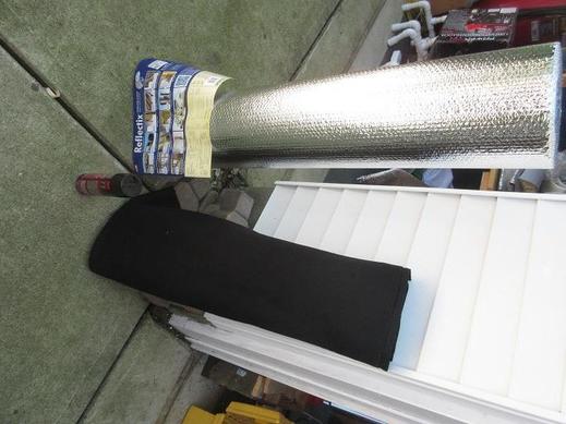

Wing/tail feather protectors.
Materials needed, plus aluminum tape.
Insulation at HD, 3M spray adhesive and felt cloth.
Best to have the insulation 'weave/grain' along the length to aid in folding in half.
Spray the the 3M to the insulation (not needed on felt) and apply the felt.
No need to worry about wrinkles as it's interior and the wing won't care!
Best to have about 4" too big of felt around each edge in case initial contact is off a 'bit'.

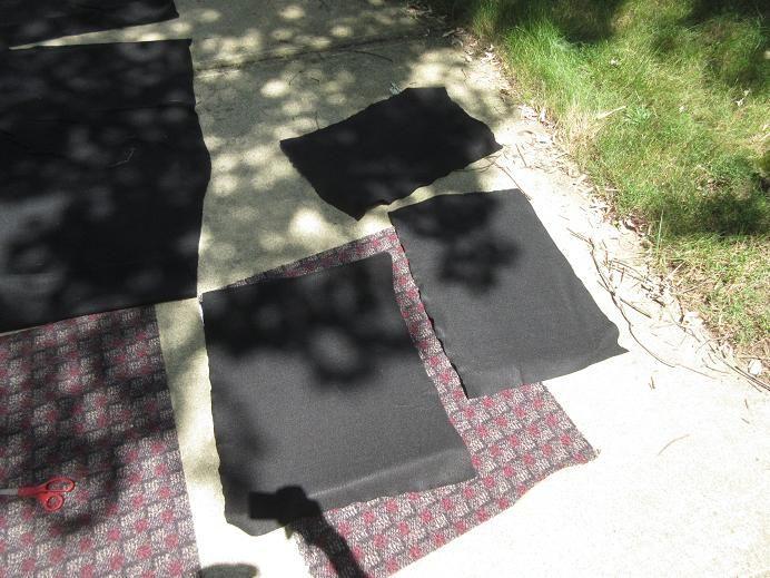

Tail feather covers.
Wings done.
Pockets for guns and wing tubes.
Tail feathers.
Some velcro across the felt helps keep the covers from sliding off.

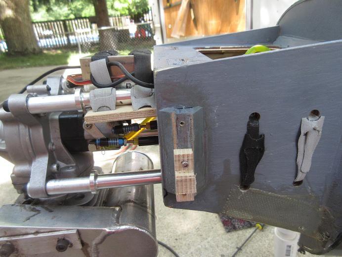

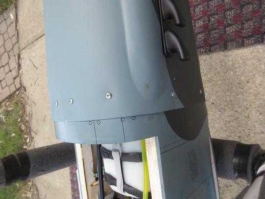

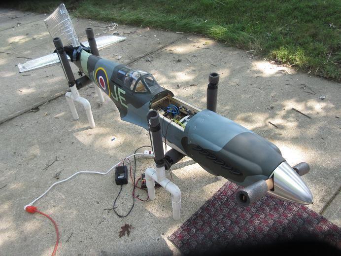

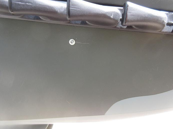

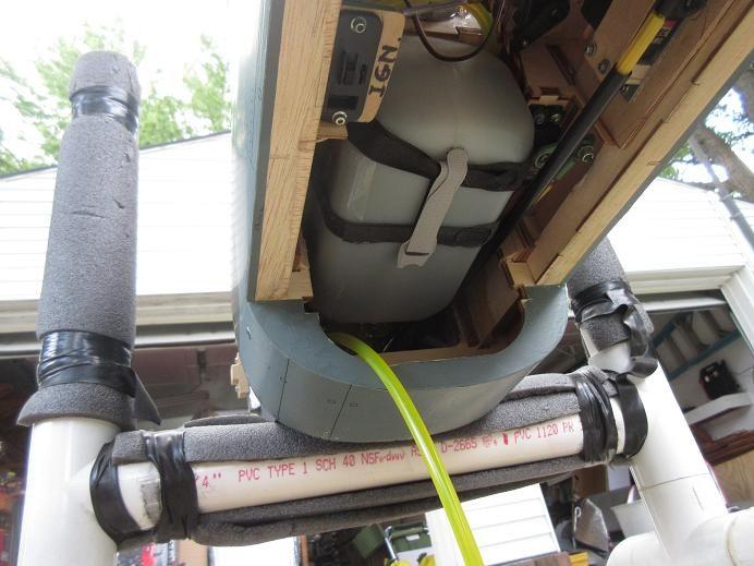

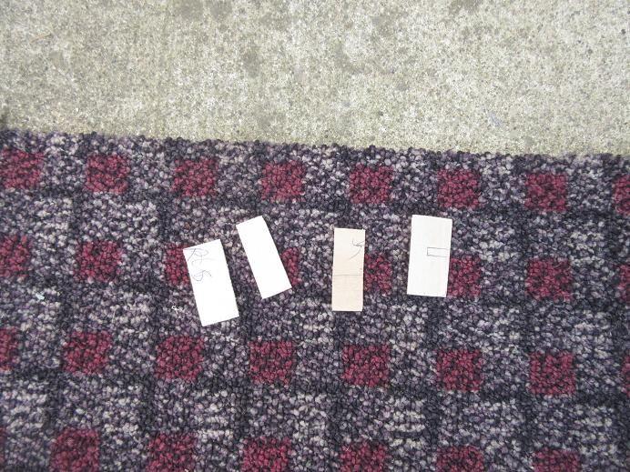

Cowl install.
Since I have the cowl out farther than suggested, I installed two pieces of T shaped ply along the sides of the fire wall so the front of the cowl can be secured and reduced vibration.
Inside view of front cowl mounts.
Along with epoxy, these were also mechanically secured.
Also, epoxied some 1/8" thick aircraft ply along the top inside of the fuse to secure the cowl.
Fuse upside down to let gravity hold the four pieces of ply while the epoxy cures.
Finished product.
Used large button head screws.
Total of 10 screws holding the cowl to the fuse should 'do it'.
Presently, some hex head servo screws holding front of cowl to fuse.
