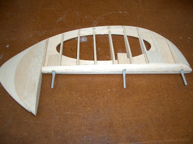

navy18,
i was at whiting in '86-'87 and got winged in kingsville in june '88 so i think you were a little earlier than me. as far as engines, i'd like to use either a pumped O.S.91FS or a RCV90. regarding pictures, i just use the "upload images" link at the botttom of the posting page.
doug d., your spit looks great! did you take any pictures during your build or post to a website? i'd like to see some if you did.

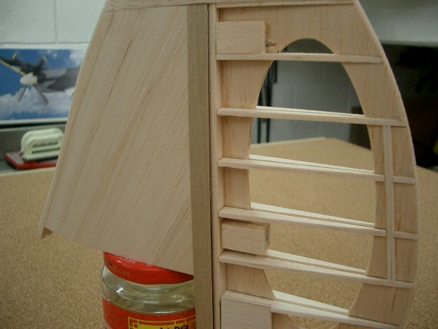

mark, what i'm actually trying to do is make the joiner a little larger diameter and blend it into the elevator halves so that it looks more like the real one. maybe you can see what i'm talking about in the photo.

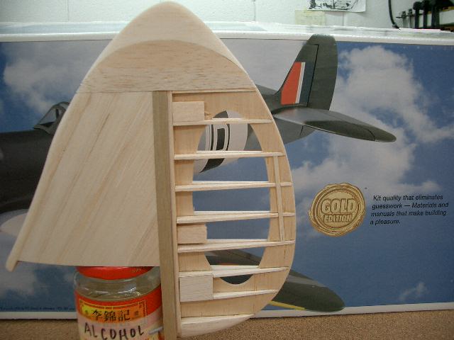

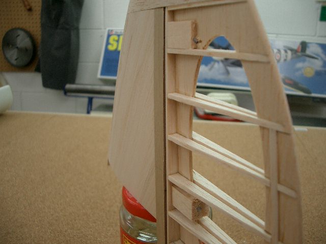

ORIGINAL: phread59
I gotta suggestion on the dowel. How about you glue the dowel in. And get a very small dowell, I think a 1/16th or so. The metal one needs a hole drilled into the stab any way. Why not just drill a hole in the dowel and glue in the small dowel as the metal joiner would? I did this on 2 of the kits I did to eliminate the metal one. Worked well for me. Hope this works.
Mark Shuman
mark, at first i didn't follow your post. but after sleeping on it i think i realize what you meant. basically, make a "U" out of dowels instead of using the metal "U" supplied....yes? i think that's a good idea since it gives the support needed for the elevators. thanks!

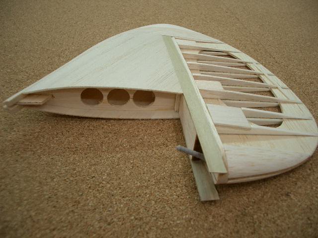

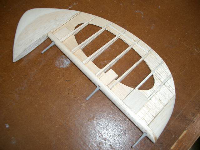

well, i've finally made it back to my shop and have had a chance to do some more on the tailfeathers. here are a couple of shots of the rudder. originally, i wanted to shape the rudder with a pointy top to resemble the enlarged rudder that some MkIX's had so that is why these pics show that modification. however, i could not find any MkIX's in desert camo that had the enlarged rudder so i will be removing the tip and making it more like the plans. also, i intend to have a non-functional trim tab which just needs to be separated at this point. the leading edge has been rounded instead of beveled.
ID:	93977   Click image for larger version
Old 01-25-2004 | 03:54 AM
  #49
Joined: Feb 2003
Posts: 1,076
Default RE: TF Spitfire build
here is the fin/rudder together. i've included a couple shots of the hinge gap covering. this is the first time i've tried that and it really wasn't hard to do. the hardest part is trying to figure out how far out to extend the covering over the leading edge of the rudder while not causing any binding with rudder movement. the photo with the kit box in the background was to show the difference in the kit version of the rudder (rounded tip) vs. what i wanted to do (pointy tip) but, again, i've scrapped that idea. the other photo just shows some of the lightening i was trying to do in the tailfeather area.

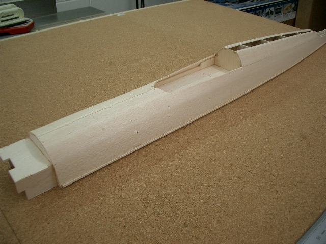

Old 02-14-2004 | 12:35 AM

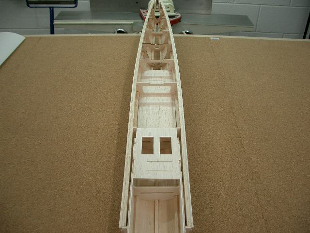

  #50
Joined: Feb 2003
Posts: 1,076
i've had a chance to work some on the fuse. pretty straight forward. build the top half first, flip it over and do the bottom as with most TF kits i believe. i've just done the top so far. went together well except for a problem with some of the fuse formers being too small. this problem has been addressed before with this particular kit and supposedly was fixed by TF. either i got an old kit or it not been fixed. anyway my solution was to just use the supplied formers and fill in any gaps with scrap balsa. the balsa sheet is 3/32" for the fuse and takes quite a bit of wetting, bending, wetting bending, etc to get it curve around the formers. i thought i would crack the sheet at first but by being patient it slowly formed around the formers. i pinned the sheeting in place until it dried then removed it, applied glue and pinned it back in place which seemed to work well. i also discovered a big discrepancy which is the lack of the full size template for fuse skin stated in the instructions. what is actually supplied is a small template in the back of the instruction booklet which is useless unless you scale it up exactly. i ended up just going with trial and error.
i slightly modified the instructions in that i did not inset the balsa blocks at the back of the cockpit per the instructions. this block rests next to the first turtledeck former and i could not find any documentation that demonstrated this so i just glued it in flush with existing side rail.
