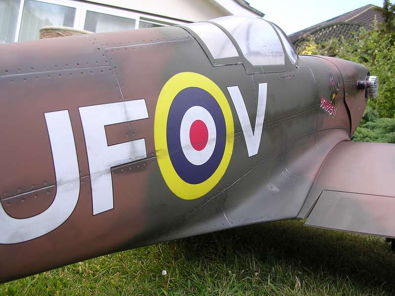

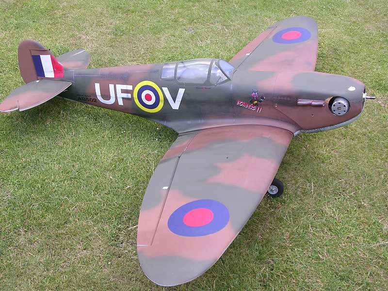

SJ, are you not wondering if there's something missing to it? I was with my GSP/Flair Spitfire until I weathered it!!!!!!!!!!!
transformed the plane, the pics dont do it justic.

Hi Dave03B can i ask how did u weather it ?
What did u use and what steps ?

Its my first attempt at weathing, and is done with only two materials!!
do you think it looks better than "out of the box"? need opinions!

Weathering looks good. A technique I might try on mine is to use a scotch brite pad vertically on the fuselage, chordwise on the wing. This has been suggested by Sean McHale that he used on a most excellent BT Spitfire he built. Can't remember the web address now, but do a search.
Anything looks better than that fresh paint that they come with. So how did you do it??

Quite basic really. 6b pencil into panel lines, then rubbed.
Wings were more touble as no panel lines, so a light shading of 6b pencil along the leading edge, then 3in1 oil over the pencil, then smudged down the wing, then dabbed off with a cloth.
Hope you like! I suggest you do it, it makes 'em look completely different

Great pictures Dave.

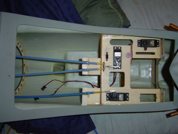

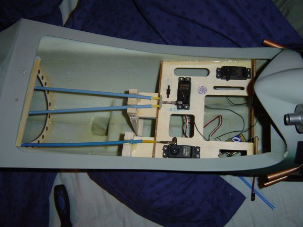

Hi....I have been working, so not too much spare time to finish the Zero.
Im satisfied with the way it is built. All the wooden parts (wing, formers, horiz. tail) are laser cut, so the guys building these things cant get it wrong :-) Glass work is great. Couldn`t have done it better myself :-)
The covering is monokote type, and painted. The paint chips off if you bang it into walls and stuff. :-) But I have some Humbroll paint that almost matches, so its not a big deal. The monokote undernieth, is clear "colored".
For the price of this kit, you cant go wrong.
Looking forward to get it in the air!

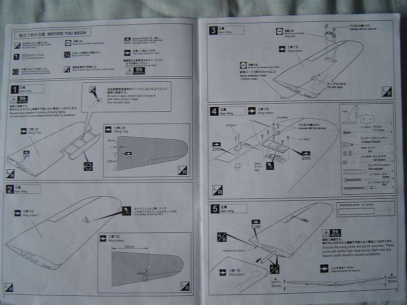

Hi SJN.. I just picked up this same ZERO,but could use your help.
***"SJN"- is there any way you can take picks of all the MANUAL pages for this ZERO and post them here??***
When I got home with the ZERO,I found that it had no Manual in the box and person I got it from cant found one or get one.
I hope you can help me out.
Thanks....

Thanks guys.....
Tell me if these pictures are good enough.
Woody 51, yea, I agree with you. And I think that they will only get even better with time[8D]
Hmmm.....so it was a waste of money to get the saito.......well at least it will sound better....and maybe hover the zero [8D]

Hm...... RCU resizes the pics.
download them here in full size:
http://bornholm.adsl.dk/modelfly/files/zero/manual/

THANKS "SJN"!!!!! Thanks for spending time to take the pics.
You were a Very Big help.

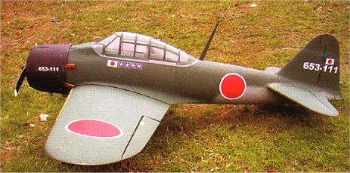

thanks for the article Dave.
I wonder why he didn`t trim the canopy....it looks rediculous

The antenna also points the wrong way
