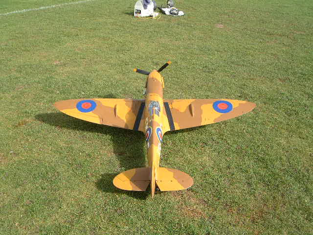

hello lee......
I used to own one of these planes,before it got shot down 6 or so mnths ago......i found the kit easy to put together.....although the instructions were in russian...with a little bit of english as an after thought........i put an OS 120(3 blade graupner prop 16 x8 ) in mine with standard futaba 3001 servo's....which worked great.....I used most of the hardware they provided....only changing the snakes for sullivans on the rudder an elevator.......the wing comes in 3 seperate pieces an fixed U/C....if you want to put retracts in it then your gonna have to cut out the wells an holes for all the plumbing.....this will add quite a bit of weight to the model.....I was lazy an went with the fixed U/C....it was the first model i built(second one was the trainer i learnt to fly with....).....I just looked at the spit for one year until i was ready....lol.....
anyway.....i finished the model with FLAIR paint in the desert scheme....oh....i changed the engine mount as well to an ali one...
it needed quite a bit of lead on the nose to balance it....cant remember how mutch......but the cg is bang on in the instructions....110mm from LE......my spit flew great....i would recommend this spit to anyone who loves spits......since the demise of mine I went out an bought a 102 in WS fibreclassics spit
....that im in the proccess of building
good luck with yours

hi again,
landing the spit was always an event for me.......not due to the plane......only with my inexperience......I never had flaps on this plane....i was in too much of a rush to finish it......50% of the time i could get 3 point landings......the other 50%....well.....!!!!
thinking about it reminds me of some of the worse landings i had...
loads of nose overs.......one wing too low a few times as well that sent the plane spinning......the most damage i ever did to it was a couple of wing bolts snapping.....!!
as for stability......rock solid....!!.....on rails....!!
the servo's are mounted in the wing(wells already cut for you an ducting holes for your extention leads as well)...you only have to glue in a couple of blocks for the servo screws.......
detail on the fuse was good with panel lines an screws all moulded in.......
the cylinder head was the only thing you could see......engine had
to be mounted upside down.......it all fitted in......bar the exhaust..
again in too much of a rush to pipe it.......
what are you waiting for .........go buy it.....you wont be dissapointed i promise........
