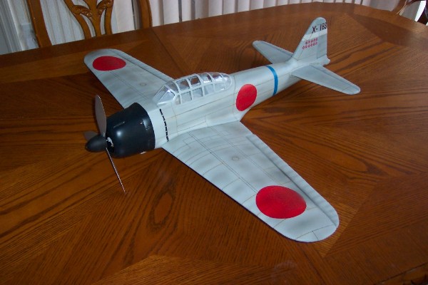

what is the best way to put panel lines on your warbird
thanks
dan
Old 12-06-2004 | 10:21 AM
My Feedback: (12)
Posts: 630
From: Madison, WI,
Default RE: panel lines how to
I think it depends on what you are trying to replicate. For butt joints lay down strips of chart tape, primer over them, sand down until the tape shows, remove the tape and you have a panel. For overlapped panels lay down a piece of 1/2 " masking tape where the overlap occurs, prime and sand as before. For just lines use a panel line pen just prior to applying clearcoat.

Adding panel line is quite easy. This is the first one I've done, it turned out well and it's one of the best things you can do to give it that little extra.
- get a 3view with lines
- draw lines on the plane
- place tape over lines (chart pak or equivilent)
- couple coats of primer
-remove tape
-admire

I take and draw the lines on the fuse first (it gets covered with paint anyway). I have a long aluminum ruler and a flexable ruler for the corners. Then just lay the tape over the lines. It's not exactly too scale, but with the yoyo's I fly with it will impress them, hehe

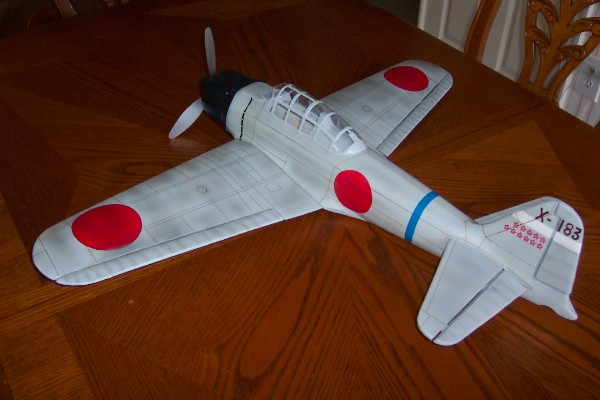

I use a MICRON pen .005.
