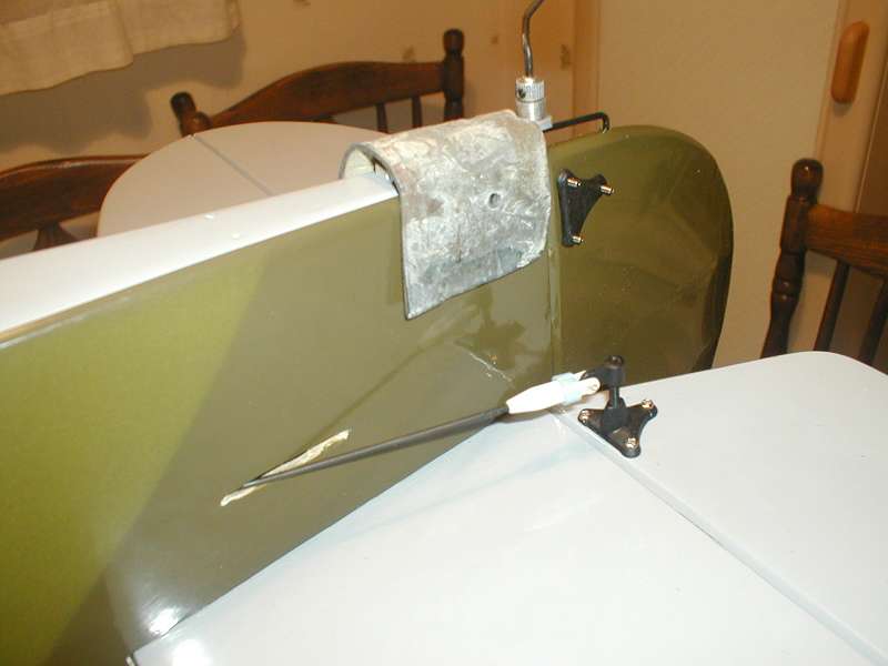

Hi Guys,
Ive just finished my World Models P-40 and i have a SC 80FS upfront, with the batt pack etc as far back in the fuse as it can go, but its still very nose heavy......... ive weighed it and it needs 90 Grams of Lead on the back tail wheel to balance it at the recommended CG Point....................
Is this alot ????? just looks like...........

Ok ive took some pictures to help anyone understand ........... the batt it at the rear with the black tape round and the second pic shows how much lead is needed in that postition to balance the model ...................
I gather i could just bolt it on and paint it............... but does anyone one else have other suggestions ???????????????

your are right . That is a lots of weight to put in the tail. Something does not add up. What method do you use to check the balance. The best way I know to check the balance is to put the plane in level position, that is tail up straight, level flying position, then lift it with tip of your fingers or some other method straight up on CG as close to fuse as possible, when you do this the nose should drop a bit. Great planes CG machine and jigs like that are notorious for balancing planes.

Thx for the reply i am using the Great Planes CG Balancing machine []

Do you have Retracts fitted to your plane? if so are they retracted or lowered when you are balancing your plane?

I guess we found the problem.

Wierd thou ive allways relied on that, guess ive just been lucky not loosing any planes as of yet.........................
I will try with my fingers tommorow on the CG Point.........

Yes i have retracts fitted and they are retracted into the wing when im balancing it ???
I assume thats correct ??

I had a World Models Midget Mustang with an OS .91 4 stroker on it. I seem to remember having to put about 4 oz in the back to balance. 90 grams is a little under that. I just cut the balsa off the back and glued the weight inside and then closed up the bottom and re-covered. I use past tense as I lost the plane when a clevis broke...flew very well. so well in fact I have another one.
The plane was designed for a .60 2 stroke and the .91 was a bit heavier. What size engine does the P-40 call for? 3 oz in the back isn't all that much. Better than 12 ounces in the nose. There's no way to move that battery back further into the tail tunnel with a servo wire extension?

The P-40 calls for a 70FS but ive gone for a bit larger with an 80FS soo thats why i may be having these problems.........
I will try to balance with my fingers tommorow like someone suggested......... but if its still alot out i will try to move the batt pack one step back and then cut some balsa away in the tail then glue wieght in............
Will it stay secure if i add weight that way ? will i need to reinforce the block im gluing the weight 2 ? i guess expoxy should hold it in place ok....
Thx for ur help just never had a tail heavy problem like this, as its allways been nose heavy....

I'm sure you guys know this, but in case, heres what i do with my low wing warbirds, balance inverted landing gear retracted.
Heavier CGed models will land, in turn, light non GCed models will be troulble.

Yeah i was balancing it inverted and with wheels up in the wing...... but still getting very nose heavy reading

There is nothing wrong with Great Planes CG machine. In fact, it is very accurate. I used it to balance my TF P-40, and that plane flies like a dream.
Yes, always balance a P-40 upside down with the wheels retracted.

Yeah, epoxy works great. Just epoxy the weight to the stabilizer...you have all the big flat area in there doing nothing.

The CG machine makes you balance the plane in its most unstable configuration, ie, worst case scenario. So if the plane flies right side up, it is guaranteed to be more stable. Plus, if one decides to fly inverted, then one would rest assured that the plane will have no problem doing so. All low wing planes should be balanced inverted. Nuff said.

Ive pushed everything back as far as i can to save less weight and then used the GP CG Gauge and now all i require is 40 Grams which is no problem to put on the tail wheel............
Thx for everyones help.............
Well shes allready to go soo hopefully weather permitting she will be in the air on Sunday......
