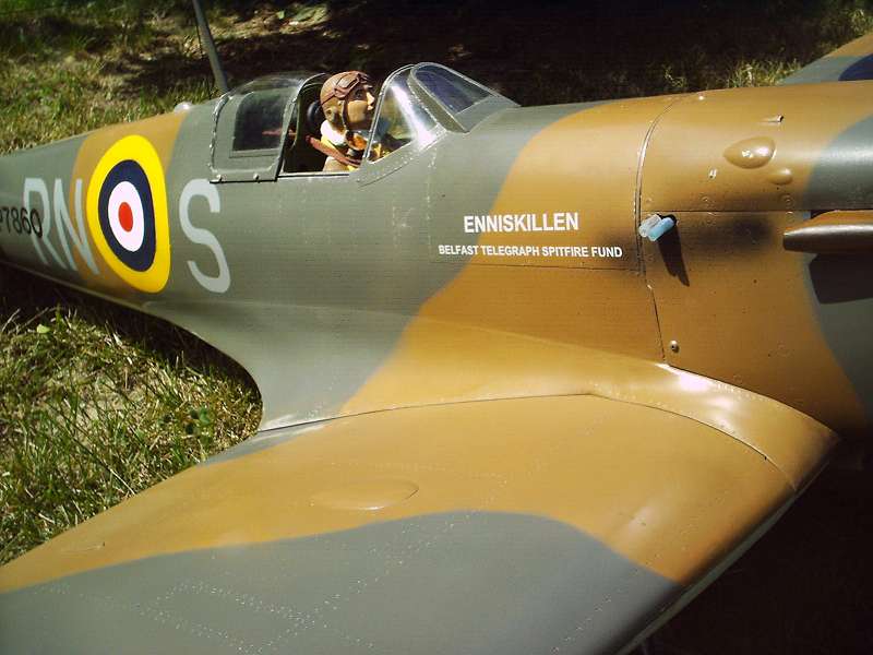

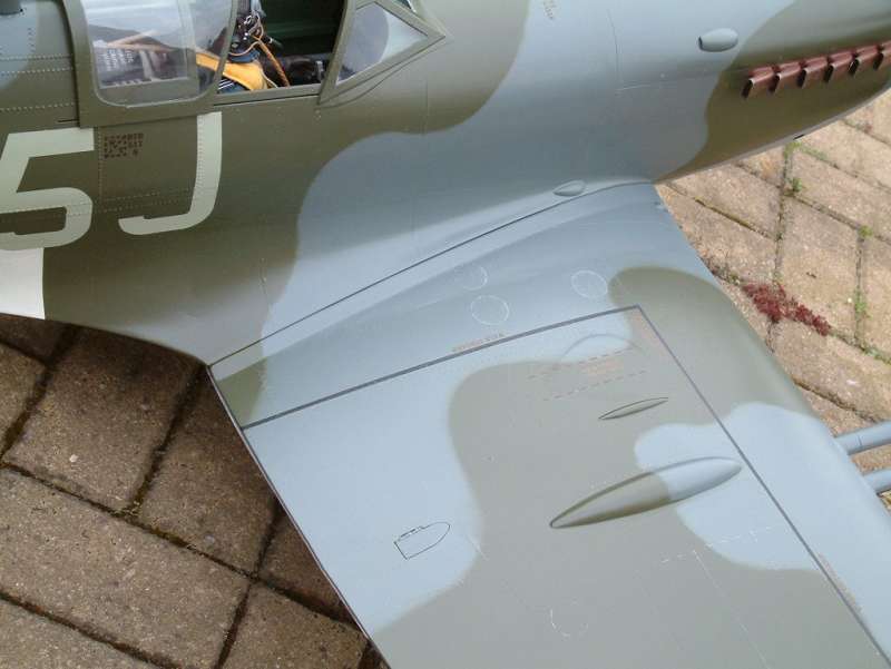

Rudy if it's high build primer 2 good coats will be fine. If it is standard aerosol primer 3 will be necessary. Remember also there is no need to prime the entire surface, just spray along the line of the tape, the fan overspray will feather nicely.
Attached not on my web site but shows the clarity of 3 coats from a can!
Good look.
PS mark out both top and bottom wing before you apply the tape. I did top and bottom separately and made some minor errors in alignment.

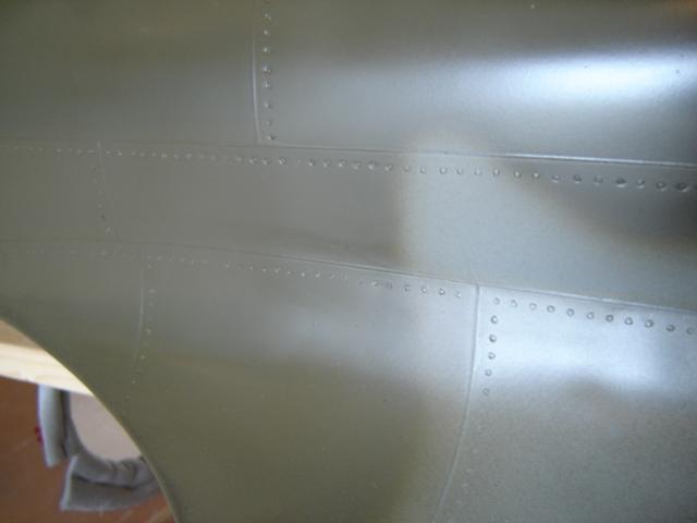

Nice pics, could you tell me how did you apply your rivots, are they glue or pressed in?

It's my first attempt at a scale model having built "none scale" many times. The Spitfire in the pictures is a Mick Reeves 1/6 scale and is almost ready to be let loose, but not for a while. I am reasonable happy with the result.
Carver the rivets are applied with a soldering iron and took a 3 weeks of evenings to prepare and apply to the fuselage and wing.
I have posted a link on this forum to my web site before, but here it is again. You can see the entire build bang up to date.
[link=http://www.hbc.pwp.blueyonder.co.uk/models/spitfire/index.htm]http://www.hbc.pwp.blueyonder.co.uk/models/spitfire/index.htm[/link]
The next one will be better
Just need to dirty this one up a little to make it less crisp!
