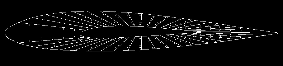

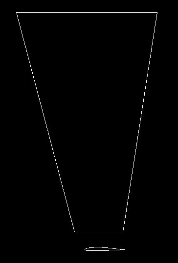

I’ve seen some interest expressed by RCU members concerning methods of how to generate rib patterns for a tapered wing. As with most things there are multiple ways to “skin the cat” but I thought I’d share the method I use for those who may be interested. This particular method is only workable on straight taper wings (or fuselages for that matter), elliptical shapes are a different colored horse and, quite frankly, I’ve not figured out exactly how to do an elliptical shape yet. I’m using AutoCAD for my design work but the principles are the same no matter what software you use, or even if you don’t use any software at all. A ruler and some French Curves will do the job, just not as quickly! This whole process will be much harder to adequately explain than it is to accomplish so feel free to ask questions if something is not clear. I will also preface this by saying that everything I know about AutoCAD is what I’ve taught myself. You AutoCAD experts out there know just how massive a program it is and I’m sure there are some processes that can be done with more efficient methods than those that I’m aware of. Please feel free to interject here as well. I’m always happy to learn better/faster/easier ways of doing things!
For the sake of this particular tutorial I’m going to assume you already have your root and tip ribs selected and have generated drawings of them. Just getting to this point can be quite an involved process but I’ll leave that for another thread. Below are my two airfoils, these being for a Japanese Ki-46 Dinah that I’m currently drawing up. Notice that the root is almost symmetrical while the tip is much closer to flat bottom. No problem, using this method we can loft from a circle to a square if we want to! Also notice that I’ve set the tip rib at three degrees negative so that we will automatically loft in the desired wash-out.
Ok, now that we have our root and tip ribs the next step is to divide them both up into an equal number of segments. In this instance I’ve divided each rib into 20 segments. The more segments you use the more accurate your lofted ribs will be but more segments also means more work as you will see. (And to be honest I probably would have been just fine with a few less) Just play around until you get the feel for it. Gentle curves require less segments while steeper curves, such as the leading edge radius of the airfoil, will require more segments. For the time being I am not going to loft the leading edge of the airfoil as it will just make things more cluttered than they already are. More often than not you don’t need to loft the leading edge anyway as you will be sticking a chunk of balsa up there and sanding it to the proper shape.
It is best to divide everything up and put it on different layers, ie, root rib, tip rib, segment lines, etc. You will notice that during some steps I've shut off certain layers to make things easier to see and understand. I have not deleted them as I may need them again later but it is nice not to have to look through them when I don't need to.
Next we overlay the tip rib on the root rib. For the sake of simplicity I usually put the tip rib right in the center of the root rib but that is just my preference as the relationship between the two makes no difference at all when lofting. It is easier if you keep the tip rib within the confines of the root rib however.
Now we join the respective segments of each rib with a straight line. Connect the two trailing edges with a line as well. Make certain both ribs are divided into the same number of segments or this step will get very frustrating!
Now comes the time-consuming part. Each of the lines we created in the last step has to be divided into whatever number of ribs we want. In this case I needed seven equally spaced ribs total, including the root and tip ribs that I’ve already got. In order to get a total of seven ribs it is necessary to divide each line into six segments. (Always one less than the total required, confused yet?) Because my ribs are equally spaced I will divide the lines into six equal spaces. It is no problem to generate ribs that are not equally spaced as well, just takes a bit more math. (I’ll explain in more detail a bit later) In the example pictured the upper line which I have marked off has a total length of 4.766 inches which results in six equal spaces of .794 inches. I’m sure every CAD program has different tools that can help you to speed up the process of dividing the lines. I keep a calculator handy to do the math and use the “offset” and/or “array” commands in ACAD to lay out my marks. You can see now why more segments results in more work!
Here they are all laid out and ready for the next step.
Now it’s just a simple matter of connect the dots to get our intermediate ribs. Get comfortable with the snap functions of your CAD program, they make quick work of this. In AutoCAD I use the “arc” tool to get smooth curved lines here.
Now, again in the interest of keeping this simple, I’ve lopped off the front of the ribs here as if we were going to use a big chunk of leading edge stock. If we were doing this for real chances are the cut off would not be right at a segment line but you get the idea.
And here are the ribs shapes ready for sheeting, spars, etc.

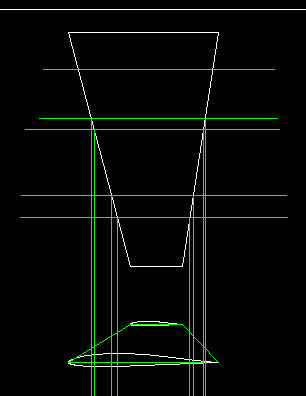

Chad, check out the autocad commands MEASURE and DIVIDE, and the related commands PDMODE and PDSIZE. Divide will divide a line (circle or arc) into any number of user specified segments, placing a point (PDMODE and PDSIZE) at each segment. MEASURE will place a point at whatever distance along a line (circle or arc) the user specifes, with no regard for "leftovers". i.e. - you tell it to measure along a line that is 10.5" by a distance of 1" - there will be a 0.5" piece "left over". Both commands are really handy if you want to put an object on another object a repetitive numver of times.

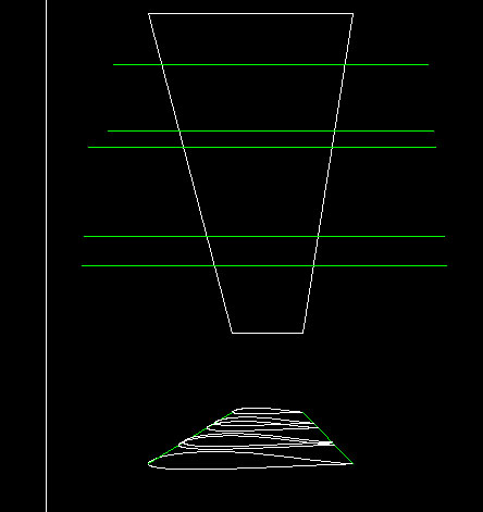

You can do something similar working from the top view. Using the top view you can place your ribs anywhere, and get accurate dimensions for them by bringing down construction lines. You may want to reposition a rib for a servo box or some such. You can see this in my first and second pictures. The rib center lines are drawn on the 'top' view, and then construction lines are brought down to scale the ribs onto.

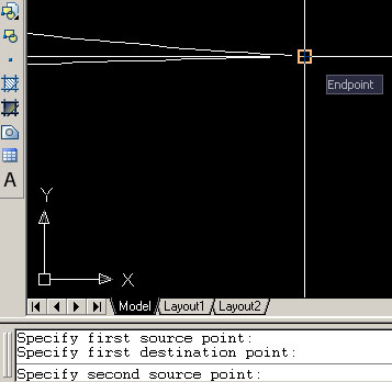

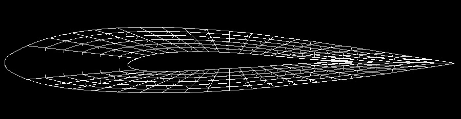

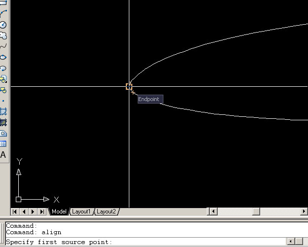

For the rib, I exported a mh43 from profili as dxf. Imported it into my drawing. Now I can use that template to make all of my ribs, without having to redraw anything. The align tool is great for this sort of work. It lets you move and scale a part of your drawing at the same time.
In picture 4 I have selected my airfoil, and started the align command.
In picture 5 I pick the first source point. I want the leading edge and the trailing edge to be aligned to the horizontal line I have drawn, so for my first source point I pick the very point on the leading edge of my airfoil.

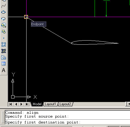

In picture 6 I pick the destination point. At the end of the command, align will move the source points to the destination points if it can. In this example, I want the destination to be a tthe very front of the horizontal line I have drawn.
In picture 7 it asks for another source point, so I pick the trailing edge.
Picture 8 wants another destination, so I pick the end of my line.

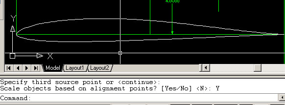

Now, it will ask for more source points. There is no need for more here, and I have rarely needed to use 3 or more. So just hit enter.
Then align will ask if you want to scale you objects. Hit yes here, this will scale your airfoil to touch both destination points. And now you have a prefectly scaled airfoil. Just repeat this process for the rest.
You can see, if you pick destination points that arn't horizontal, align will rotate your object so that your source points will go thru the destination points, or as best it can fit.
Hope I havn't stepped on anyones toes.

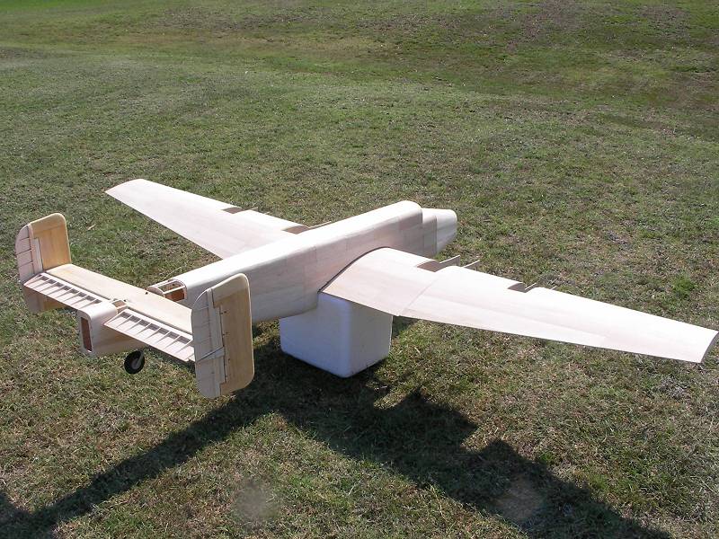

My Feedback: (102)
Chad,
Not trying to step on any toes here either. But I think If you really want a great and easy to use wing program. Compufoil is the best. I have been using it for years. I can draw most any wing in about 15 to 20 minutes. I even recently upgraded the program and it also will loft basic fuse formers the same way it does a wing. I Started a new project just over 33 days ago and drawing the wing was the easiest and the fuse took a little longer. I have built most of it already and just drew up the nacelle over the last couple days and now building them .
Anyone drawing there own designs Compufoil is well worth it.
You can even downlaod a trial version at:
http://www.compufoil.com/index.shtml

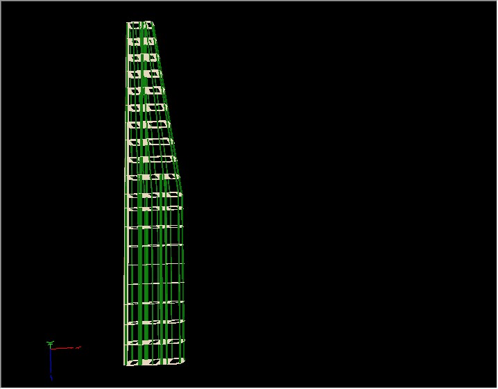

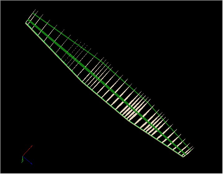

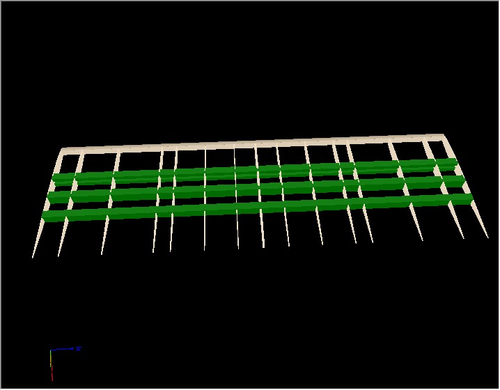

here are some pic's from the program and my project:
Ty
