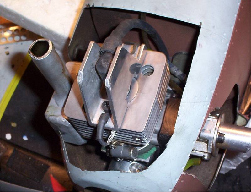

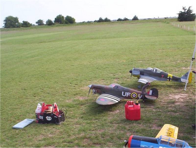

Should be enough. Got a Saito 150 in the CMP FW190 and it's just perfect. Not much better than scale really.
Same with my CMP Spitfire. GT25cc Brillelli. No unlimited vertical or insane power. Just a very solid scale feel without adding a brick to the nose for balance.

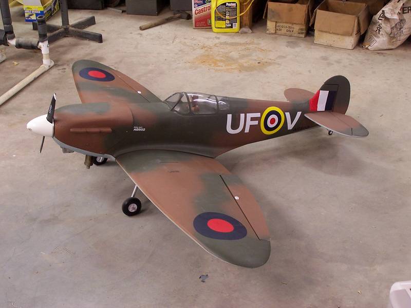

My 25cc Brillelli weighs around 3 lbs with muffler and electronic ignition. I didn't hack the cowl up as it looks. It's been the host of several engines including an OS91FX, SuperTigre G2300 and a OS160FX. The big 2stroke heads sticking out the side made for a huge velocity stack opening. LOL
I have another cowl for the Spit but just haven't gotten around to messing with it. It runs great and stays cool the way it is. These lower priced warbirds will never be Top Gun winners anyway.
Here's one of several threads on the plane.

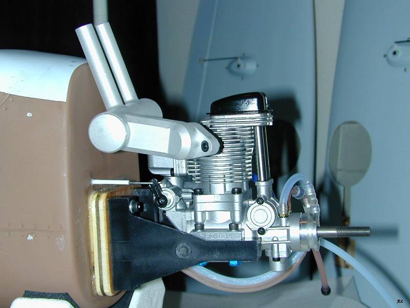

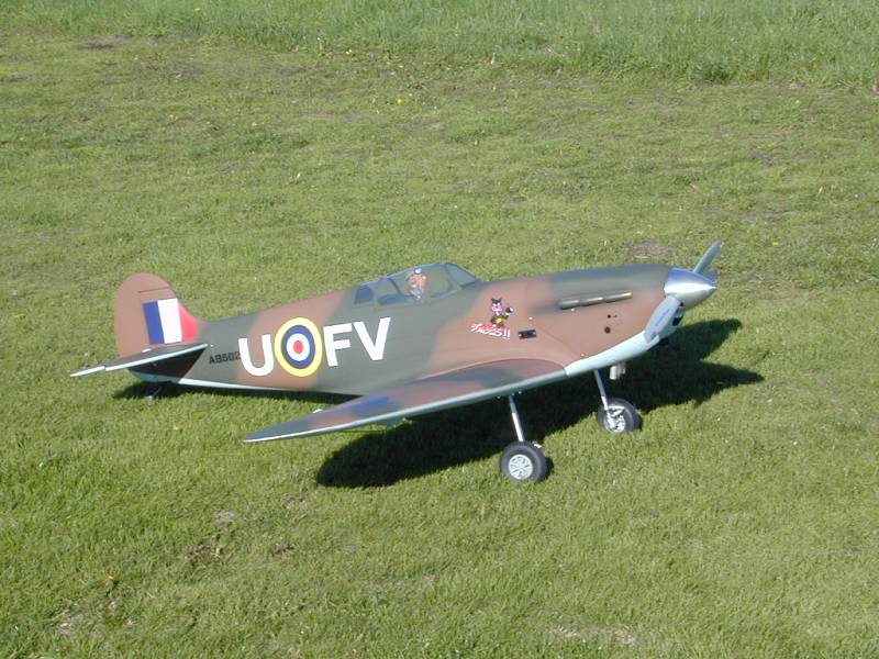

Had a supercharged YS 91FZ four stroke in mine, and it was a rocket: [link=http://www.warbirdobsession.com/cmp_spitfire/videos/show_pass.wmv]Show Pass @ Full Throttle[/link]
No butchering up the cowl:
