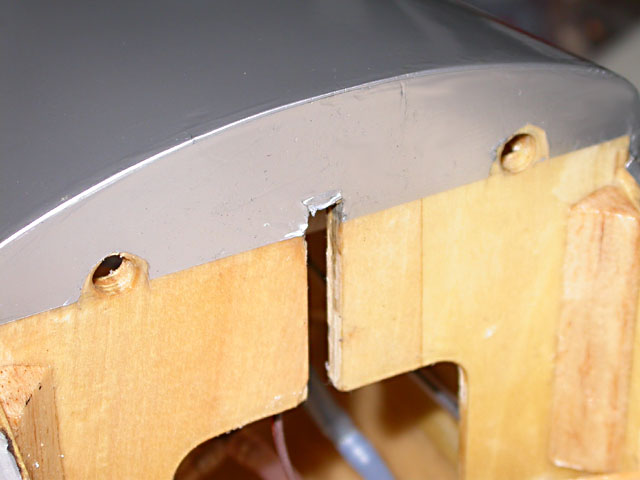

I built a chinese clone of the Hanger Nine 60 size p51. It flies very well but we are nagged with a need for a lot of down trim and nose over landings. I have an Idea that avoids carving the fuse to change the wing angle. the solution seems to be to trim away the fuse from zero forwarf to about 1/4 inch at the trailing edge. Lots of work. What do you guys think of this. I fasten a piece of aileron stock 1 1/4 inch wide from the end of the aileron to the fuse on the underside of the wing with the thin part sanded flush and the 1/4 inch thick side at the trailing edge. either that or make the elevators larger which would look bad. I have a super tigre 90 in it.

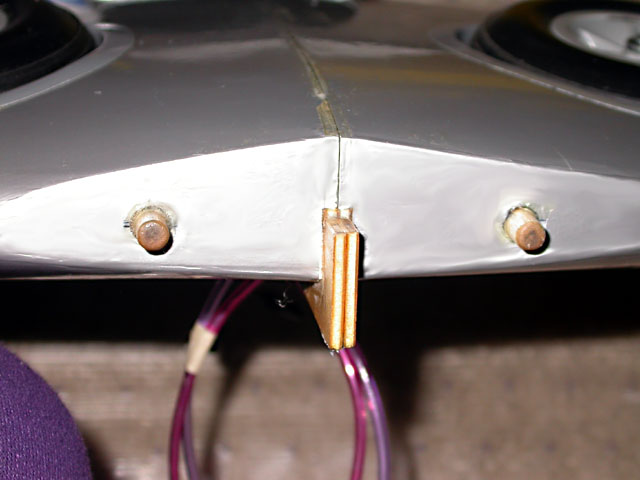

Old 10-18-2006 | 08:37 AM
Richard L.'s Avatar
My Feedback: (24)
Posts: 8,788
Received 4 Likes on 3 Posts
From: Renton, WA
Default RE: Down trim on a p51
You can do it either way. I installed wooden dowls at the front center section of the wing so the fuse would rest on those dowels instead of the top of the wing (I do this to most ARF's). You can see a slight gap between the fuse and the top of the wing in this picture:
The gap might have been 1/16" and not 1/32" as mentioned earlier.
At full throttle, note there is very little down elevator deflection:

Old 10-18-2006 | 08:42 AM
Joined: Jun 2006
Posts: 139
From: Palm Harbor, FL
Thank you very much. I will proceed with this solution. Much better than carving up the fuse to raise the trailing edge.
Old 10-21-2006 | 10:30 AM
Joined: Jun 2006
Posts: 139
I did a temporary shim and tack glued it to the wing to see if it was the correct amount. if all is well I will remove the shim and put a balsa buildup on the fuse and cover it so the wing will be down and the gap will be sealed.
