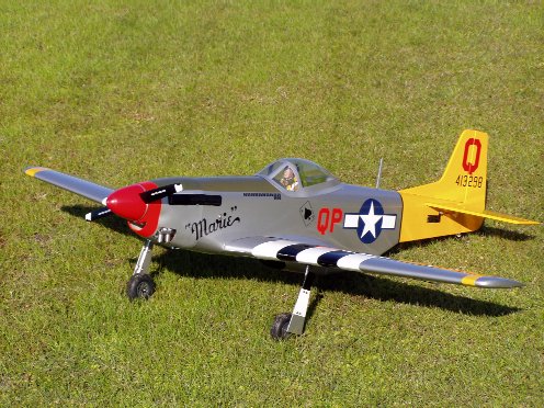

Old 01-18-2003 | 02:49 AM
mulligan's Avatar
Posts: 1,147
From: Sanford, FL
Default Hanger 9 P-51 Engine Setup
Slimline or J-Tec mufflers are cheap and work well- I have a J-Tec on mine.
- George
My setup is an OS 61 SF ABC w/ pump, inverted, with a J-Tec universal inverted muffler- nothing protrudes cowl except what you see here.
