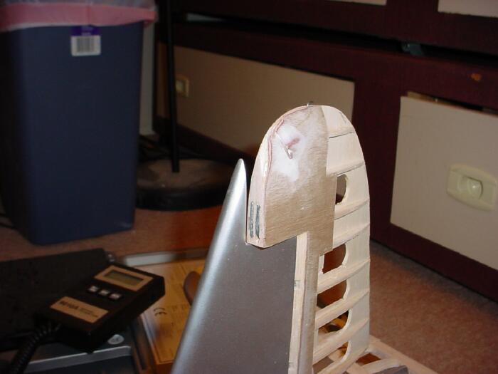

I "aquired" a scale acurate to .1oz, and weighed all the pieces (i'm priming and sanding now) and added up, came to 6lb 7.5 oz minus engine, reciever, battery, and paint (some primer included) so i think i'm doing pretty good.

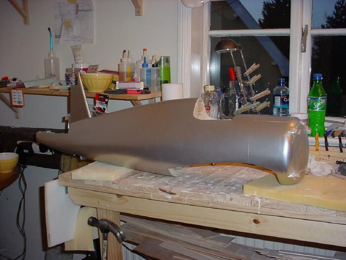

here she is, in all her shining glory (minus engine, cowl, and wings
i think another coat is nececary, but that's only under close inspeciton, so i'm gonna wait a few days for the paint to cure.

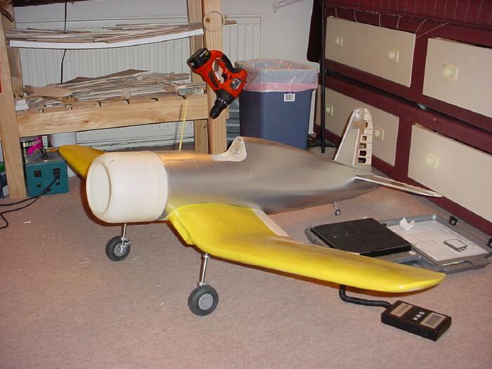

Here's how she sits right now, 6lbs, 12.6 oz
needs the underside of the wing sprayed silver, ailerons flaps and cowl primed and painted, rudder and elevator covered and painted, canopy made, and engine picked and installed, and other little things i can't think of right now.
I counterbalanced the rudder and elevator, since the pushrods are sooooo long, but do the ailerons need it on this size plane? i'm using seperate servos with about 2" pushrods

sure, i've gathered the info off of lots of threads and a few websites, so I'll just boil it down.
HOW- by inserting small bits of lead into the leading edge of the controll surface, or on an extension arm in front of the controll surface, this is easy on the tailfeathers of the corsair, because they're aerodynamicaly balanced, so the lead goes in the bit that sticks out in front of the hinge line. also lightening the back side of the surface means you need less lead, which means you need less lead in the nose. pic attached of the rudder
WHY- flutter. with long controll linkages, there's more chance of getting flutter from flex/slop in the linkag system. the best way i've heard flutter discribed is with a simple experiment. take a 1 foot ruler with holes in it (or make a stick with 2 holes) put a pencil in one of the holes near an end, to simulate the hinge line, and shake the pencil up and down (or side to side, depends on how you hold it) the ruler will twirl arround the pencil very quickly. now stick a bit of lead or whatever else on the short end to balance it, and shake again. won't spin will it?
the spinning is basically the same forces that cause flutter, but since there's a linkage the controll surface oscillates (flutters) and if it's fast and violent enough, it will rip the plane in half. quickly.
balancing the surfaces, even partially, will stop flutter, or at least reduce it engough that the linkages can cope with it.
that's the way I understand it, if I'm wrong, someone please let me know. (If i'm right a pat on the back would be nice, I just lost my daily flyer)

Yes, you could attach the surfaces, I actually just installed the hinge points into the surface and held them to the edge of my work -bench, saves all the on/offf.
I weighted the front end to balance, and she needs 2 lbs exactly right on the engine mount, so a big engine is a go!
