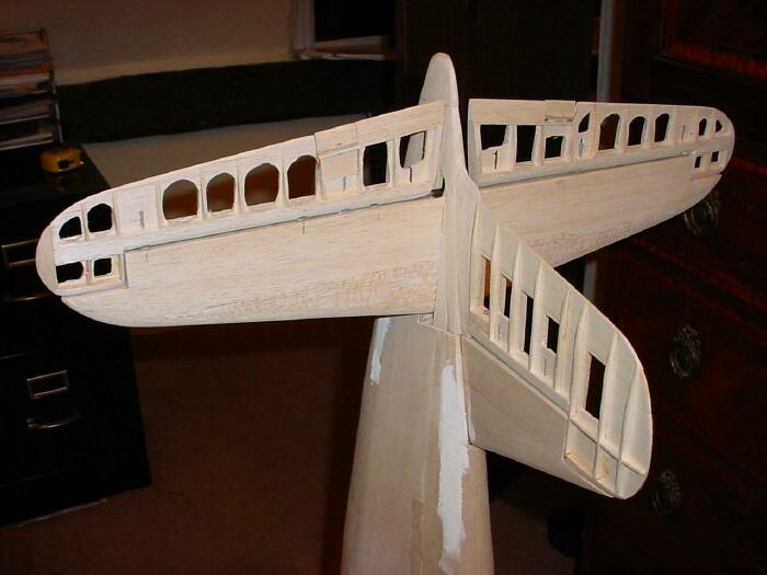

I built the tail feathes as per plans, and adde lightening holes to help compensate for the engine moving aft almost an inch. I also added 2 t-nuts along the centreline, to use small wing bolts to attach, making transport that much easier, and incidence alteration if necicary.

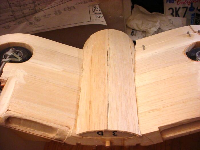

you can see the mistake I made with the turtledeck in this shot, I didn't shorten F-7 to make a smooth curve from canopy to tail, i just added on a chunk of balsa, and raised f-5 and moved it 3/4" aft. the question is, can i sand it smooth, or will I run out of block, and have to cut and re-build. any suggestions?

that took care of it, i decided that if I started sanding and ran out of block, i'd have to cut and replace anyway, so I broke out the razor plane, then started sanding, slowly. thank goodness for 3M "sandblaster" sandpaper, the stuff works like a dream, chews through balsa faster than my black lab, and leaves a perfect finish. I used a square of 100 grit glued to soft foam, and started with "short strokes" right on the high point, untill it was nice and smooth, and about 1/2" of dust on the work table.

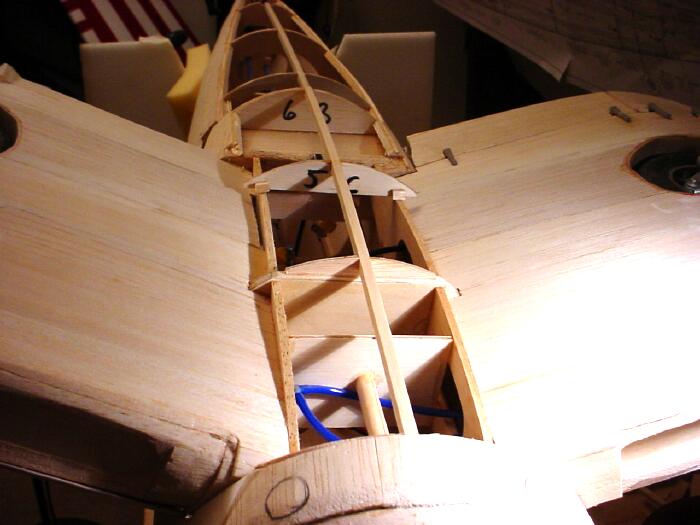

I've cleaned up the retract gear installation, secured the hoses and aileron servo leads. I already had the airlines set up with a T fitting to send one line up into the fuz, so I didn't have enogh line to plug both into the valve, so I ran one line from the valve to the T, and plugged the other valve outlet with a short chunk of line stuffed with a piece of pushrod scrap. the fill line is capped the same way with a qucik connect, the other end attached to my air pump. bend the line over twice, disconnect the pump and put on the cap, saves the weight of the heavy fill valve CJ supplies. I once heard on here somewhere, "mind the grams, and the ounces take care of themselves"
I also re-made my flap servo hatches, the odd sizes started to bug me really bad.
this shot also shows a little trick I can't remember where I learned. drill a hole in the top of your workbench the size of your wing dowel hole, set the wing dowel into it and you have a third hand to hold your wing, great for seting up retracts and wing controlls.
I've heard of running dual recievers to split the plane left and right for reliability, what about putting a reciever in the wing, then no fiddling with servo extensions, jsut bolt the wing on, 2 switches and go. this would add some reliability too, as the plane might be flyable with just aileron and flaps (some pitch controll) and is almost definaltely flyable with just rudder throttle and elevator. I'm not much of a pilot yet, what do you guys think about this setup?

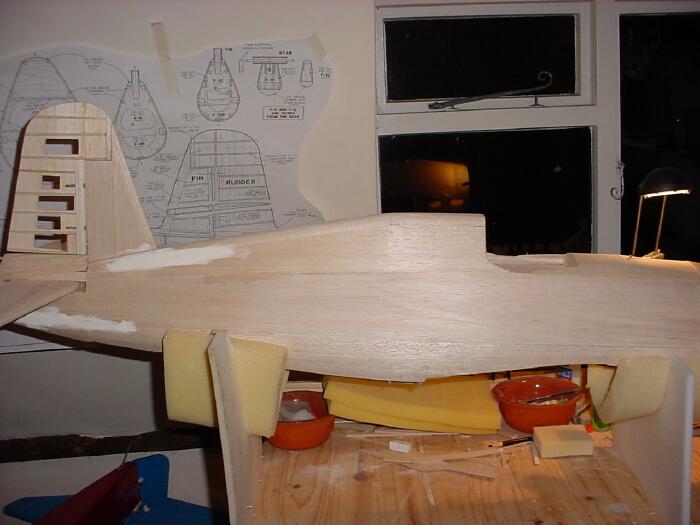

here's a few shots put together, although i'm still waiting for my tailwheel to arive to finish the botom of the fuz.

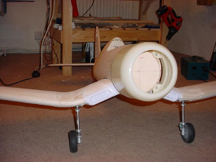

here you can see how i tapered the fuz to vent the cowl like the full size, and above you can see the secton of the wing i left open untill i fit and adjust the flap servos and hidden linkages
imagine seeing that coming at you with 2 .50's and 2 .30's blazing! (well, imagine it finished)

I'm planning on shortening the nose on mine to make it look more accurate. It seems to have a bit too long a nose. also relieving the area behind the cowl for airflow is a fantastic Idea. Good luck Shupack, I can't wait to see the finished product.

I am also using the RCV 90 and I was worried about the airflow. I rounded the circumference of the firewall and cut and opened up the cowl base to make cowl flaps. As you can see form the pictures, I have no more worries about outlet area. I calculate over 7 square inches of outlet area.
