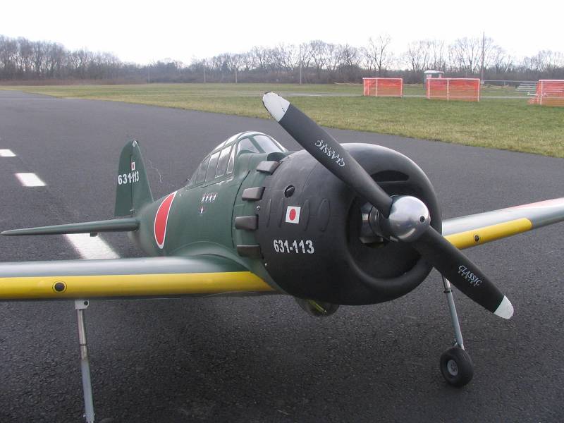

This is a Great Planes spinner http://www3.towerhobbies.com/cgi-bin...?&I=LXGDA9&P=7 That I used. Its cheap and although not scale it has the look of the era.

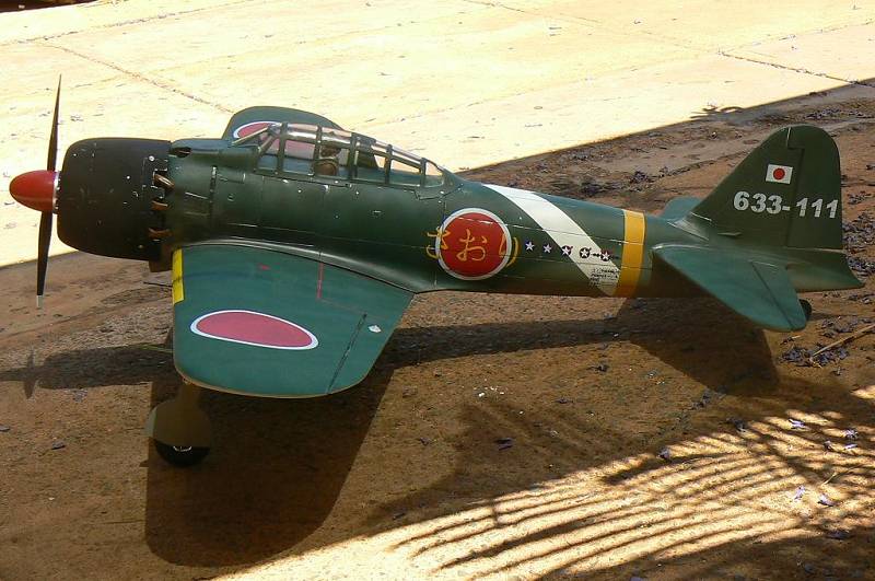

Default RE: CMP giant scale Zero build

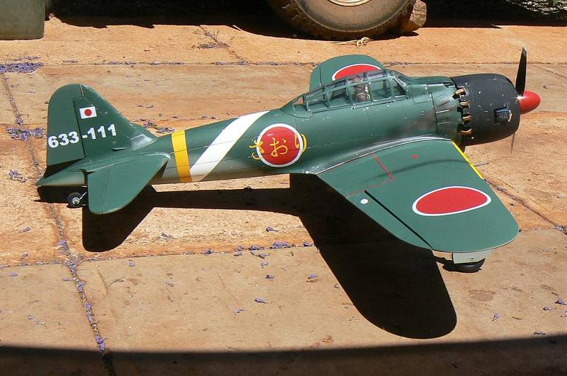

These guys do world models Zero spinners up to 89mm very good service & quick postage.
I used a 57mm on my 50 sized CMP Zero and it looked perfect.
Steffan.
http://homepage1.nifty.com/ishiimoke...??ZERO_SPINNER

Doing the calculations between the 53.5'' 50size Zero & the 82'' Zero the 89mm spinner they do would be the same relative size as the 57mm is on the 53'' Zero.
If you divide the 2100mm wingpan by the 1360mm wingspan you get 1.5....
If you divide the 89mm spinner by the 57mm spinner you get 1.5....
I'm definately no einstien but I think it works out ?.
Therefore if you got the 89mm it would look the same for the relative size as mine.
Sh#t hope that makes sense better go before I get my self in any deeper.

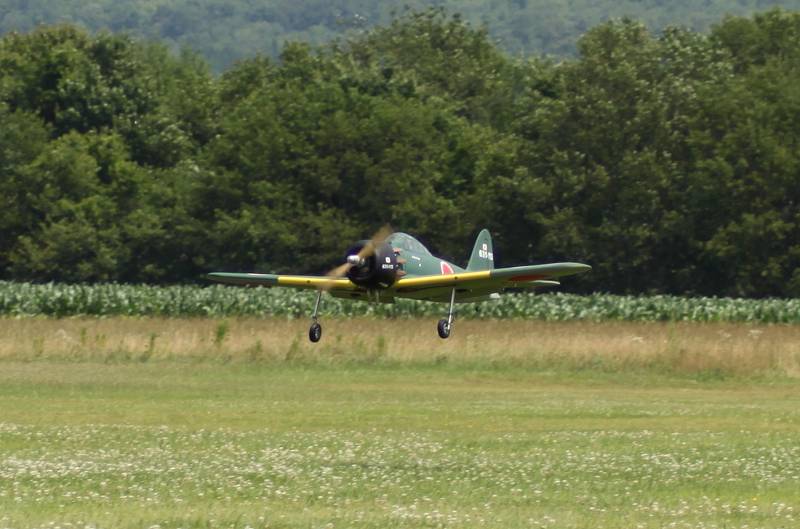

flew mine today, it was windy so it was hard to get a good idea on the speed of this one but i felt it was slow.
My first takeoff role out the right strut came loose so after tightening them up. The role out was smooth and it lifted off quickly. During the climb out and first turn I had to hold down E. once that was trimmed out it needed 2clicks of right aileron. Did some diving and climbing at 60% T with no surprises. I flew it a 5pm and as with all dark camo planes it was silhouette on the sun side. I did a roll to both sides with the gear still down and it was pretty average. Should quicken up when the gear are retracted. I put the flaps down with half T and it started to climb. I reduced the T until it leveled off, I opted to not go any further to keep it flying right to the runway. I came out of my down wind turn at 200+ ft and dove steeply for the runway (45-60 degrees) pulling out into a shallow dive at twenty feet and reducing the T to a few clicks above idle. Once I leveled just above the runway reduced to idle and held it of with the E as it settled in very gently.

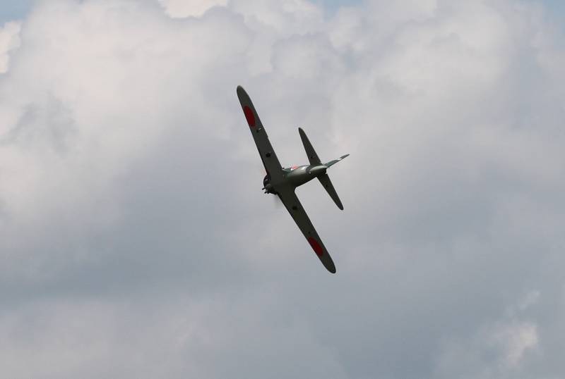

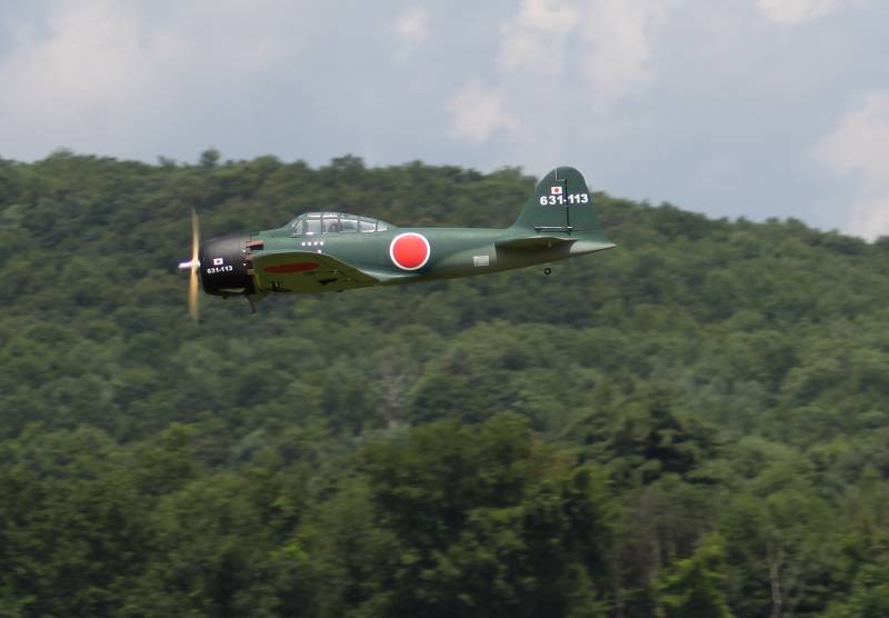

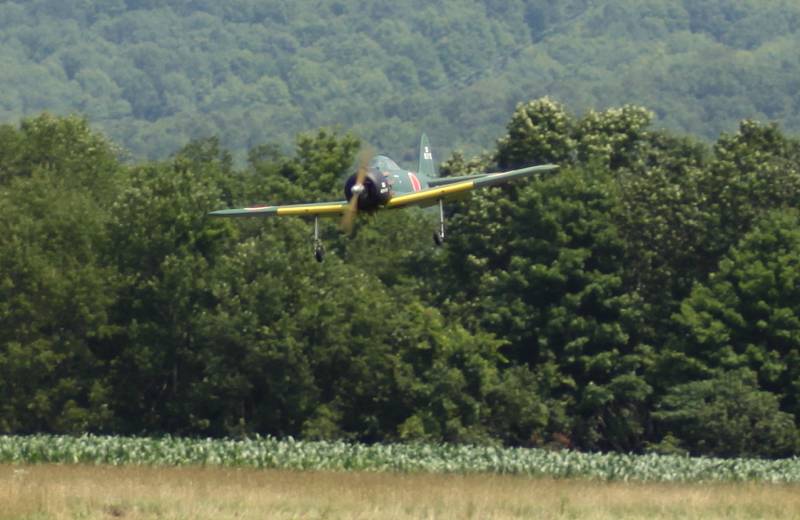

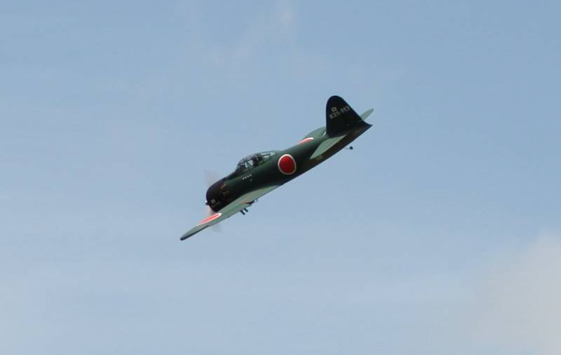

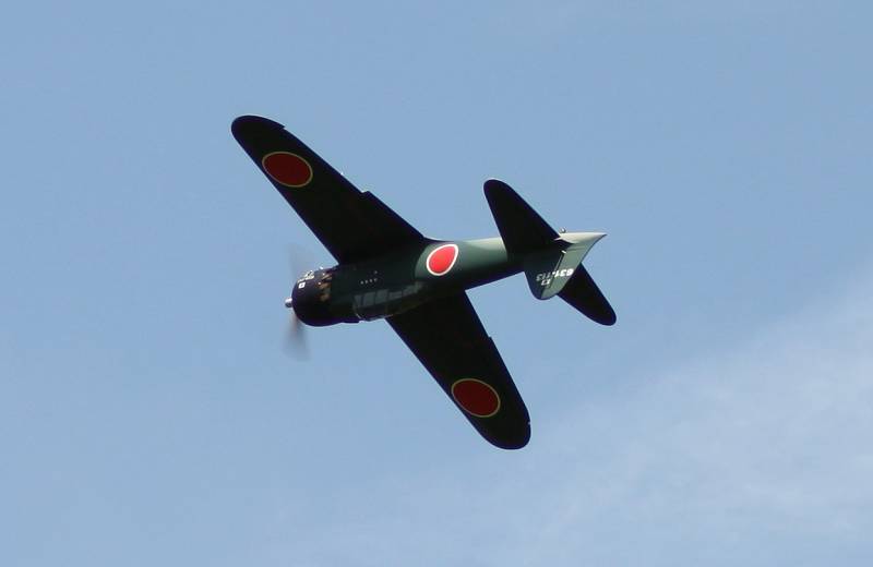

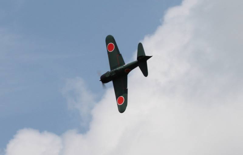

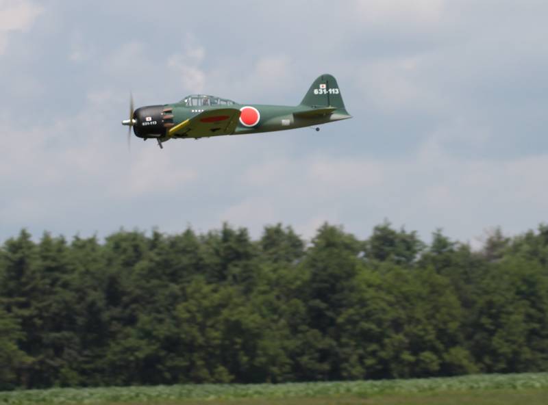

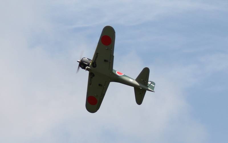

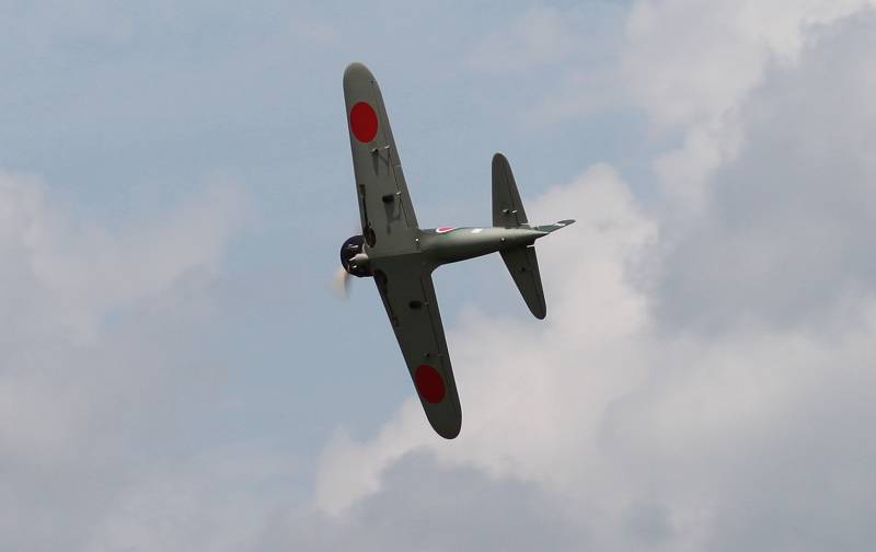

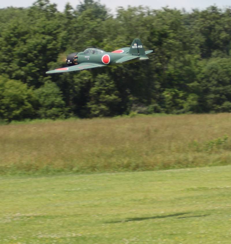

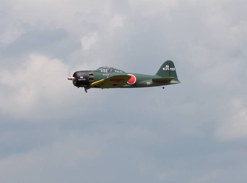

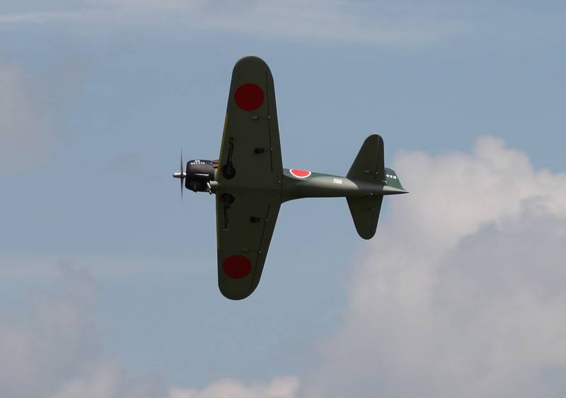

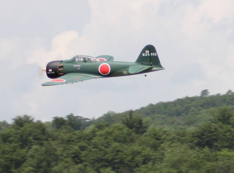

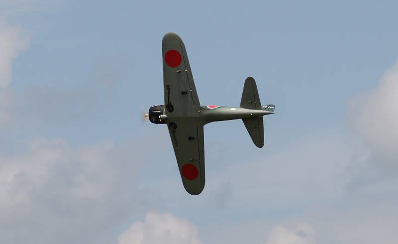

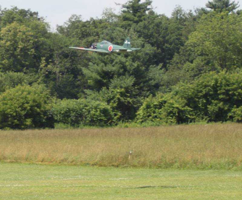

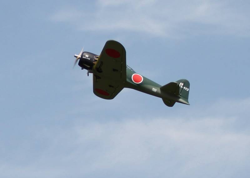

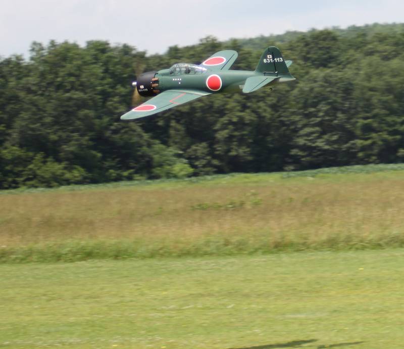

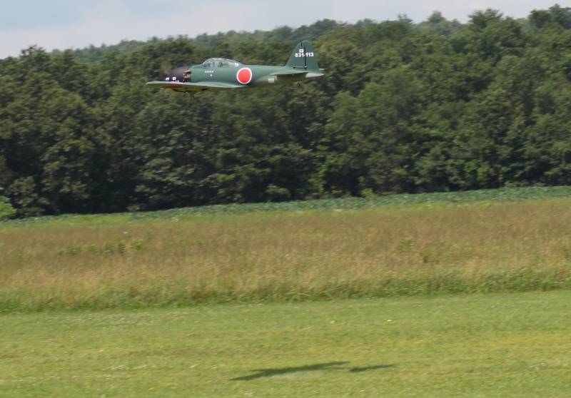

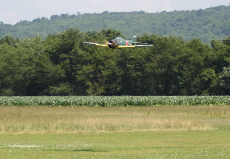

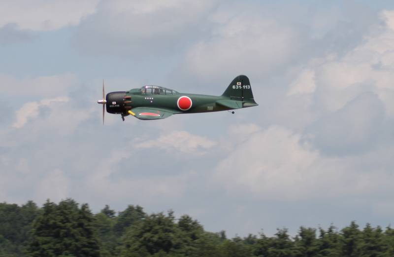

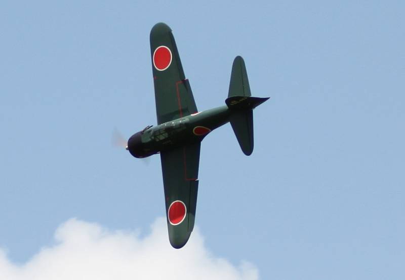

flew mine today. I have been leaning the engine each time in the air and we are getting close. my list of winter changes is growing.
- i have the E and R servos in the tail. plan to move the E forward fo remove some of the nose wt.
- the factory hinges are mounted in the center of the wing. the hinges need to be moved to the bottom surface to allow more flap movement. with the pressent movement the nose comes up and i have to hold down E. i need more Flap movement to bring that nose back down.
some pictures from today 24jul09, thanks john.

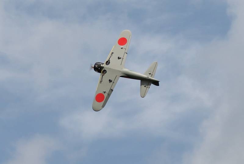

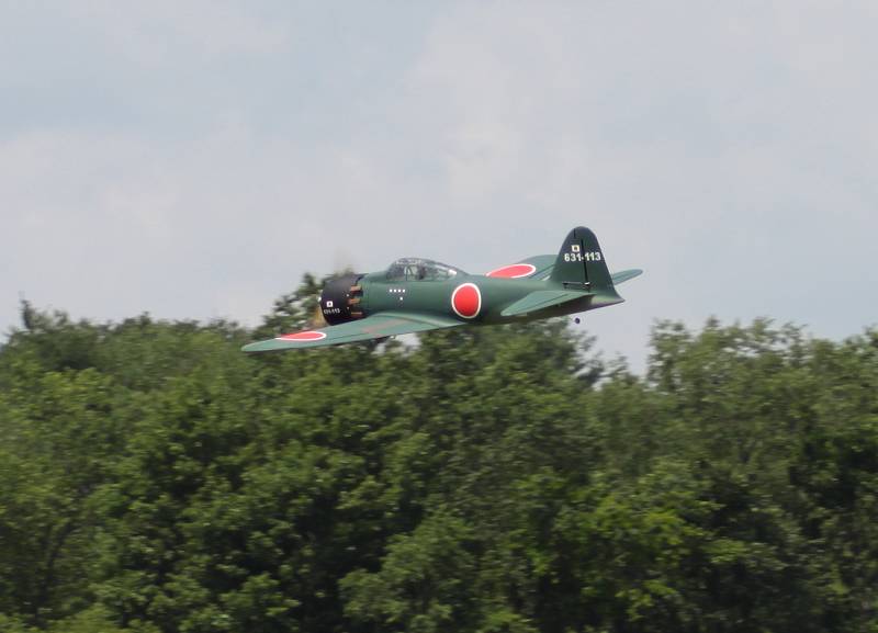

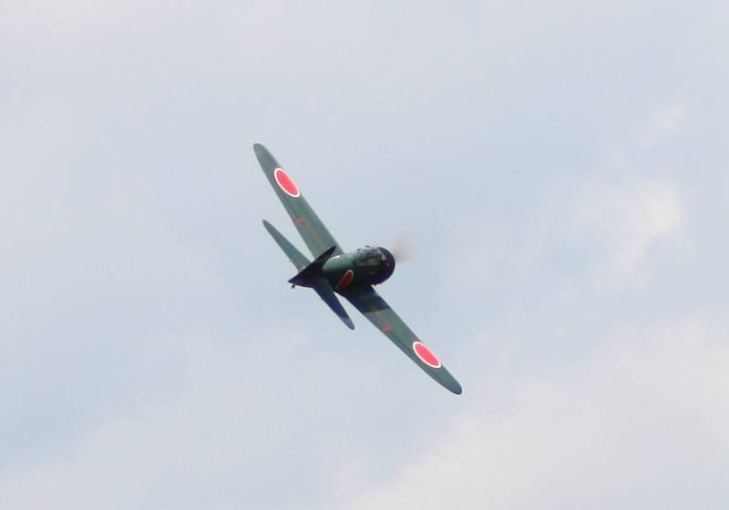

24jul09
