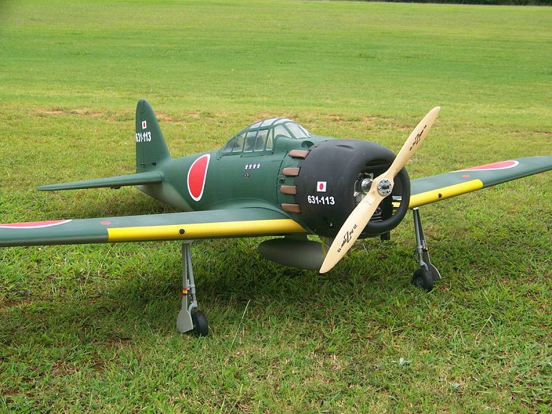

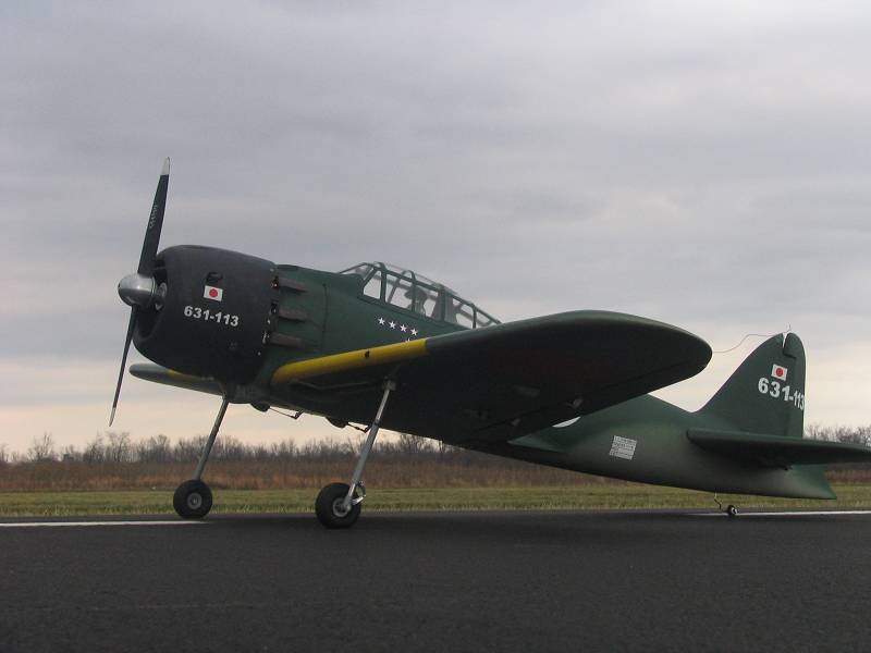

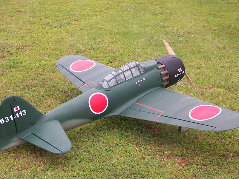

Just though i would show some pics of plane

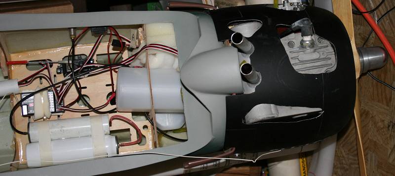

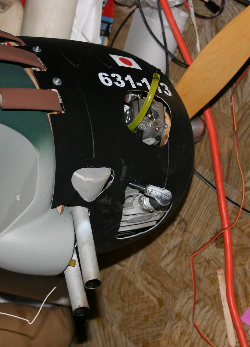

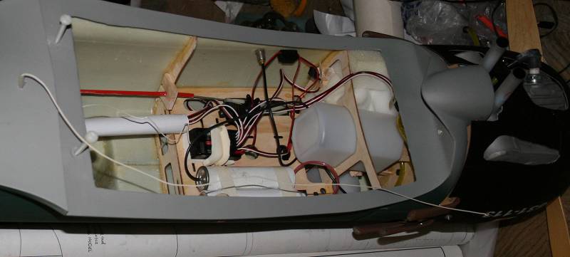

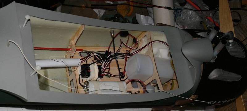

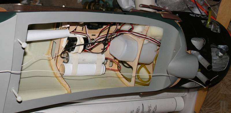

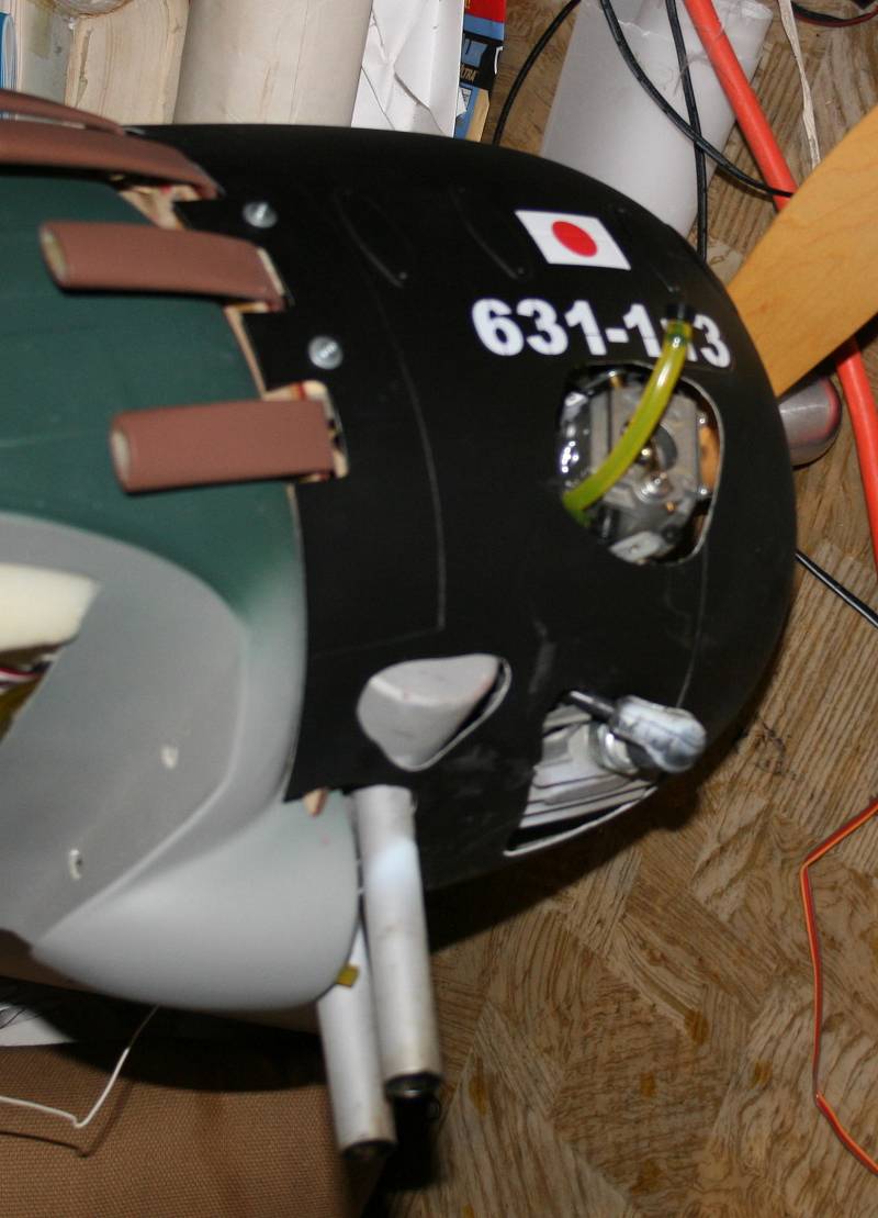

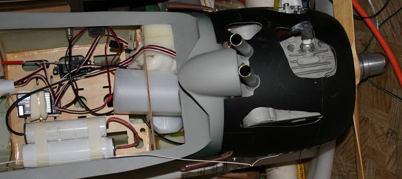

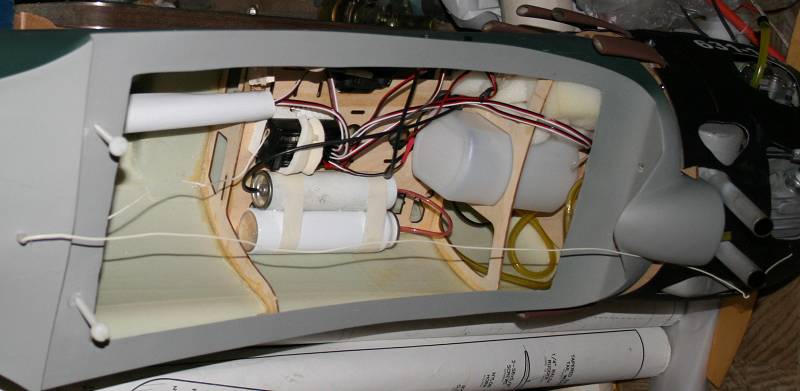

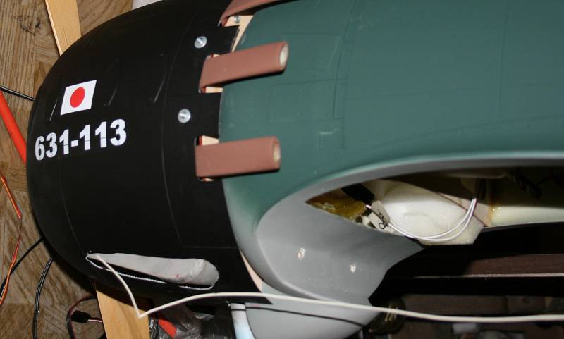

some pic's of the radio/air tank install, and the engine/cowl cutouts.
Joe

The air system in the fuse contains the filler valve to the air tanks and the quick disconnect for the wing. I buy most of my airtanks at flee markets that’s why two small rather than one medium tank. I used to put the air and filler all in the wing but as time goes on finding and replacing the leaky lines is much easier with things spread out.
Joe
