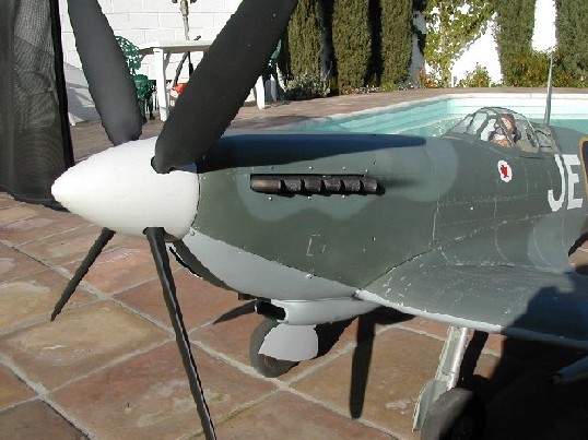

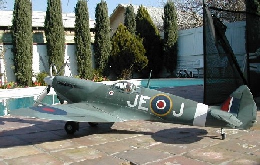

Build from a Brian Taylor plans, glass fuse and lasercut wing, powered with a 3w50; entire engine fits in the cowl but the spark plug cap sticks out about 1/4". The last two exhaust stacks are functional.

Here is another

Old 02-25-2003 | 05:40 PM
Joined: Feb 2003
Posts: 108
From: Venray, NETHERLANDS
Default Spitfire
What a beaty!!!
How did you make it look so old...? (Panel lines etc...?)

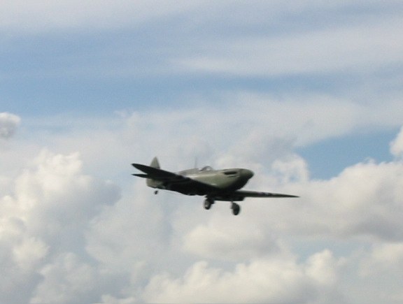

Rudje:
I also recommend Brian Taylor 1/5.3 design. If you really like Spitfires, Taylor's is probably the most accurate. Mine flyes great with a Moki 1.8 and lands like a *****cat.
G62 is not for this airplane.
JG

Default BT Spit
Here is a photo of Taylor's Mk XIX returning from a mission.
JG

Old 02-25-2003 | 11:39 PM
My Feedback: (37)
Posts: 1,418
From: Burbank, CA,
Default Weathering
I originally painted the model with silver aluminum paint and it appears as you run steel wool over the top camo paint.
The pictures are terrible, I cannot shrink the picture size witout it looking like 'lazily applied' markings.
If you check my website it has better pictures.

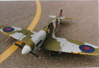

Hey guys, great scale stuff.
The original pictures indeed look like lazy painting.
Here is my previous smaller version
