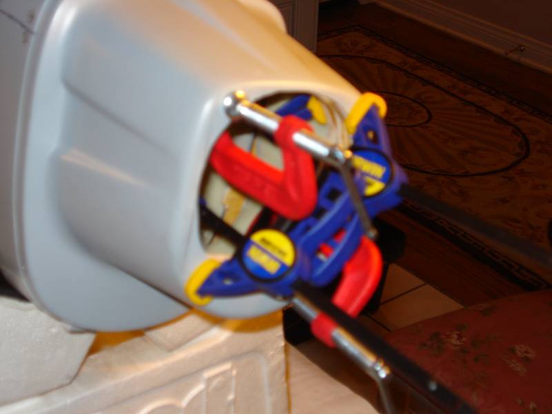

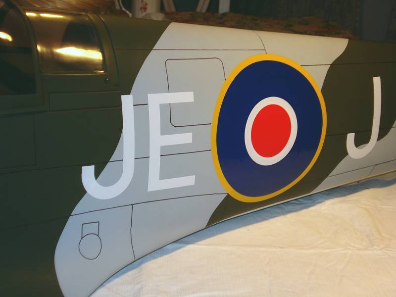

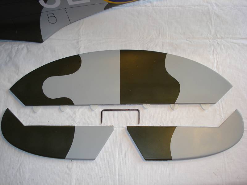

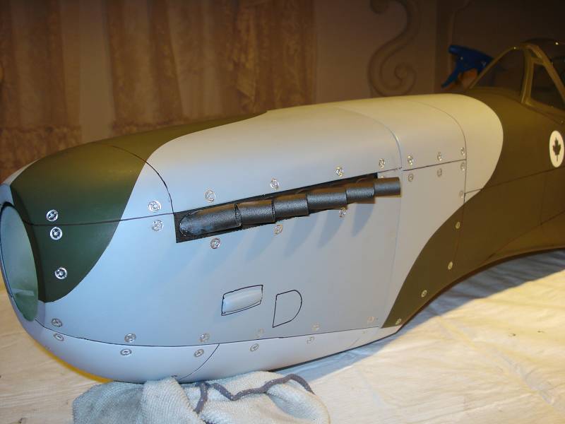

Hi there, started to work on the fuse and am outlining the indents with both black and silver Sharpie pens. Will spray everything with a couple of coats of Top Flight "flat clear" to preserve the ink when I'm done.

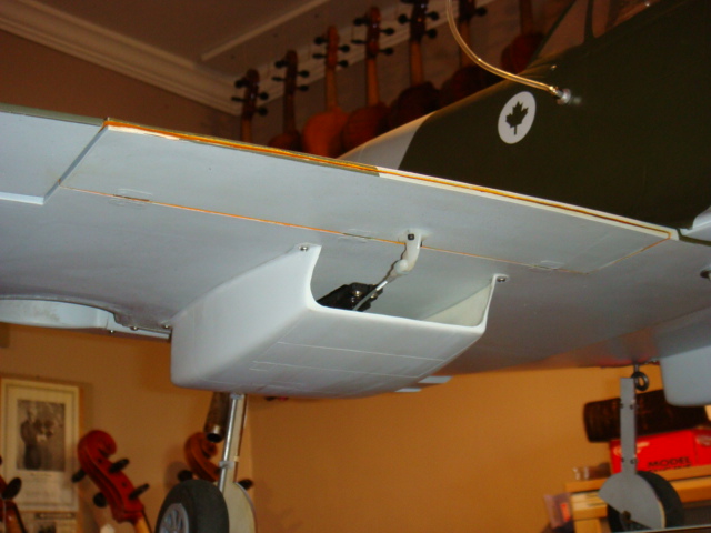

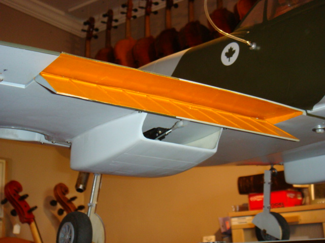

ORIGINAL: ghostrider168
I just got one...nice ARF...only thing missing is the flaps. Has anyone try to install flaps on this plane?

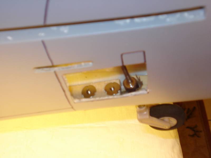

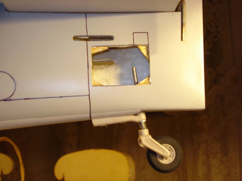

I agree with you that the only thing missing is the flaps, so here it is; it's really not that difficult to splice the trailing edge and retrofit. Upon landing, with half flaps deployed, the tail wheel just doesn't want to come down until the plane slows down to 0.5 mph : )
By the way, this plane flys as straight as an arrow with little to no trim dialed in, just the right amount of right and down thrust from the factory firewall set up, great job Cermark, thanks Steve!

Great Job, Barry on those flaps. I have the split flaps on my KMP Hurricane and sometimes I use them and sometimes I don't depending on the head wind when lending. I also had a 60 size World Model Spitfire with flaps and used them all the time. On both of my planes with flaps, I noticed that as soon as the wheels touched down, I would reset the flaps to neutral and the tale would set right down....as long as the flaps are deployed(down) they would put pressure on the plane to lift...but once they are down on touch-down the tail settles real nice and the plane slows down normally. I really like the job you did in modifying the trailing edge on the Cermark Spit. I am tempted to do the same, but I have never done that kind of modification. It looks difficult!

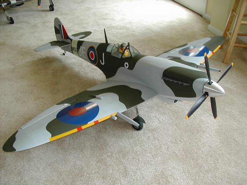

Here is mine.

Hey Freddie, I really like your Spit. Another pilot had the Cermark Spit at my flying field the other day with 1 flight one it. He was really nervous so I told him I would spot for him. When we went out to the runway, he handed my the transmitter and told me to fly'er up. I was a little surprised since he didn't know me. Anyway I slowly throttled up with wheels tracking the center line and at about half throttle and 30 feet, it started to life off real scale-like. He had an Evolution 26 or something like that type of gasser. The plane flew beautiful. I handed him the transmitter and he flew it around the patch for about 5 minutes and then handed it back to me to land! Another surprise! I set it up and brought it right down with a little power and she settled very smoothly on the mains and stayed steady as the tale dropped. I can't wait to finish mine.
By the way.....Where did you get your spinners? I notied a three blade plastic and a 4 blade aluminium! I have been using a 2 blade on my Hawker Hurricane by KMP, but would like to try a 3 blade for flight and realism.

Hi Barry,
Thanks for the photos on the flaps. It is exactly what I was looking for. My question is: how did you splice the tailing edge with such precision? Were there any special tools you used to accomplish this task?
Gary
Hi Barry,
Gary
Hi Gary:
Cut outline with Xacto and then split the glue joint from the trailing edge with a sharpened palette knive, the seams will open right up, including those to the ribs. then, of course build new trailing edges to accomodate flap hinges, I used nylon. It is much easier than you think, best of luck.
Barry

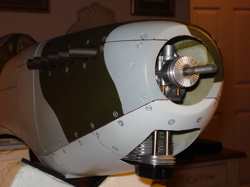

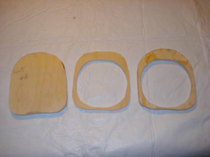

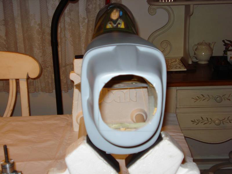

Hi there, I am finally getting some traction on assembling the Spitfire. I had to refabricate the firewall due to the that fact that I use a Hyde Soft Mount and the initial fitting showed a gap between the spinner backplant and front of cowling of about ¾ inch. So I had to cut a whole in the original fire wall and install spacing and new rear wall to accomodate the soft mount. Now my spacing is pretty accurate. I am also working on installing a scale tail wheel assembled from several Dubro tail wheel kits.
Arnold

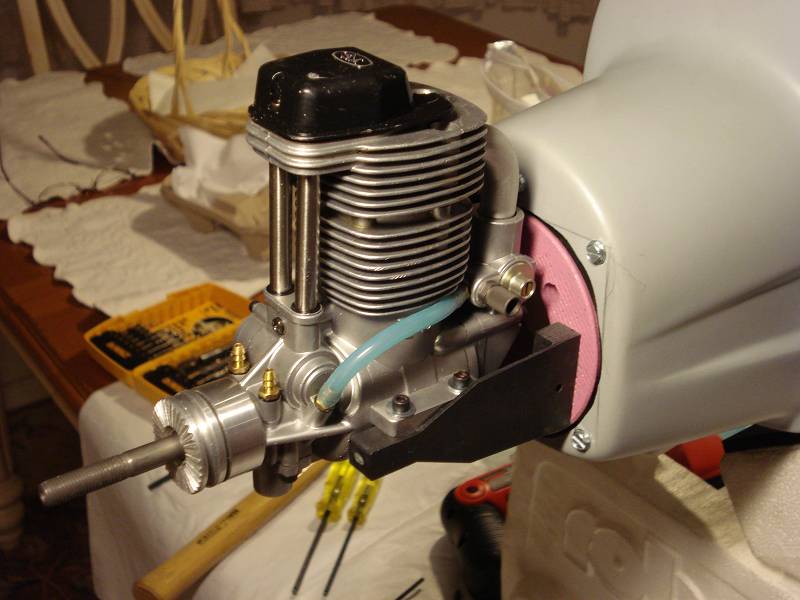

Hi there, finally got the motor mount installed on the new firewall and motor on the beams. With the cowling on, the front of the spacing washer on the crank just pushes forward of the cowling and looks like it came out in the center pretty good. Now I am all about fabricating and installing and somewhat scale-like tail wheel.
Arnold
