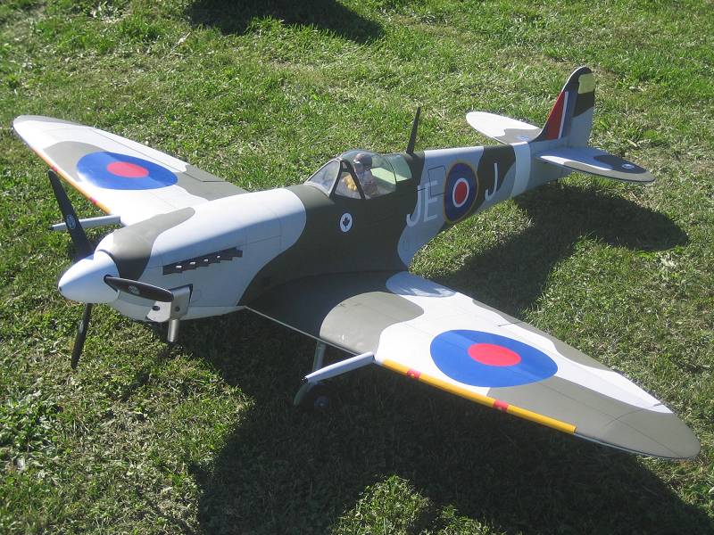

I bought one of these from someone, but I don't have the instructions:
What are the recommended throws for the elevator aileron 7 rudder ?
[8D]
Thanks!
Sean

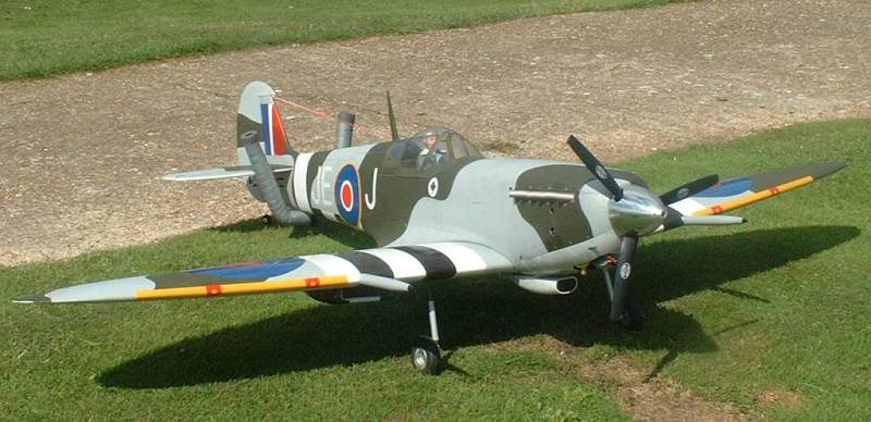

Set up information for Spitfire (Cermark/Topgun)
CG position is 4" from the leading edge.
Ailerons 3/4" up & down
Elevator 1" up & down
Ruder 1 1/2" each way
This is as they say in the instructions as a general guide.
http://www.rcuniverse.com/forum/m_53...tm.htm#5389792
Old 01-15-2008 | 11:22 AM
  #80
My Feedback: (131)
Joined: Jun 2004
Posts: 1,605
From: Dallas TX
Default RE: Cermark Spitfire
What prop and engine do you have on yours?
She's great looking with the invasion stripes...What paint did you use ?
P.S. thanks for the info!!
Old 01-15-2008 | 12:51 PM
  #81
Joined: Aug 2005
Posts: 125
From: New Romney, UNITED KINGDOM

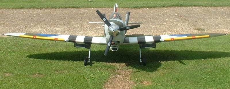

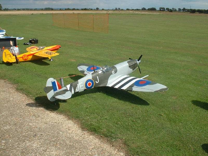

Specs:
Futaba radio gear
Laser 100
14/8 three blade prop
Uni-tract Air up & spring down retracts
As to the engine positioning I found and marked the Horizontal & Vertical line and then the engine mount six millimeters to the left giving me the correct amount of side thrust.
The paint was Flair or Spectrum http://www.flairmodels.co.uk/Finishing/Spectrum.htm

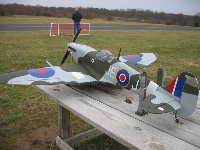

OPkay, I finaly got mine in the air, with the SPE 26 and a 18x6 prop...It flies like a dog, lumbering around, in a high Alpha attitude. I keep thinking she's gonna stall out on me.
Both times the engine ended up quitting on me and I've dead-stiched her safely back, but I can't imagine it's th eplane... It must be the engine.
I can't figure it out?
I started out w/ a 15x 7 3 bladed prop, and it was a slug so i changed her tio the 2, but I still am not getting the love I want.
CG is correct, but it flies like a .60 is pulling it around.
Anyone else w/ and SPE 26 on board ?
What is anyone turning RPM wise ?

I'm switching props to the SPE recommended 18x10, to see what will happen.
I'm still hoping to hear from anyone with experience using this engine [8D]

No way a 18-10 is too much prop for a 26. Try a 16-8 apc. I have one on mine with a g26 and it turns it 9200 rpm. Mine flies great. I like the way it flies so much I upgraded the retracts with robarts and struts and 3.5 robart wheels. Just try a 16-8 apc and you can compare the rpm and if it anywhere close it should fly great.
Good Luck
Nelson

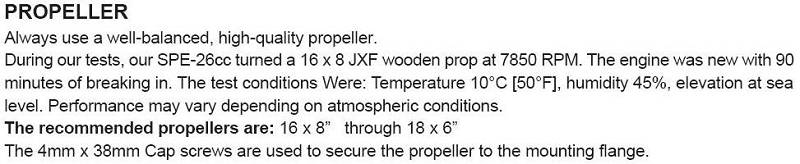

Sorry to here your plane is not quite right but I found this for you, I hope it helps.

Flew the Cermark Spitfire yesterday with a 16x10, and it was the perfect combo for the factory SPE 26 !
