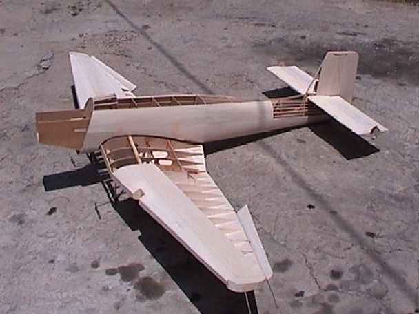

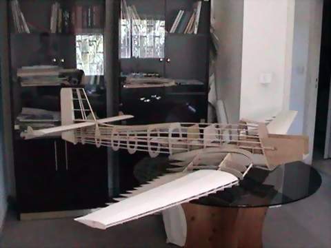

This is my Ziroli 100" Stuka
totally scratch built!

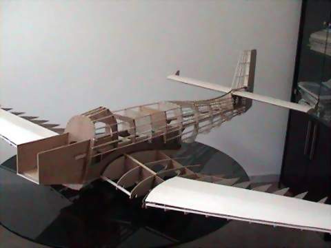

Default Ju 87B
another shot

It looks great! How long did it take to get to this point? I've heard that Ziroli Stukas are great flyers. Check out pahtreek's gallery. His Stuka looks absolutely real, and also, rcwarbirds.com has some nice pictures of others.

Curious on a ziroli build, all the kits I have built so far have flat bottom ribs or jig tabs on them, how do you build them and keep the correct position?
Just curious if you need some custom wing jig tool or not.

Old Mill
The wing plans of my Stuka has a false line
on which you pin a 1/4" sq. strip under the ribs
in order that you get the right washout at the tip!
Rgrds
Hisham

The Ziroli planes I've built use long strips of wood under the TEs of the wing when building. There are specific positions on the plan where the strips go to insure correct washout.

Mill Check out this link http://home.mchsi.com/~jahuntley/hurricane/hur6.html it is the wing for my Hurricane. It is a Vailley but built the same way as the Ziroli. You Will notice the trailing edge jig and and down the page there is a closeup where you can see I use 1/4 square or 3/8 square sticks to sandwhich the rib snugly which keeps the ribs verticle and also helps keep the TE in place. I do this for every plane I build whether it has tabs on the ribs or not. it always makes a nice wing panel.

As for lining the jig up in the rear most plans say where the washout jig goes. 95% of the time it goes under the rear spar but on this one I had to make my own jig and I made it just in front of the rear spar due to some ribs being shorter than the other ribs and wanted to make sure they lined up with the rest.

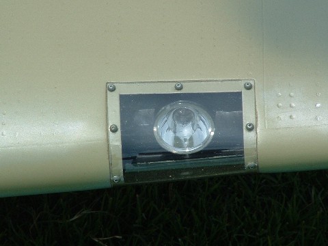

what can one use for the wing light??

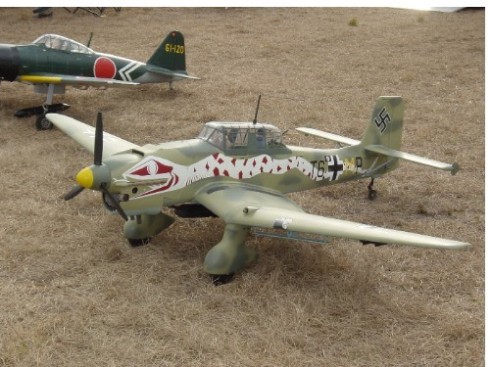

Default Stuka Light

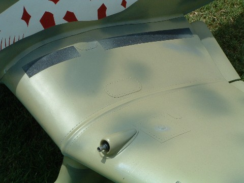

Looks like you are doing a great job on the stuka.I used a flashlight assembly on mine.You need to fit the light in between
the leading edge of the ribs.then make the lens from clear thin plastic.If you attach a micro switch to the flap servo it will turn on when you land. GOOD LUCK -SNAKE STUKA

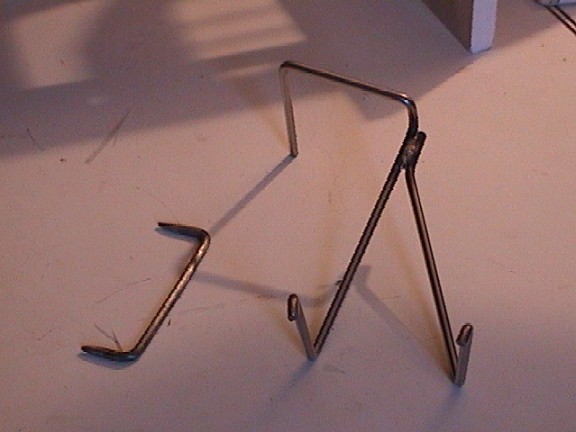

Default landing gear

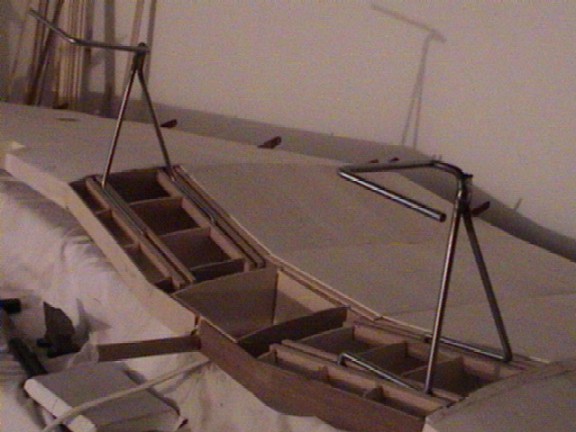

Home made landing gears ....
Check them out!

NICE JOB ON THOSE GEAR. ITS THE SPATZ THAT KILL ME. I'M GOING ON MY THIRD SET NOW. AT LEAST NICK IS MAKING THEM OUT OF ONE PIECE FIBERGLASS NOW. THOSE TWO HALF ABS SPATZ WERE A REAL NIGHMARE. A BMW STATION WAGON OUGHT TO FIT THE STUKA WING NO PROBLEM. DOES THE FRONT PASSANGER SEAT FOLD DOWN?

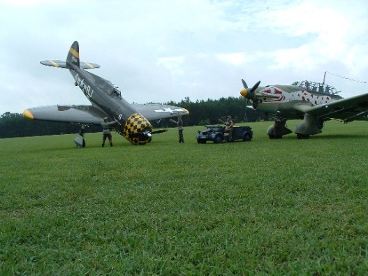

Default STUKA
Keep up the good work.Check out the stuka pic.

SNAKE STUKA
Thanks for all the info.. as usual!
Could you post some closeups for your plane!
Regards
Hisham

Default Stuka Light
Great job on your stuka.Here is a picture of the landing light .Make sure you run your wires before you sheeth the top of the wing.Good Luck The SNAKE
