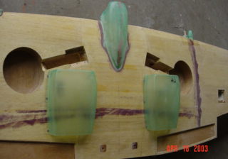

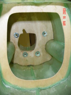

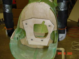

Hello gentlemen, Just thought I'd share some pics of the Spitfire's progress. Certainly not an original idea for a thread, but pictures of classic warbirds are always fun to look at. Here goes:
The next two pictures are of the new firewall I installed to accommodate the 3W-70 I'm stuffing in there. The second shot is from the inside of the fuse looking forward.

Old 05-25-2003 | 08:34 PM
MarkShapiro's Avatar
My Feedback: (52)
Posts: 1,026
From: Miami, FL
Default Y/A Spitfire Building Progress

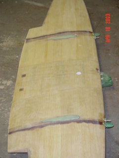

Wing top/surfboard

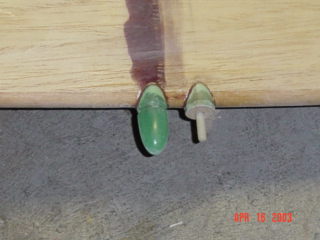

Close up of gun mount

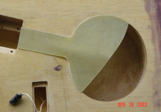

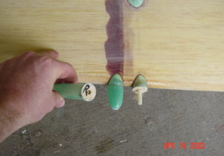

mounted canon.
and another. The brown stuff ont he wings is micro baloons.
wing bottoms

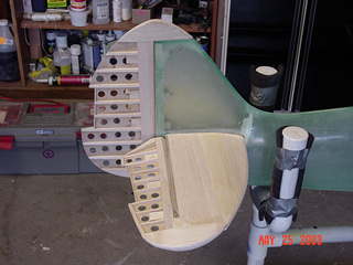

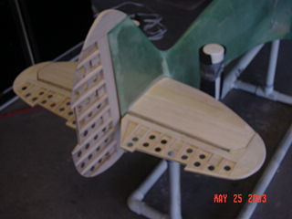

Tail feathers. Notice the balsa horizontal stab. Drew my own plans with help from Chad Veich. He sent me a set of Brian Taylor plans that were a good platform to work from. A little too small however, so I drew my own. Came out great and tons lighter than the fiberlass unit that came with the kit.

Another view. I decided to cut out trim tabs. Should add a nice scale touch.

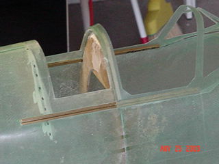

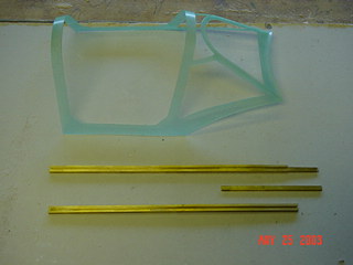

Working on the sliding canopy. I looked to Dynamic Balsa for their canopy rails. Holy Crap!!!! Pretty expensive for what you get!!! I made my own rails including the slider that goes inside. I may be selling duplicate sets of these on RCU if there is an interest.
Old 05-25-2003 | 08:53 PM
My Feedback: (52)
Posts: 1,026
From: Miami, FL
These are the rails off of the Spit. That's all for now guys. More to come in the days ahead.

Jakob, In order to fit it in, I had to tear out the stock firewall and build a new one. Then I had to set the new one beck into the fuse about 1 inch. It is a tight fit, but it fits in great. The only thing you can see with the cowl on is the top of the cylinder head. A very nice clean fit, if I do say so myself. Teh muffler will be custom built and exit through the scale exhaust stacks. Again, an Even Quiros creation. I will put everything back in place and snap off a few shots. Stand by for those.

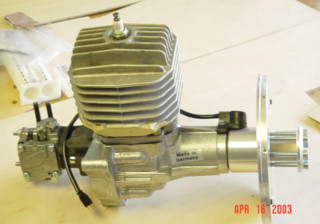

Jakob, here's how the 3W-70 fits into the fuse:

looks great. Didn't think that the 70i would fit into the Spit that well...
Thats gonna be a lot o' power you got there...
