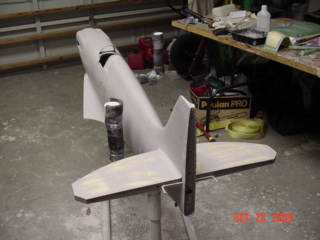

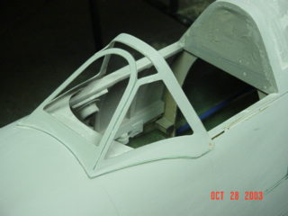

Okay guys, it has been sloooow going, but the primer gun is out. This is the fuselage. The rest to be completed with primer this weekend. . . I hope.

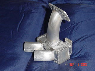

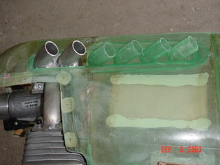

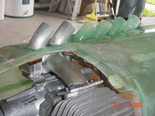

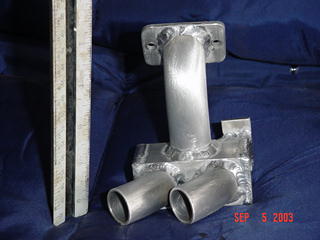

Not sure if I ever posted pics of the custom muffler I built for this bird. So, here they are. It is built out of 100% aluminum. Should be very cool. The exhaust stacks will exit out of their scale location at the first two on the port side. (Is port the left side?) Obvioulsy, the dummy fiberglass stacks that came with the kit will not be used for these first two spaces.

Nice job on the scale exhaust, but I would like to submit my two pennies worth. The exhaust look's like it is close to the surrounding fiberglass lower cowl. The heat from the exhaust could possibly soften the glass or bubble your paint in these areas. Something that you may already plan to do, but made no mention of.... is a heat shield.
BVM sells a very thin ceramic cloth blanket or BVM heat shield paint that could be used as a protection barrier. Just a suggestion.... keep the pics coming.

Mark, This exhaust system gets rid of the exhaust and heat very quickly(and noisily). I have not had any problems with the fiberglass or paint in the surrounding area. However, mine is made from steel(noseweight) and yours is aluminum. I dont know if that will make a difference or not. BVM does indeed have a heat shield material that comes in liquid form. You can paint the inside area of the fuse around the exhaust with it for extra protection. Keep the pics comin!

Thanks Evan and Countryboy for your suggestions and experience with possible heating around the exhaust stacks. Evan, I have suspected that the noise factor with this muffler would be pretty high since it is virtually devoid of baffling. No matter, I love the noise! Especially while in flight. I am hoping to finish priming this weekend and then get to color base coats within the next two weeks following. I will have to put in panel lines and rivets first, and that definately takes time. By the way David, thanks for sending a larger picture of your Spit. It is Beautiful. Isn't that an Indian Theater trim scheme? I may be wronge. Either way, it is gorgeous. Hope mine turns out as nice.

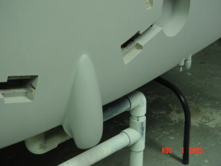

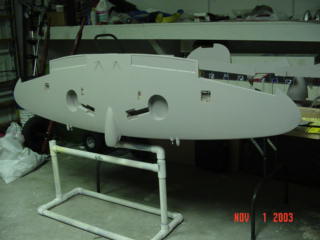

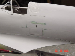

Priming finished today. SAnding, panel lines, rivets then on to base coats. Should be another two to three weeks until completion. Thought I'd post a couple of the wing bottom. So far, everything looks good.
