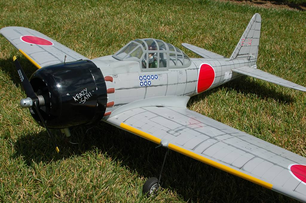

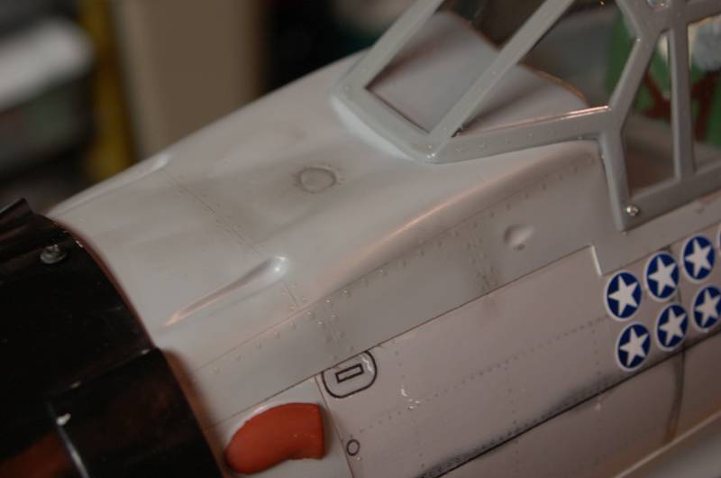

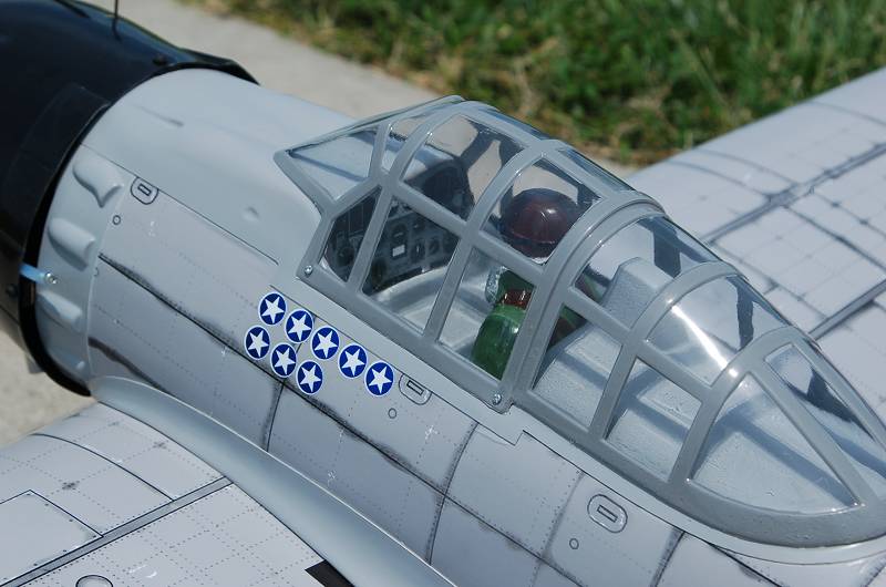

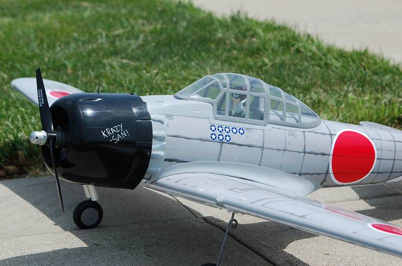

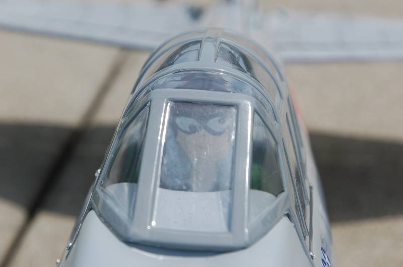

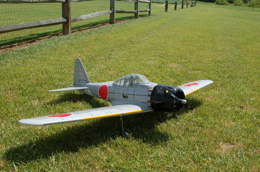

Guys, I finished the Zero and maidened her last Monday and spent today flying her as well. I did away with the mechanicals and installed Spring Air retracts with Robart scale wheels. It's powered by an old .46 OS Max FX that runs like a champ. I installed a Slimline Pitts style muffler because I wanted the cowl to keep some sort of scale appearance. The canopy was masked inside with tape and then I shot the frame with Testors Gray paint. It took a bit of time to do but the results speak for themselves. I wasn't too keen on using the colored stickers to "frame" it up as I was worried about them peeling off over time. I'm running the 2.4 Futaba 7 Channel Rx with an 1800 mAh NiCd pack. It's a bit crowded inside with the air tank, battery, servos and gear valve/servo but it works. I named it "Krazy-San" as a throwback to how the Japanese engineers at Honda referred to me when I worked there. Note the pilot is a little "Crazy" himself. Finally, after one day in the sun the instrument panel sticker started peeling up so I removed it, stuck it to a thin piece of wood as a backing and then sealed the edges with Testor Clear Window Maker cement. It help up today in the 90 degree heat.
Love this plane!!! Flies like a dream on 1/4 throttle.

BOXMAN27,
CONGRATS,,,, LOOKS REAL GOOD,,,,I agree... best to paint the canopy vs using stickers...

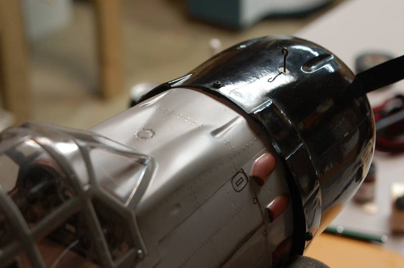

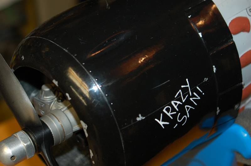

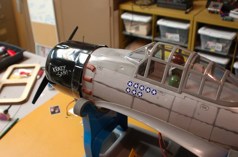

I wish "boxman" could chime in and explain what he used to scribe his panel lines onto his gun-hood and cowl.
I would think that an Exacto would be too narrow.
Exacto worked well, I wish that I took a pic before work was done to gunhood. Also made mg's from nyrod tubing with holes drilled and smaller tubing stuck inside for barrel.
An overall view of my work(still not 100% done) on the weathering and exhaust stains for the fuse.
I was a bit disappointed with the plastic tailcone that was supplied but, a coat of paint, then scribed panel line and some rivets helped.
I also did some work on the tailwheel area, I just couldn't live with the musicwire tailwheel strut/axle so I gave it a little going over.
