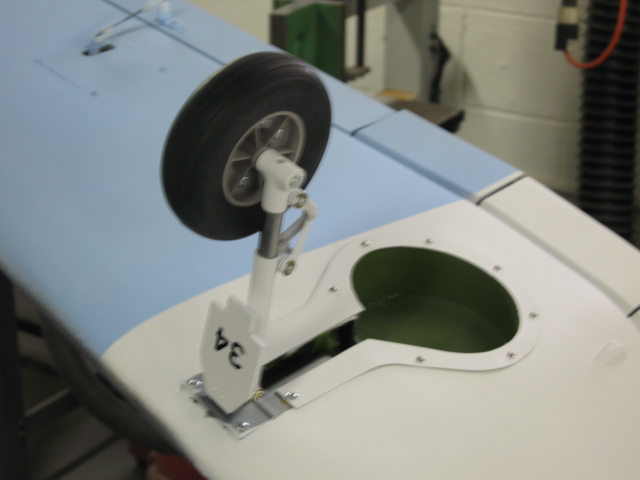

Old 02-01-2009 | 05:16 PM
My Feedback: (126)
Joined: Mar 2003
Posts: 834
From: Baldwinsville, NY
Default RE: Lado retracts, do the really exist?
That was awesome!
Here's another up close !! and a pic of the final install.
http://www.rcuvideos.com/video/lado-Retracts-wmv
I waited almost four months for these.

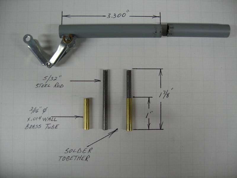

I have a question though... how do you decide which strut diameter size to order? Is it better to go with the larger diameter strut size (since I'll have to buy new struts as well, once the LADO's are back in stock again)?
Thanks!
- Michael

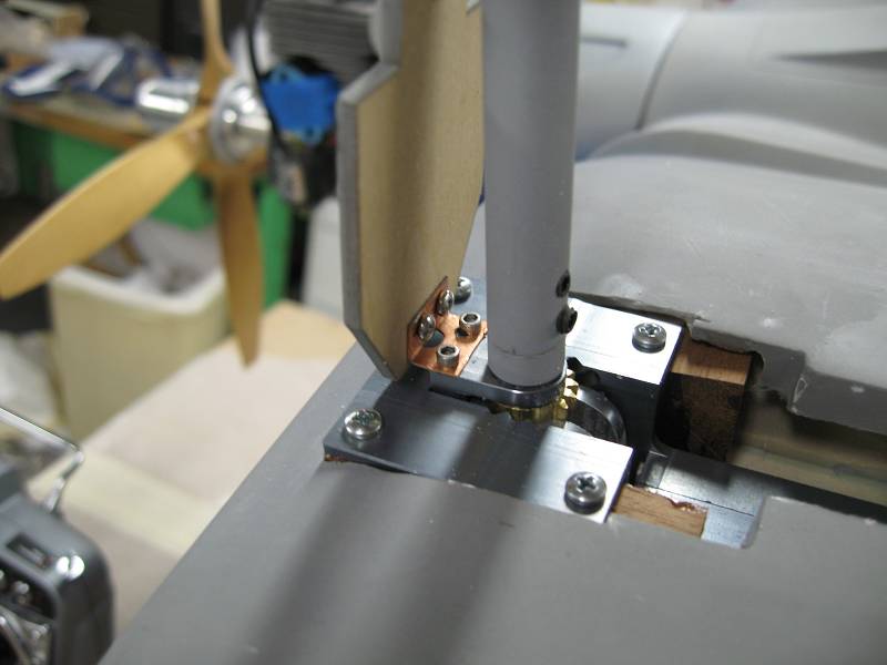

Old 02-08-2009 | 01:45 PM
Joined: Jan 2005
Posts: 47
From: McGraw, NY
Michael:
I usually use Robart 650 or 653 struts and use the 3/16 inch adaptor that is included to fit the LADO 3/16 inch opening. The 3/8 inch strut fits the LADO’s perfectly. The joining wire only has to be about 2 ½ inches long and is easy to replace if need be, although I have never had to replace a joiner yet.
Does this help?
Ta Ta for now.
Paul

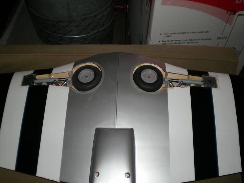

Old 02-08-2009 | 03:22 PM
My Feedback: (13)
Joined: May 2004
Posts: 4,177
From: san francisco, CA
ORIGINAL: Michael211
Thanks!
- Michael
if your going to use the rotators they come with the 5/32 holes for the stock struts to fit,for these I made my own connectors and they seem fine for strength, would have prefered the 3/16 but they are not making the units now with that hole size so I ordered the ones they had at the time.
for the units that I have in my Mustang I went for the larger wire connectors, since I am using the larger Robart 662 struts and they don't use the smaller wires anyway, the smaller Robart struts come with a adaptor for each wire size.
when I made my connectors out of regular piano wire stock, I heat treated the metal after cutting for length, surprising how hard the metal gets when red hot and quenched in water or oil, it increases the brittle nature of the steel but it won't bend without alot of effort.

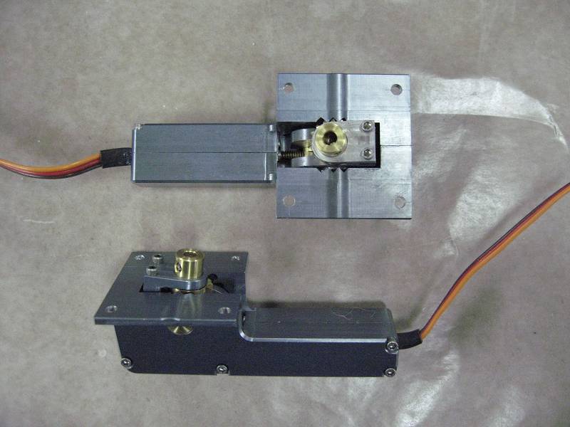

Old 02-08-2009 | 04:15 PM
My Feedback: (126)
Joined: Mar 2003
Posts: 834

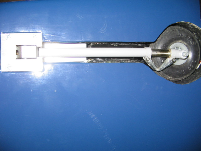

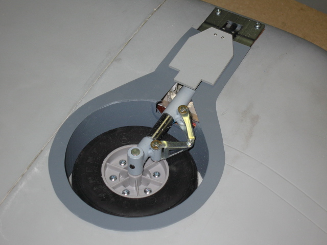

Thanks!
- Michael
Michael,
I would always go with the 3/16" wire if I could.
I'm using Lado's 60-2T on a 15lb Corsair. With this weight I needed a Robart 660 Robo to handle it. They're rated at 18lbs. The 2T's are only available for a 5/32" wire. The 660 strut is a 3/16" wire. I thought I could drill out the retracts but there isn't enough stock at the retract trunnion. I made my own wires with a 5/32" wire and soldering a 3/16" x.014 wall brass tube over it.
Another benefit of the larger strut was the fact that the I.D. of the 660 would fit snuggly over the brass fitting on top of the lado, making for a very clean looking install.

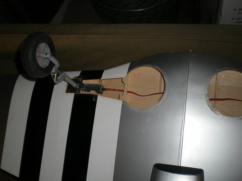

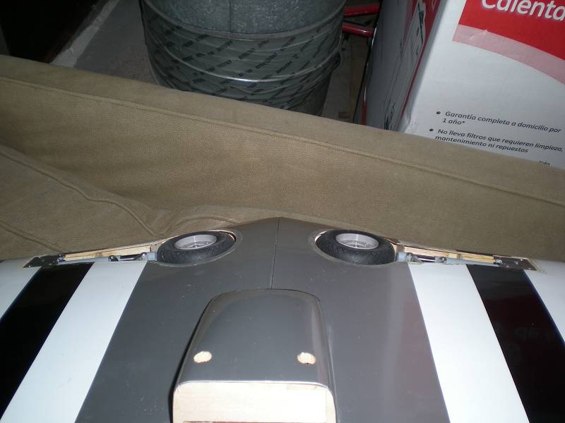

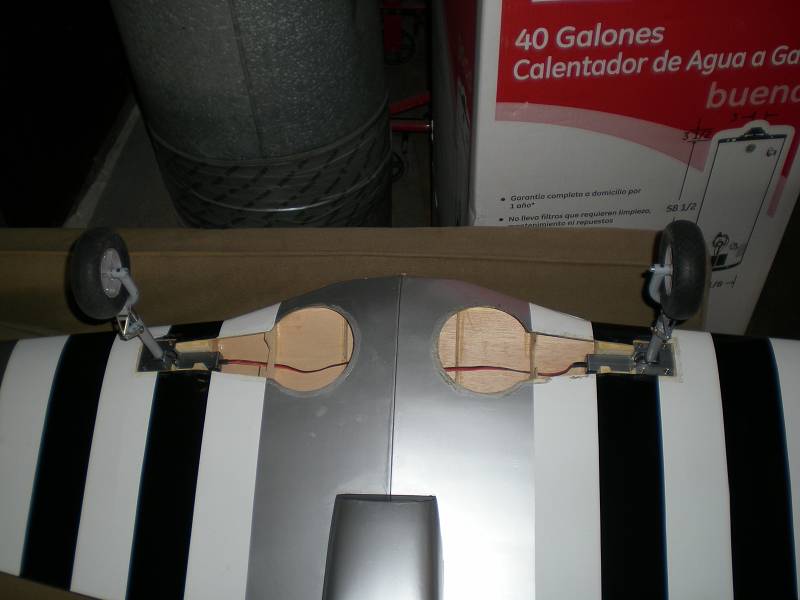

just finished fitting my LADO's to my Hangar-9 Mustang, I did go with the larger struts so I could use the 3 1/2"Robart tires there better looking than the stock ones so I went for those.
after removing the old mech. gear and the plastic wheel wells I was surprised how much area there was in the wing, after I dropped the LADO's in literally they fit perfectly in the space in the wing, I fit and cut the struts to size, since I was using the larger struts, I had to cut the springs down to move the spring stop down enough to allow the connector to fit in the shorter tube.
I just used JB Weld to secure the adaptor in the tube and after a overnight dry reassembled the struts they don't move the full distance but the spring tension is enough so it doesnt matter, if I need more bounce I will cut the piston down for more travel, and trim another coil or 2 off the springs, but for now there fine the way they are.
I havent made the new tubs, and channels, for the wheels yet but here they are installed in the wing,they fit pretty good, and the looks are a huge improvement over the wires, the only problem is that the wheels sit just a little high in the stock configuration.
I am not planning to alter the gear mounts right now but I may in the future to get the wheels to sit lower in the wells its going to require the gear to be lowered by at least 1/8" which there is room for in the wing mount area but will require me to remove the existing rails and do some cutting, if I need to do this I will use some hardwood to replace them they dont stick out that much so I will just fly it for now.
I have a Top Flight B/C Malcom hood conversion kit to build, so these gear might make it into that project depending on how long the H-9 lastsits a great flyer and has been a trouble free plane, if the weather holds I will take it out next weekend
