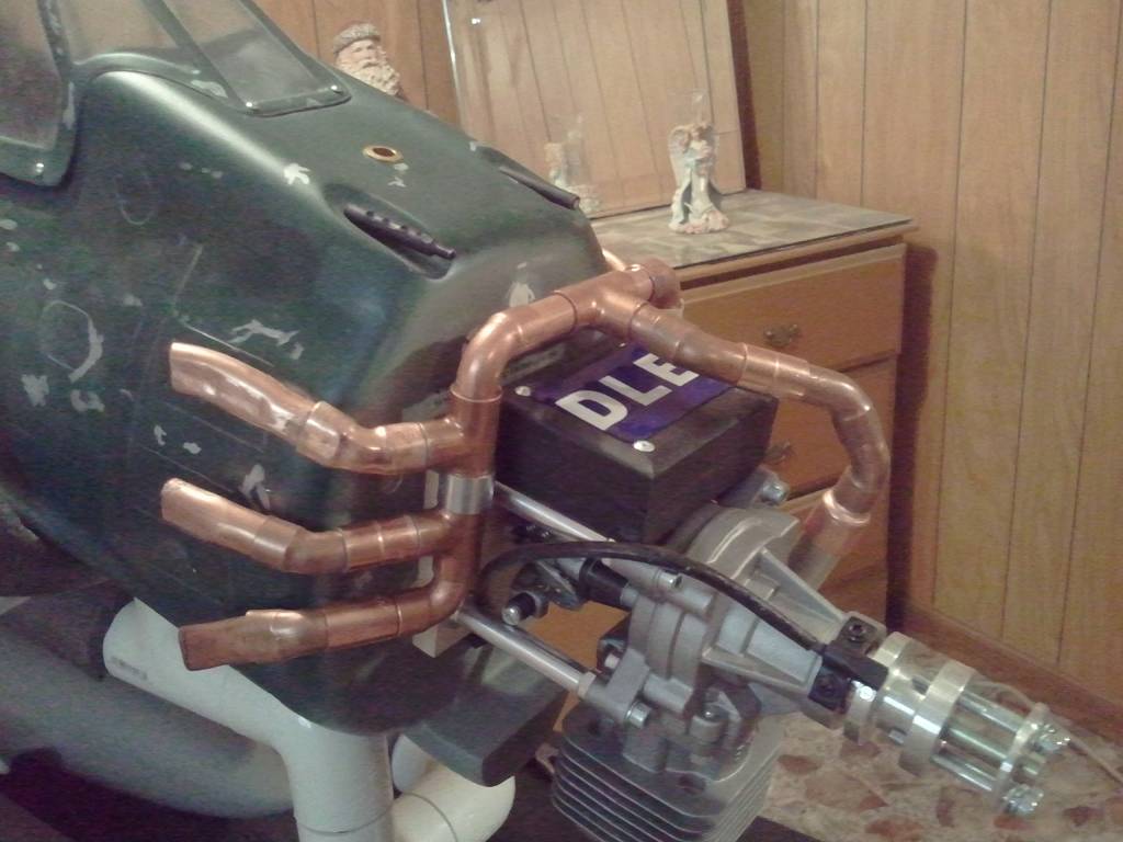

mikes zero

ORIGINAL: 77chickenhawk
mikes zero
I cut my cowl flaps out also, nice exhaust! I will not be doing that, but it will probably look really cool when the engine is running.
What cowl is Mike using, it looks better than mine!

Im using a cowl for a yellow zero however i have had to cut it up and re assemble it to get the correct diameter and shape, reason for the metal cowl flaps is that it allows me to hinge and get the clearances needed on the off chance that the exhaust should touch it would touch metal and not burn fiberglass cowl

Nice looking cowl flaps Mike. Are they going to be movable for better air circulation?

I will be able to position them where ever i like but they would be held stationary at a pre determined location

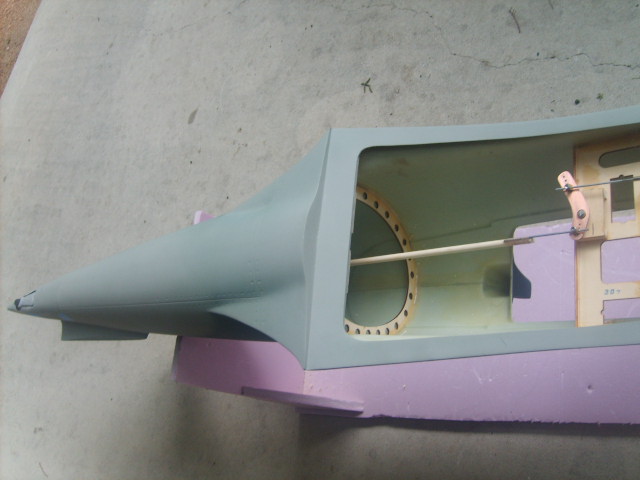

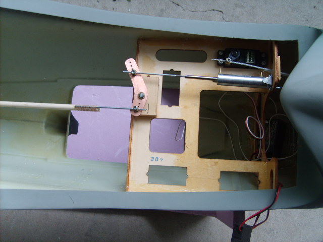

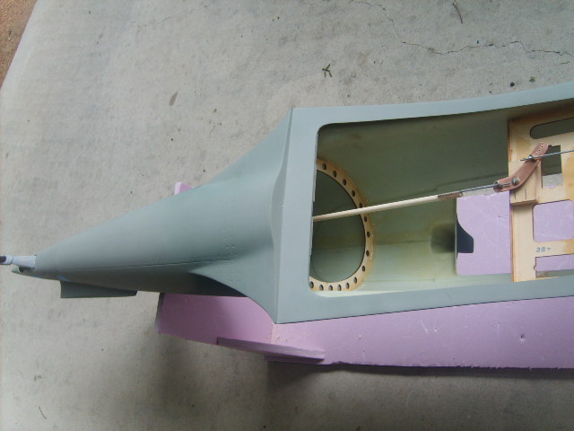

No one asked if my tail wheel had a lock when extended, I can tell no one is paying attention to this, but maybe someone will use the info. Dave Platt had his Zero's tail sitting on the ground when the air pressure bled off, but not mine! I simply moved the locking mechanism under the cockpit. I was moving the elevator servo anyway because I'm trying to get as deep a cockpit as I can, so it worked out great for the scale retractable tail wheel.
The pictures are pretty self explanatory, and it works great, without air in the cylinder the tail wheel stays extended and I can move the plane around without it collapsing.

Did not think that it would not get it up and down, but I am interested how you are planing to do steering. And of course watch up weight
Mine will probably be heavier than I thought.

Platt used an air cylinder hooked directly to the lever on the tail wheel, it works but there is no down lock, if the air pressure gets low the tail wheel would start to retract with any pressure on it. I'm using fishing leader for steering set up in the standard way using a PC board pivot arm of course.
You put a lot of detail into your plane, I did not see your exact glassing method, but with a light weight method you can save much weight! I could definitely build a lighter fuselage, but I want to use this one so we shall see what the weight is. My tail wheel is just under 1oz in weight, not sure what the plastic robart one is or some of the other methods used in this thread, but it is as light as I can possibly make it.
