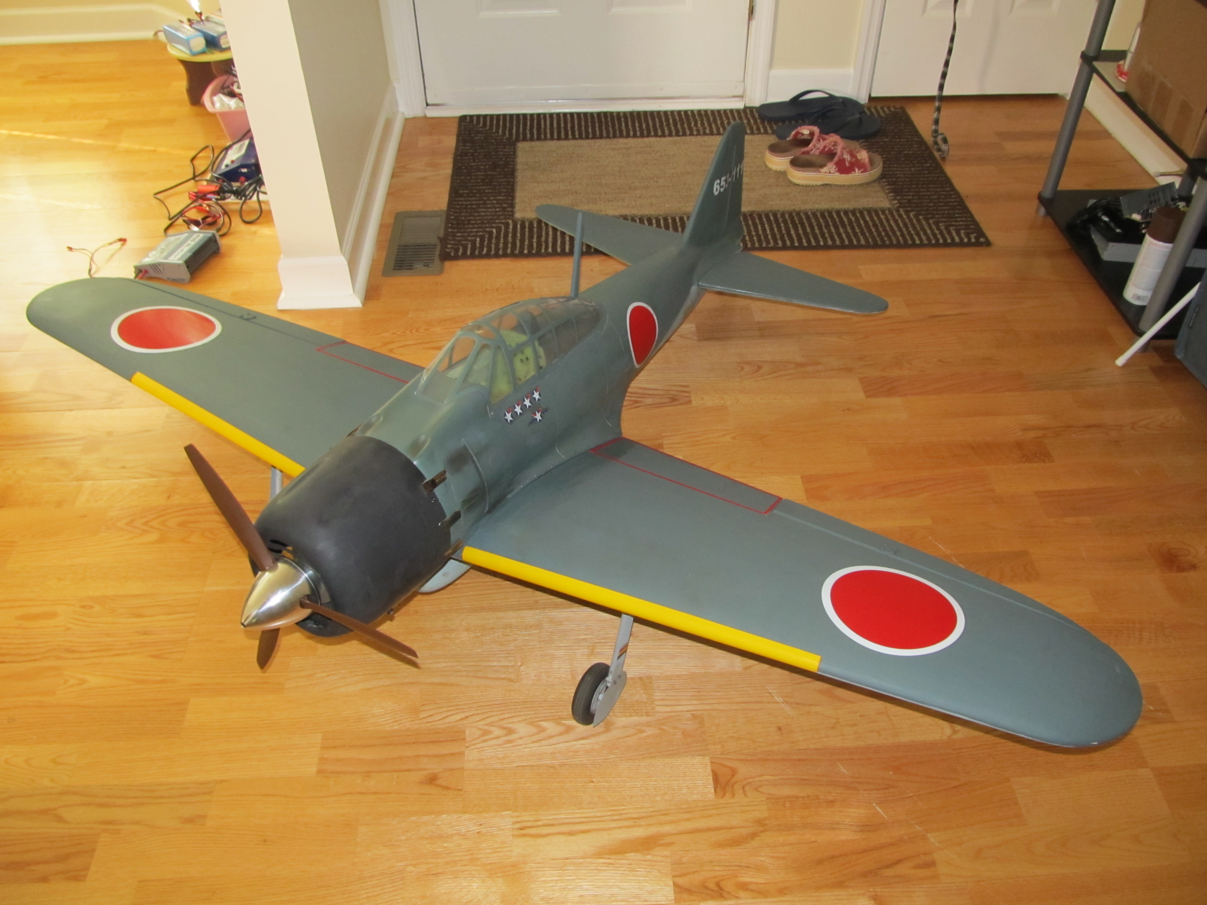

Well, for this plane it is important to have as many as you can weight in front of CG. My plane came with about 8 kg. Mostly Because it will be powered by Zenoa 26 (1.8kg) and retracts are big ones, for planes with max weight 15kg.
Glasing, panel lines, rivets and painting has added 0.4 kg.

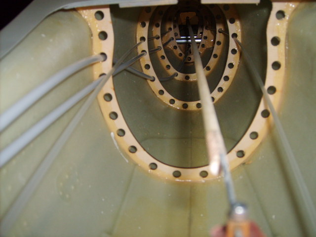

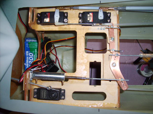

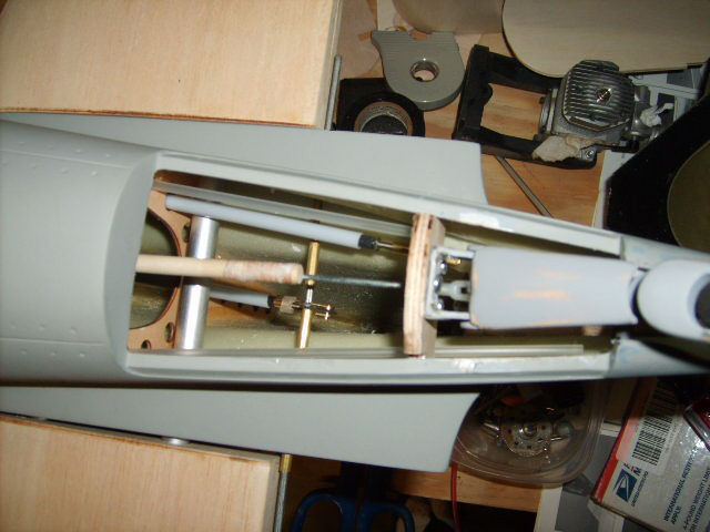

Elevator assembly
On movable surfaces of elevator, I made little ​​tray in balsa for wire that will move
it. Tape will prevent excess of epoxy glue to get on cover.
A little glue, and wire is inserted
Linkage is with bovden's, each half has servo. Servos are classical analog.
In this picture ends of the bovden's are not glued yet, but as my little son said
"In real life, they are"
Still remain to solve chock (hopefully tomorrow) and then weathering.
Hire is working atmosphere at the dining table.

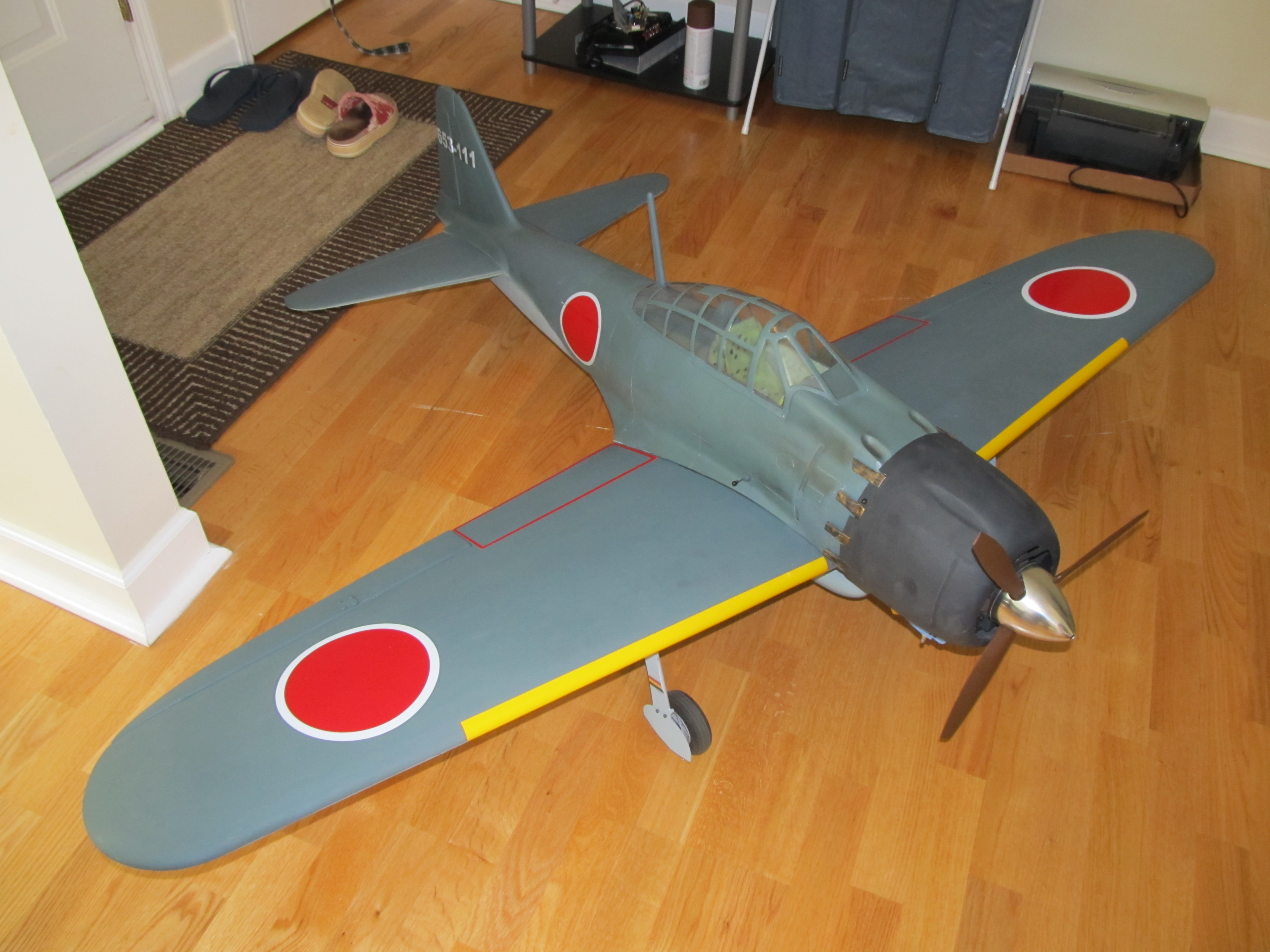

As I said, the plane normal to the weighing about 6 kg.
When you add retracts (300g), strengthening the wings mounts for retracts (xxx g),
the engine (at least 800 g heavier), glassing and painting (400g), additional sevos (total 10) 3s lithium battery, voltage regulator.
There is nothing special in this plane. Hope tomorrow will be able to finally put it on scale so you will all now verdict.

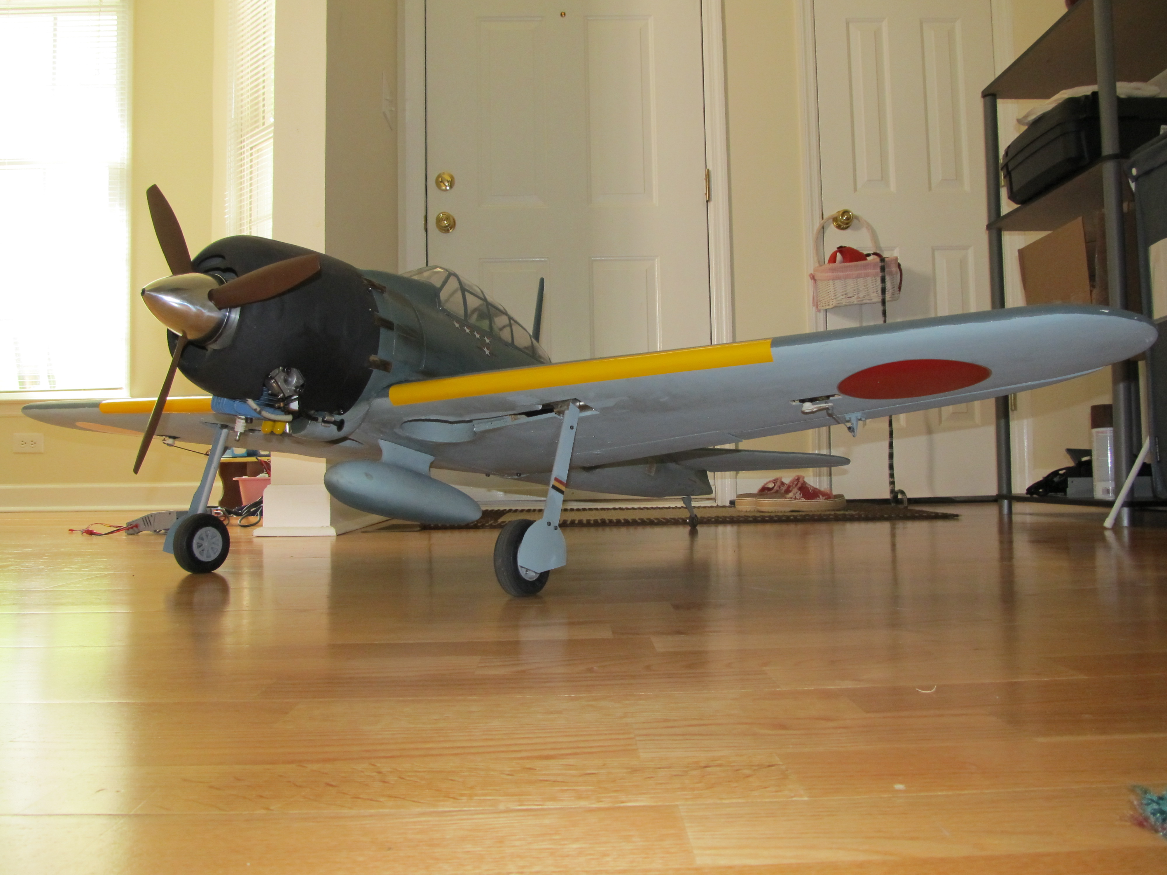

My Zero AUW is 17.2~17.5Lbs mainly due to scratch built strong wing and fuselage repairs after crash.
(CG 135~140mm at the root, sure little tail heavy)
Today I flew few times and my wife took some video by new camera I bought.
It was first time today for her use this camera (Canon powershot SX130) so sorry for not catching up the speed...
I think 17.5Lbs CMP zero 71" flies pretty good but landing is little challenge everytime to not to damage retracts..
I got dead stick few weeks ago with this 17.5Lbs zero and luckly came back to ground with no issue. (Of course I was very nervous and just tried not to pull elevator at all until wheels touch to the ground).

After colision with FW 190 (my son and his soccer ball)
I had to repeint part of the wing size of 5x5mm.
Since I started painting, I thought that I could paint a few small things.
This white plastic is the upper part for securing 4 screws for aileron horn.
now it is looking much better
As for the Thunderbolt, I have printed label with the details of cocpit and cabin areas,
and instrument panel in front of the pilot.
After I trim plane, and if it can take some more weight, I will make sliding canopy and
details in cocpit with parts that Mike send to me.
The rest of the cabin I painted over with black paint and then did a little sending to
get a visual impression of several uears of usage
I've already started I move the paint, brushes, solvents and catalysts when I remembered that I could paint the screws
used for attaching canopy, as well as those for the rear wheel cowl.
On top side screws will be dark green color and on the bottom a light gray green..
