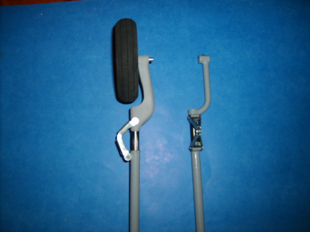

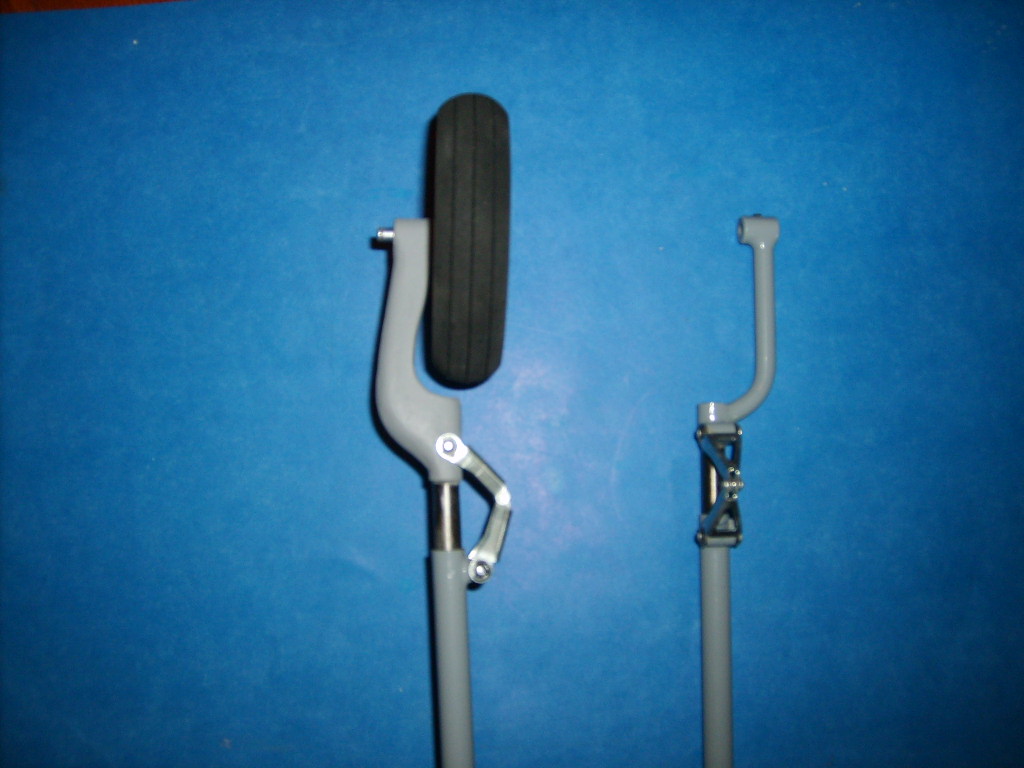

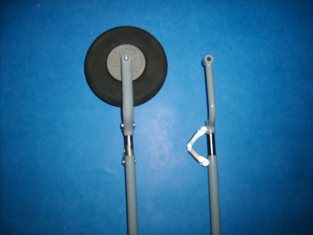

Well well well.... You know, when you put a scale tail wheel on a plane it just begs to have the main gear done right, wouldn't you agree? The Zero is an easy plane to do, not to complicated. So I went down to Walmart and inquired about Zero accessories and they told me they were right next to the Japanese ceiling fans. There they were, a set of Zero gear, now that is service! lol!
Seriously, I just modified a set of standard 3/16" struts. They work great and should look even better painted black. The scissors are made compact enough by mounting them to the scale location. The Zero struts have some funky angles, but they are correct, I compared them with a picture of an actual Zero to get the angles as close as I could.

Good job!
Those scissors in the wrong location always bothered me a lot, especially the V groove that has to be cut in the wheel wells for them [:-]
I opted to go with Eurokit oleos as they have no scissors (an easy way out
The mod looks good though.

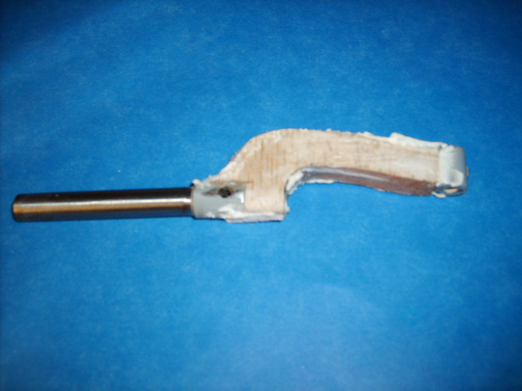

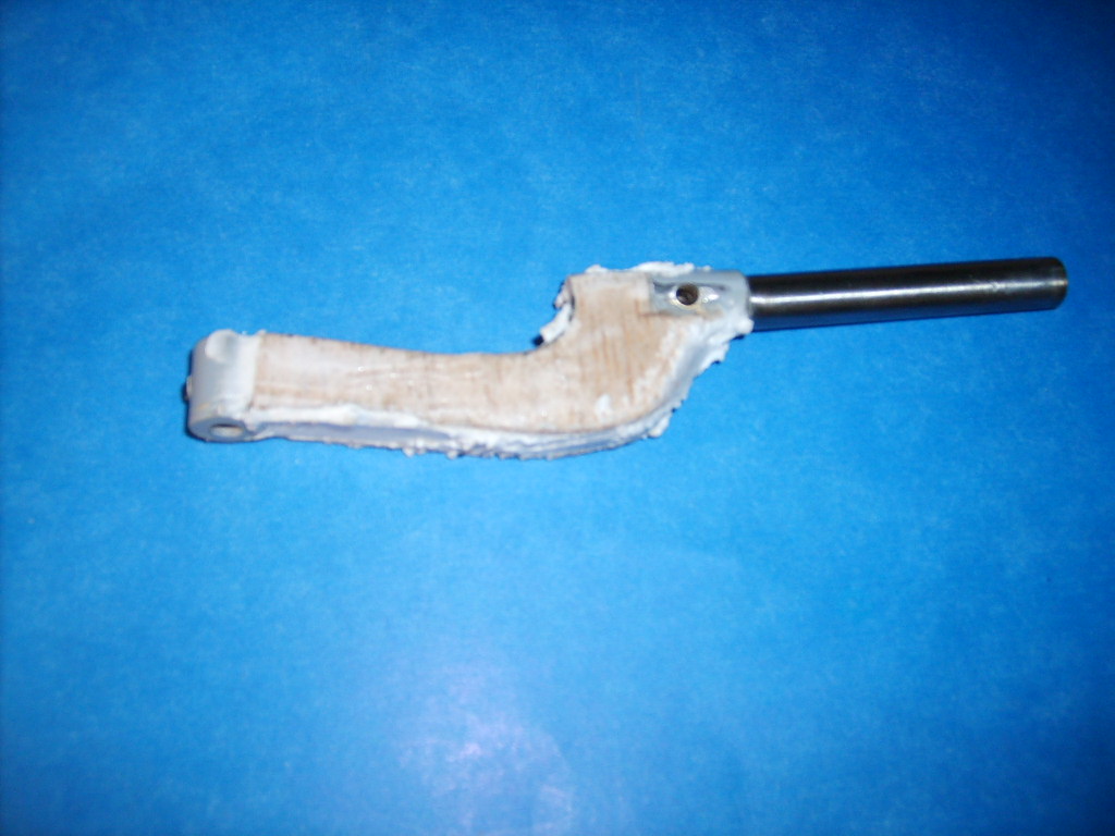

Very nice strut mod there. What did you use to build up the offset with? My first guess was JB Weld? You continue to raise the bar...Between you and Misha lately, I'm thinking I might just have to put my Zero further back in the kitbash que so I can practice on some different ones first

No, you're over thinking it, it is not structural but only a fairing. So, I built it up very quickly and easily with hard balsa saturated with thin CA and epoxy and micro balloons. All this was done after bending the struts to the closest scale outline I could.
I just thought these would be a nice touch, adding to my scale tail wheel. Keep going on yours, just pick up some ideas for the next one.

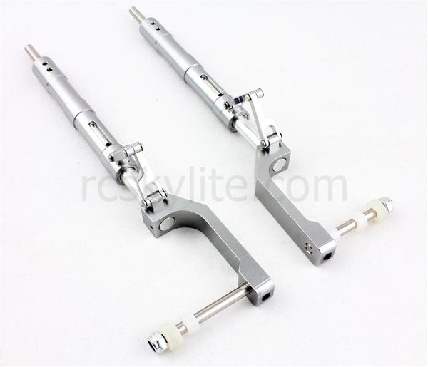

Link to supplier below. Great service. ordered, paid and had shipping notice within 36 hrs, in my mailbox in 8 days from Hong Kong. Had some overseas stuff a day or two faster and have had a few take 4 weeks after getting tracking info and verification of shipment there...I think some shipments get tied up in customs
http://www.rcskylite.com/categories/Struts/

L16pilot, great pictures, love the guns. I've also done some looking around for colors and it seems there is some confusion about cockpit colors, I like what you have done though, looks great.
The epoxy and micro balloons is anything but fragile, I've used this combination on all of my tail wheels and it does not crack. I grind the strut a bit with a course dremel wheel so that the filler really bonds to it, works great.
It looks as though the scissors on those struts you have are for show only, so I would just make up my own out of thin brass sheet. That way you can adjust them to any size and shape and attach them to the strut in the proper location. I would be a bit nervous about bending the struts though, not sure about the aluminum they used, but thanks for the link!
This shot shows the angles pretty well. I decided to go with a Robart 4" scale wheel. I'm designing my gear doors now, so we will see how scale I can make it look!

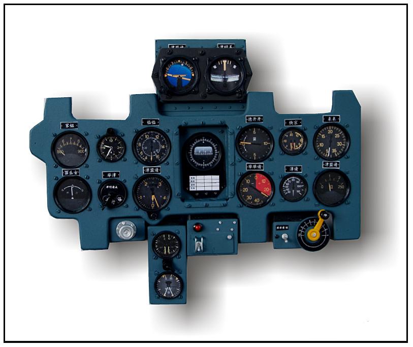

Frets - Thanks for the panel image....I'm not too far along where I can add this easily...I'll see how well our office xerox does on the print quality and I have some white vinyl. I won't be able to fit teh entire panel in my Zero...but even the upper half...then fab some MG breaches...would definitely look better than what I have in there now. Many thanks and will post photos of the results.

Okay, I've made some progress on Zero #2...some youy can see...some you can't. For example, I am awaiting delivery of my Zero pilot....actually a GI Joe 1/6 scale pilot and I also bought some various 1/6 scale leather-appearing helmets. Should be able to make a usable and convincing bust out of them...once they arrive..
In the meantime, I've been finishing the interior details. Frets - I ended up re-sizing the panel graphics you sent...stretched it here and there to better fill CPM panel space. Also made some dummy MG breaches and applied the interior graphis provided by Misha. Overall, I'm happy. No, it's not super accurate, but I have to keep in mind that I'm building this to be my every-weekend bash around warbird. Not that I don't want to detail it all, but I have a tendency to get carried away....although I am planning to "weather" the interior a bit with a scotchbright pad.
And here's another view of the interior with Luke's PETG canopy ...love that clarity and quality...
Luke - PLEASE make some more. There's some guys here doing a much better and more creative bash than I...would love to see what ZERO322 could do to make a sliding version of your canopy.

Diony mentioned something above about cockpit colors above and some confusion around them. That would be understandable as the IJNA and IJAA aircraft were terribly inconsistant in the mid to later war time regarding paint, colors and armament. Germany had delivered a large shipment of MG-151's and 20mm cannon in '42 which were introduced in production but then was not able to consistantly supply the jap req's. The Japs themselves were having troubl keeping up with various production as well, hence it was not uncommon at all to see a flight of Zero's, Tony's or other fighters lined up for arming and have 8 different types of munitions on the cart becase the planes had so many variing combinations.
Same with the colours; It seems that a red/brown, a metallic teal, and a light tan/olive were the specified colors in order of preference for the cockpits, but there have been examples of over 10-12 different cockpit paint documented and no ryhme or reason according to dates, especially late in the war.

Frets - exactly my dilema...both issues. I love doing the details, but to an extent, details can add fragility....but if all I cared about was how it looked in the air, I wouldn't be bashing the CMP Zero to the slight extent I am. I also believe that details...even small ones like the MG breeches, panel lines inside the canopy and rivets...add depth that make an otherwise ordinary ARF "pop" from even 10-15 ft away...
As for the colors, the more I read the more confused I get. And I've also read that the interior and exterior colors...(as well as components such as the spinner on some variants) of the A6Ms varied depending on manuafacturer, as Mitsubishi didn't build 'em all. So overall, I like a correct representation...but the Japanese military during WWII was very inconsistent, not well documented and difficult to verify in many cases. So, I'm pleased with how #2 is turning out and it's a big improvement over #1 already.

@L16pilot - nice work with cockpit.. I have painted complete part of cockpit in black and then did a little sending,.
Maybe it is not scale look, but I did like it, because it makes visual difference of inside and outside part.
