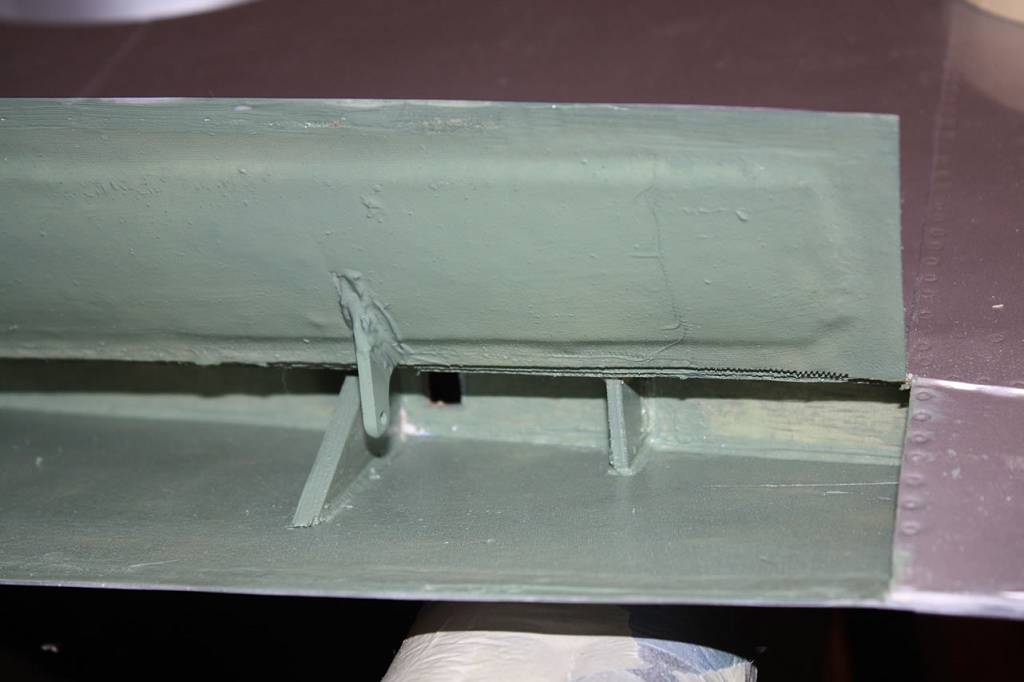

While the epoxy sets in the servo bays, I took the chance and painted some interior green inside the flap's. The color looks weird on the picture. Will paint a second layer at some point later.
Note - Not enough throw on the flaps might result in an uneccessary adrenaline rush during landing. Its imperative that the flaps have between 85 and 90 degrees travel.
ID:	1261789   Click image for larger version

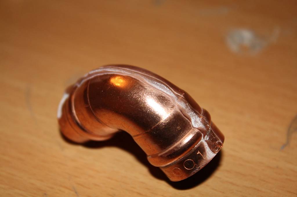

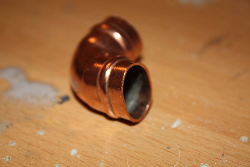

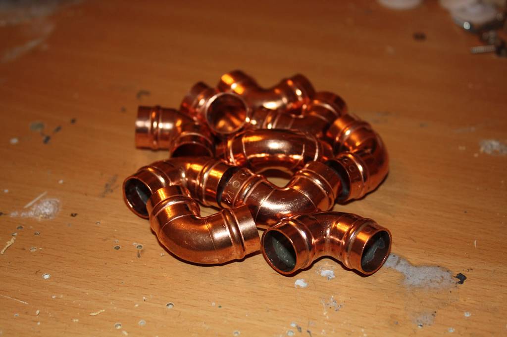

Ok - epoxy is still wet so I thought about what to do next. Off to the plumber to get some copper elbows.

Utilizing a bench vise to squeeze the elbow a little bit....
Some zap and activator spray to imitate welding joints...
ID:	1261805   Click image for larger version

Repeating this 12 times....

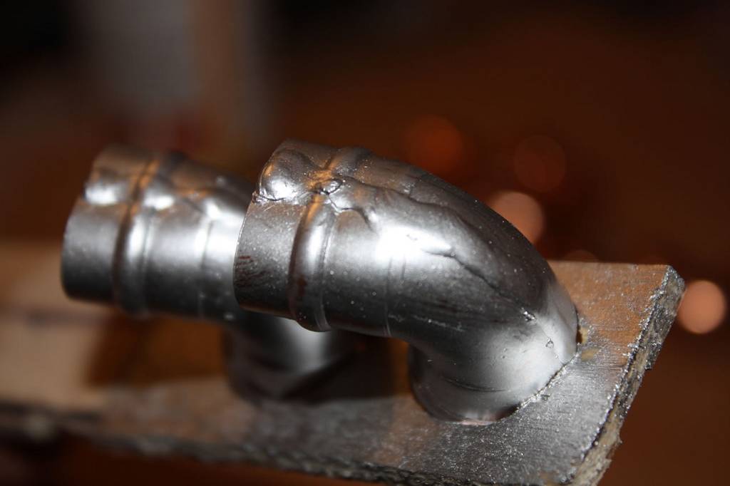

A preliminar fit on a plywood strip and some silver paint added: My future dummy exhausts. I'll rearrange them later to see how they fit in the cowl. I think it looks quite neat and also adds some weight to the nose
The exhausts will not stay silver of course, adding a little black and dark red later on.
ID:	1261812   Click image for larger version

Old 08-24-2009 | 06:58 AM
  #36
Brad330l's Avatar
Joined: Jul 2004
Posts: 2,200
From: Perth WA, AUSTRALIA
Default RE: Comp ARF Spitfire build
Hajo,
I see that you have a good bit of surface area covered with carbon fiber for the base of your aileron servo and this well may sufice as a good solid foundation but I cant help but think of my Extra 330 instructions from CARF suggesting (strongly) to 'box in' the servo well by adding balsa or ply to connect the top and bottom surfaces of the wing to stop any chance of vibration/flutter. The Extra has huge control surfaces with huge throws and the Spitfire does not I know but the Spitty will travel three times as fast and carry a huge amount of energy so could it be a problem?
Just a thought. I boxed out the aileron servo well on my Yellow Spitfire just in case.
Brad
Old 08-24-2009 | 08:14 AM
  #37
CaptainFlynn's Avatar
Joined: Feb 2007
Posts: 111
From: Nord-Baden, , GERMANY
Brad - thats a very good point, thank you. I will do as you suggest. Will report back once I am done with it - probably tonight.
Hajo

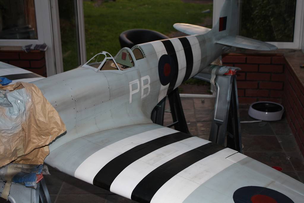

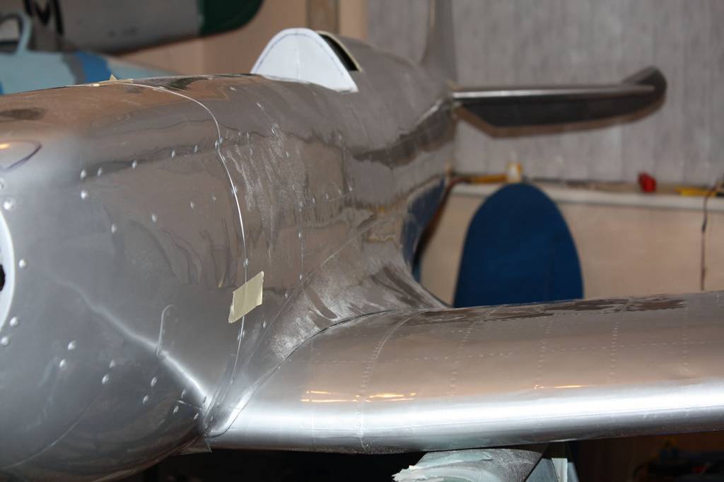

Sorry for the late update, I've been busy at work but the Spitfire is as good as complete! Rebel - as it looks now the Spit will balance out nicely with the 80' 3W. I don't think that I'll be needing lots of lead in the nose - Thanks to the new sandwich fuselage. So far no mods necessary, really. The model is great to build.
For a ZDZ100 inline you would need to create a proper airflow in the model like the original Fiberclassic Model had. You might be lucky and I still have the old manual with some drawings for inline engine installations.
I will update the build pictures soon, but I cannot resist to post a picture of the current paint status. I took the chance since the weather was really good today.
Catch you all later of to the pub to have a pint
