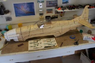

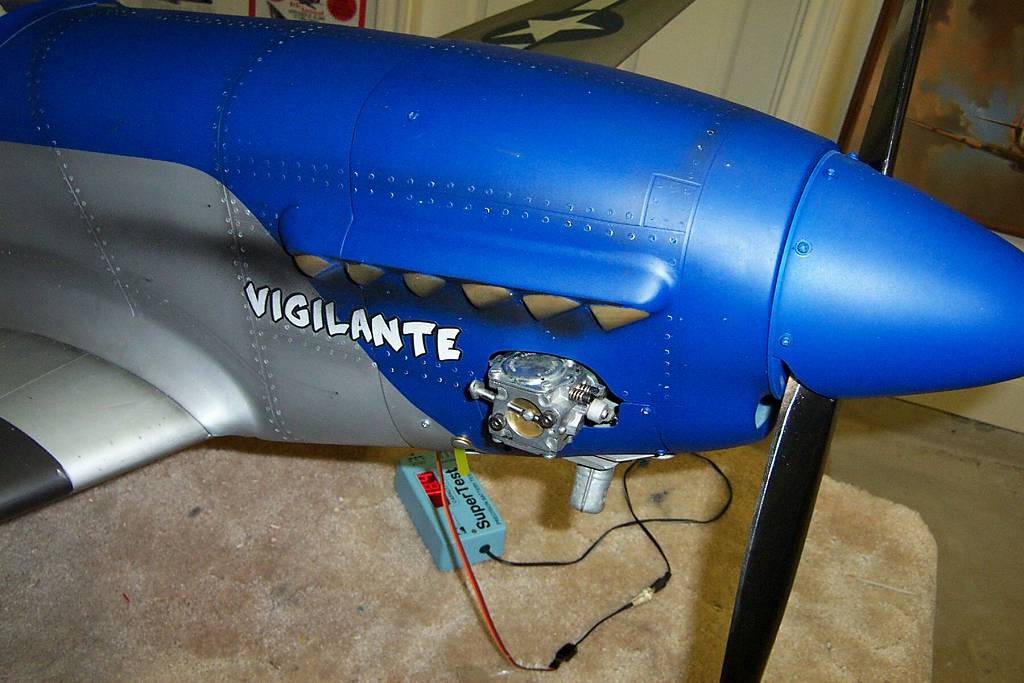

I used 1/16 and also some 1/8 in some areas on a TF GS P51 (84"ws) and it turned out about right. Like they say, depends on plane size! Paul

Old 02-07-2010 | 07:01 PM
Posts: 3,157
Received 6 Likes on 6 Posts
From: Jupiter , FL
Default RE: Panel lines on zero
Meschmidt
Did you spray right over the tape? Leaving it.
Or did you spray a coat or two then remove the tape to spray another coat?
Nice work!
Charles

ORIGINAL: Meschmidt
I used 1/16 and also some 1/8 in some areas on a TF GS P51 (84''ws) and it turned out about right. Like they say, depends on plane size! Paul
Meschmidt,
Are you going to put rivets on? If so, would be interested in your technique, and seeing the final results. I got a large project being done and just looking for the best method of applying rivets. [8D]
Old 02-08-2010 | 05:51 PM
My Feedback: (15)
Posts: 906
From: Houston, TX
Apply the chart tape, two thin coats of primer, smooth out primer with red scotch brite pads, remove chart tape and paint with final coat. Rivets applied with hot pencil soldering iron with small brass tube on end of it. Just a quick touch with a little pressure applied to it and they go on quickly. Not the best way to do it, but certainly the easiest! Paul
