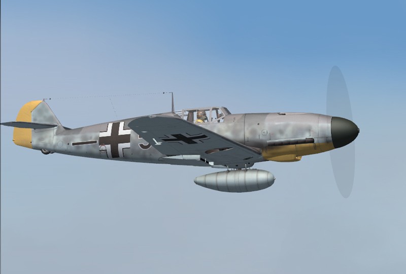

BQuartucy, keep in mind the tailwheel does not fully retract. Half of tha tailwheel should be exposed when it is fully retracted. I can't quite tell in the photos you posted if it works that way...
Here is what it should look like fully retracted, damn the picture went away. Give me some time to get it back.
Here try this one:
http://www.flight1.com/images/bf109f/bf109fr4.jpg

Thanks for the photo, I have the tail wheel on a separate channel slaved to the retract channel and haven't set the limits yet. I'll set them when the tail wheel cover is installed.
