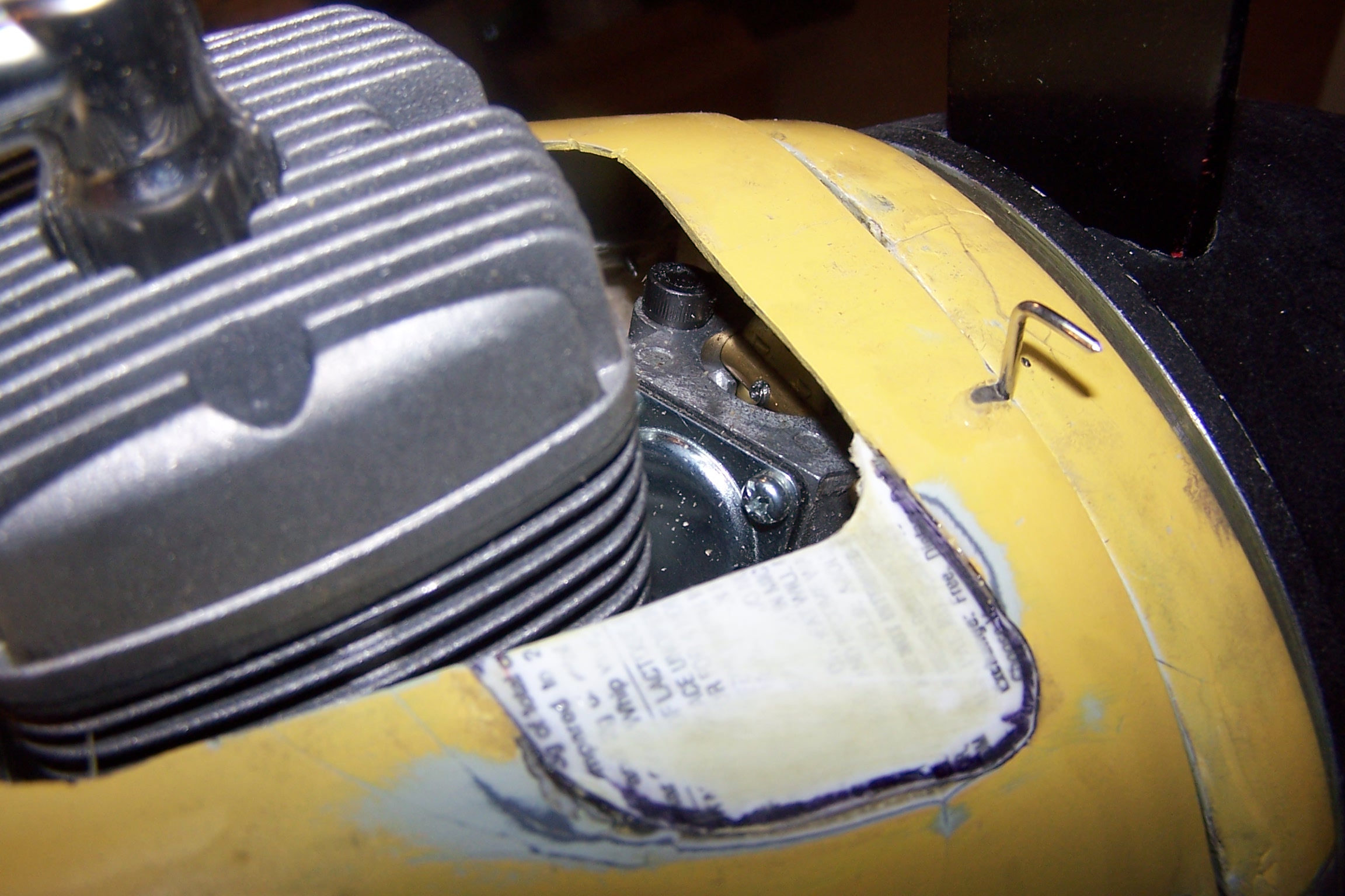

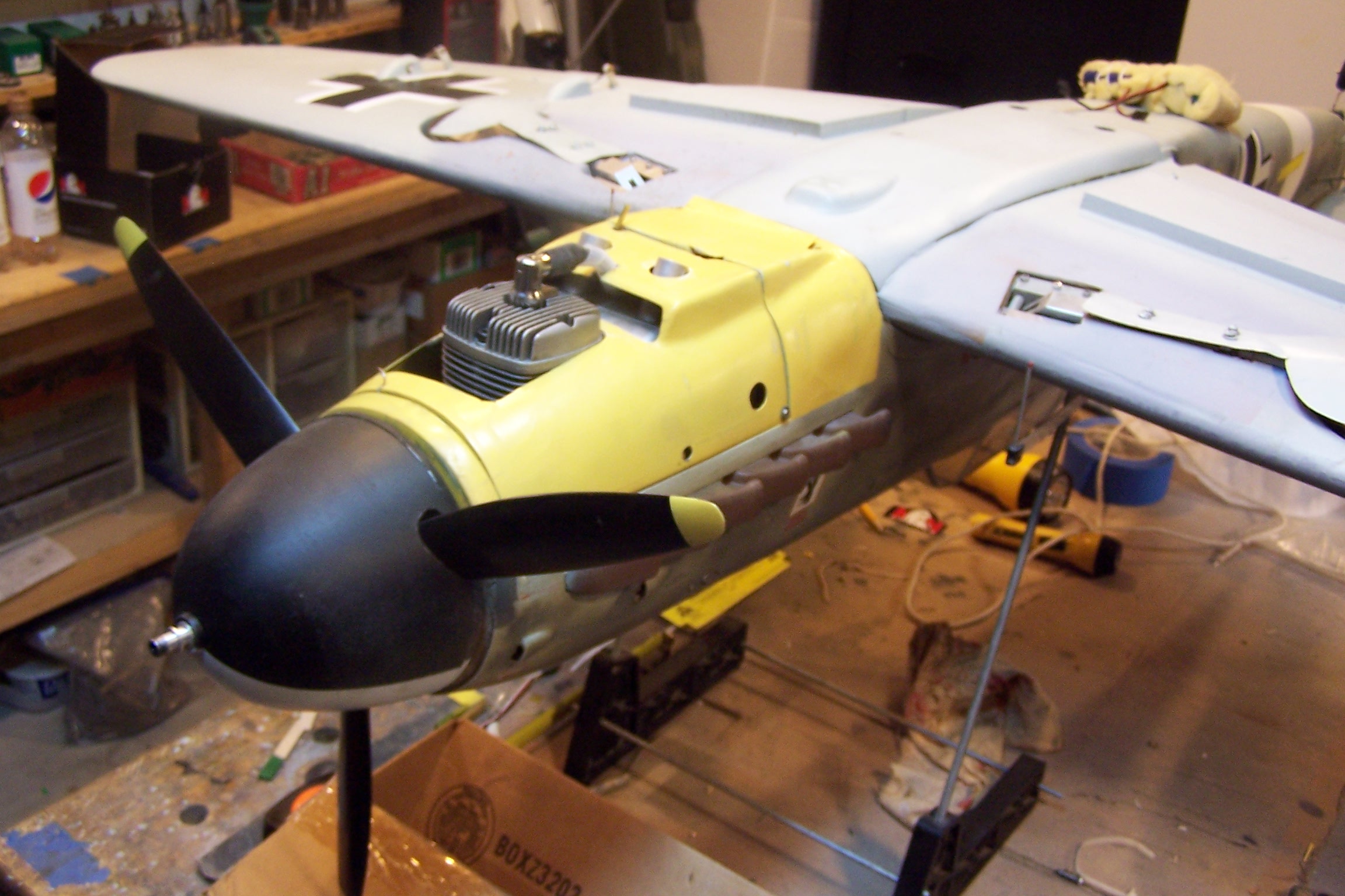

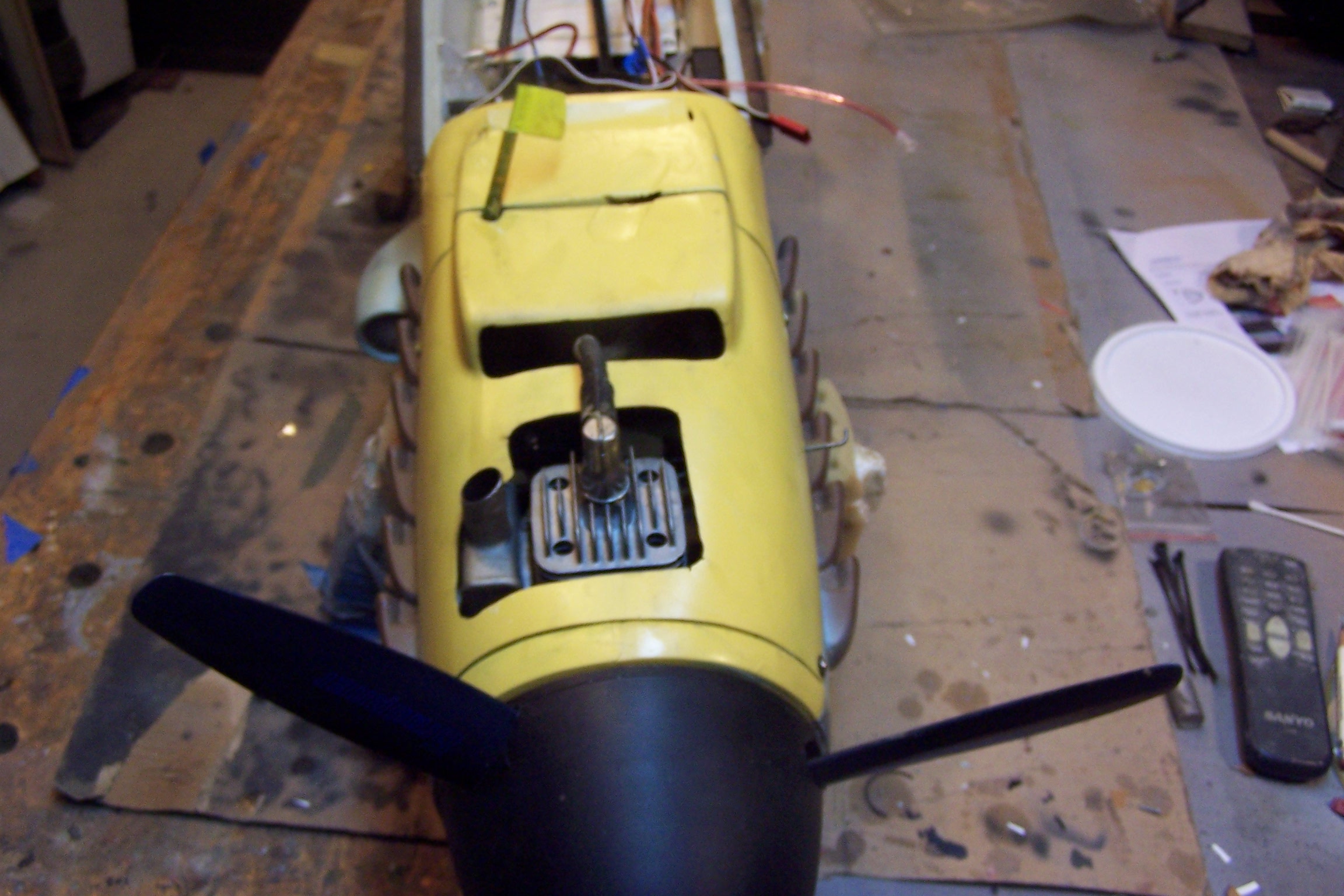

RBean 02-06-2015 06:57 AM
I'm going to do a little more work on cowl. Fill some holes, make outlet area opening larger, partially block the lower scoop. Shorter prop bolt etc.

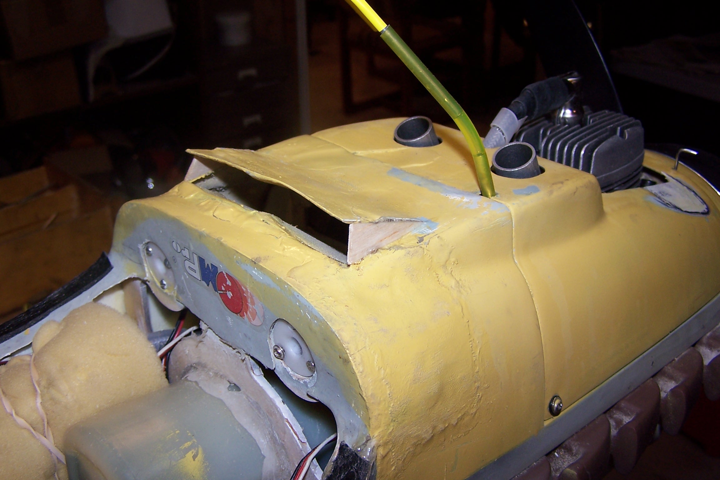

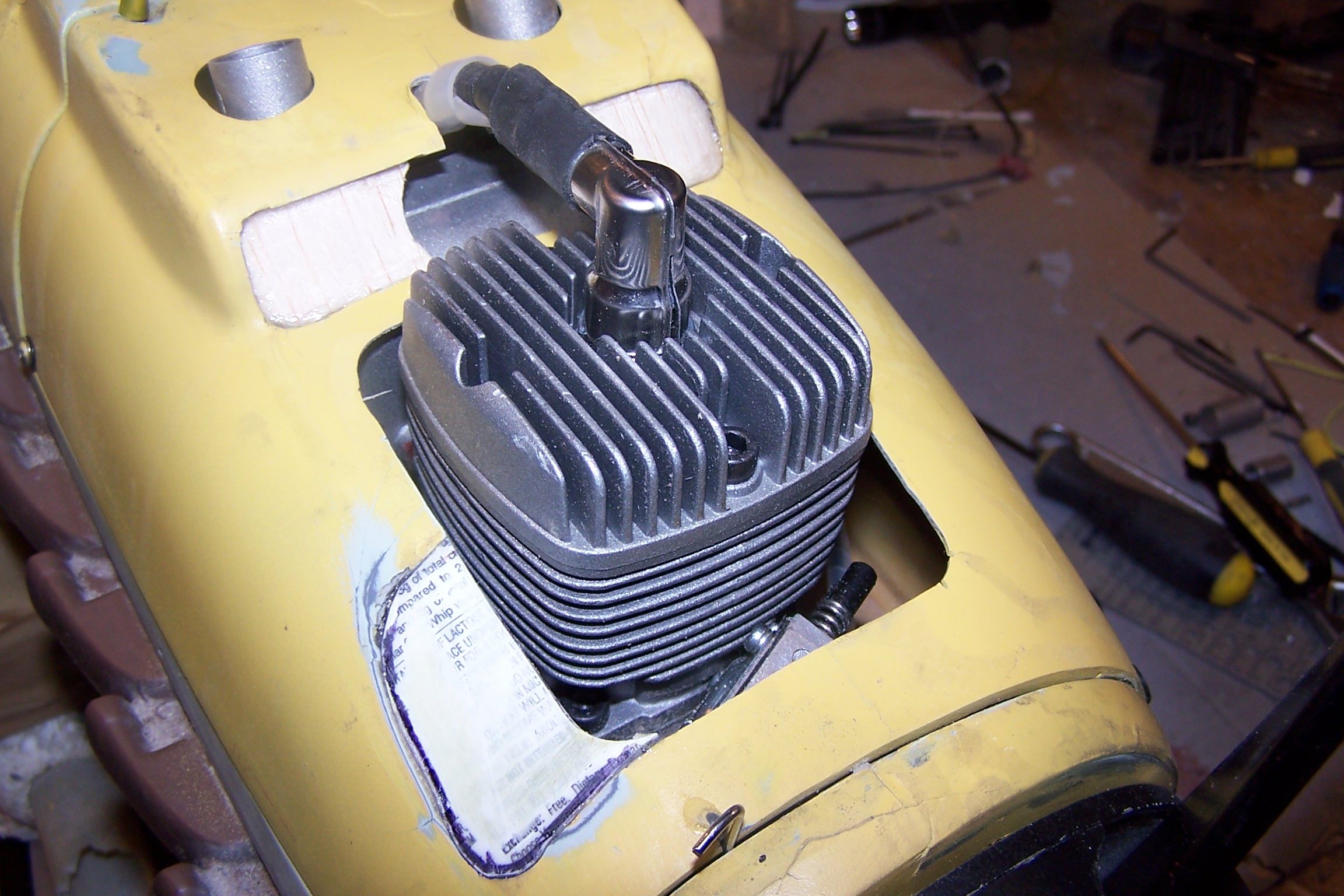

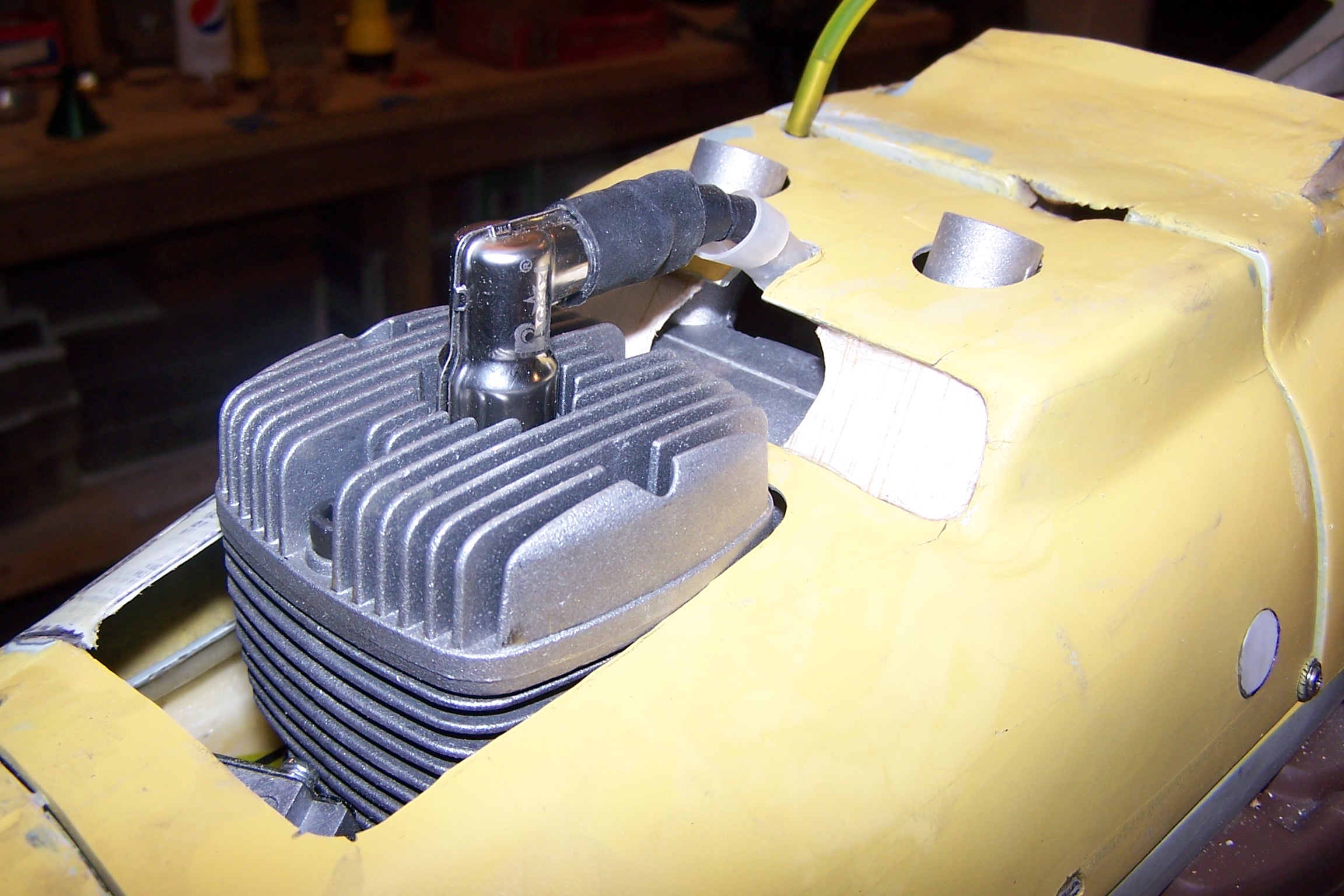

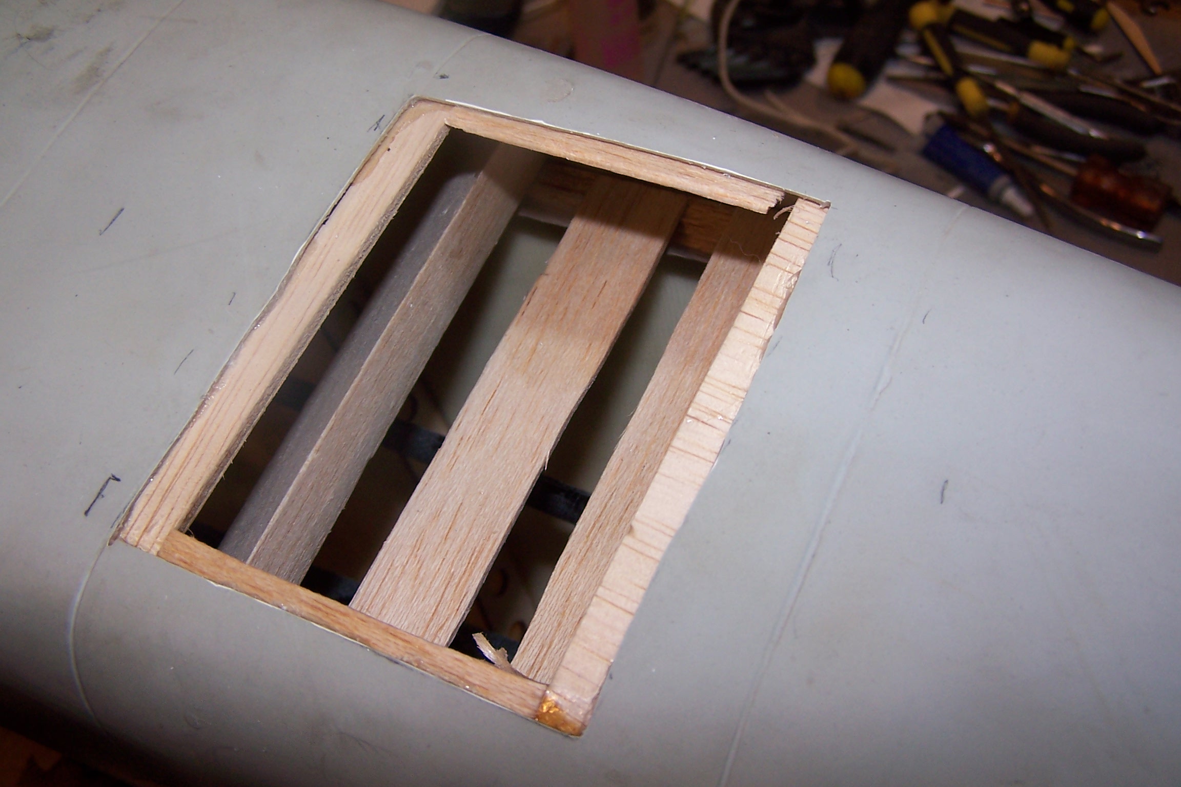

RBean 02-07-2015 07:44 PM
4 Attachment(s)
I patched up the opening for the DLE muffler. Opened up the exit area and partially blocked the lower scoop. I hope this will be enough for cooling. Thought about a scoop below and just behind the spinner, but don't want to create a high pressure area right at the carb, which might cause it to lean out too much in the air. A club member lost a giant scale Mustang with a front carb that way. http://www.rcuniverse.com/forum/atta...mentid=2071295http://www.rcuniverse.com/forum/atta...mentid=2071296http://www.rcuniverse.com/forum/atta...mentid=2071297http://www.rcuniverse.com/forum/atta...mentid=2071298
RBean 02-07-2015 07:53 PM
I ran the NGH for the first time today. Good idle, response and top end. Didn't tach and not sure If it will pull the 18-8 RCGF prop. I'll have to see.
w1nd6urfa 02-07-2015 08:38 PM
Hey RBean
On my Moki front carb gassers I attach a shroud to protect the carb vent from pressure variations created by airflow
Any thin metal like soda can will do
The 109 likes speed, therefore I would recommend a prop with 10" pitch at or over 7500 RPM
https://farm3.staticflickr.com/2906/...6fb82323_b.jpg
