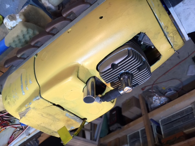

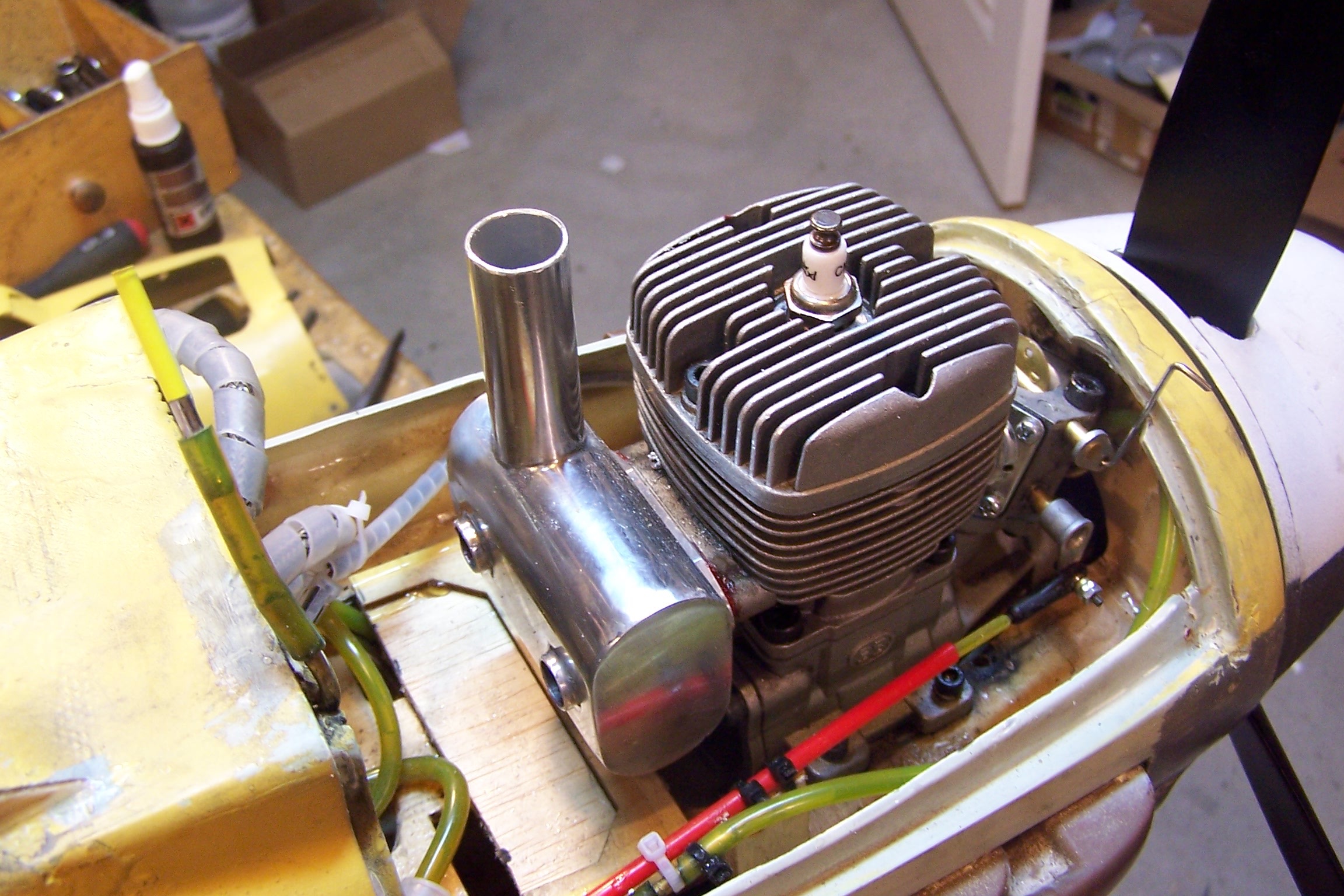

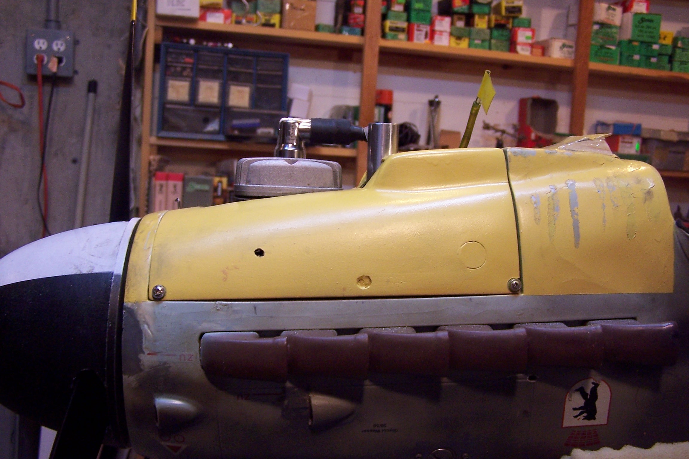

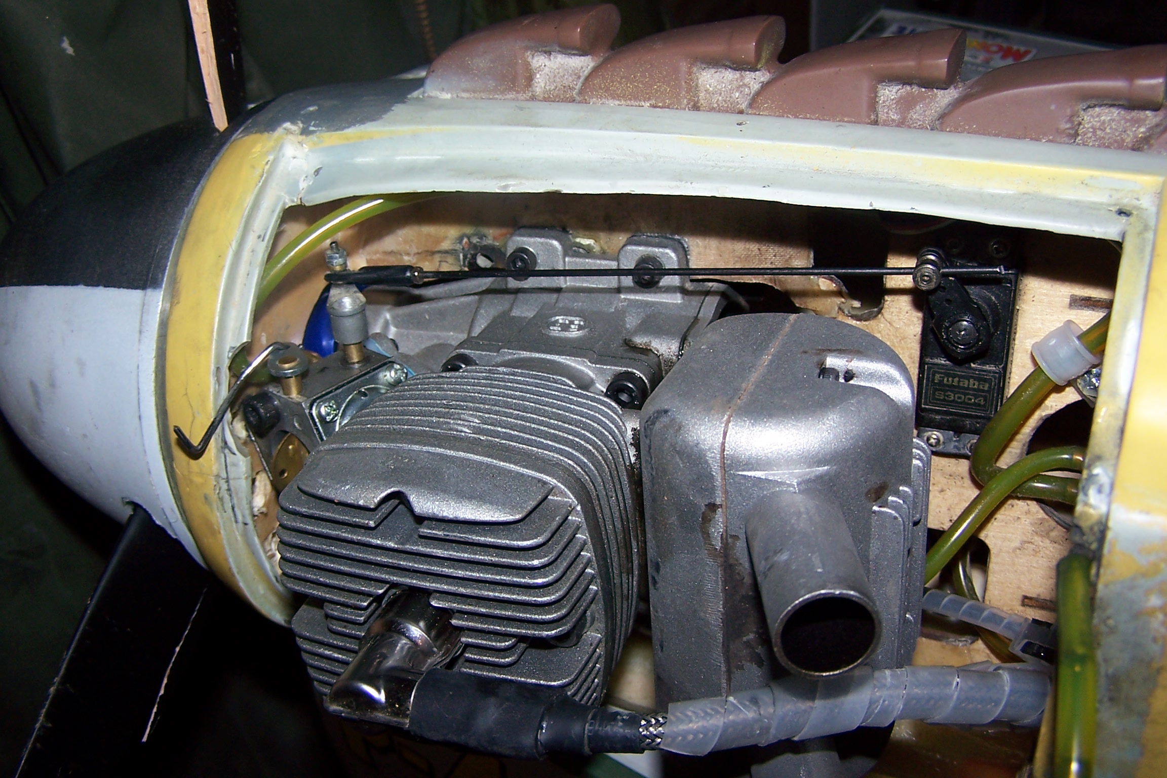

The wind calmed down around here and I finally got in four or five flights. However the other day, after I had landed with the plane idling, I gave it a little throttle to taxi, and nothing. All the other controls worked. Then throttle started working ok. Did trouble shooting, couldn't find a problem. Then yesterday while flying the 109 at about half throttle, it went to full power by it self. I was able to move the throttle control all the way forward and then back to get it to throttle down. Decided I had better land. On short final it went to full throttle on its own again. I went around. At full throttle it was steady and at idle, steady, but part throttle erratic. So I flew a high pattern, throttle to idle turning final, using a steep decent but landed on the mains and bounced, was afraid to try to go around what with the throttle acting up, and hit hard on then mains again. Bent one strut and broke the prop.
Post accident investigation lead me to believe that the throttle servo was getting too hot and caused it to malfunction. The servo is in the rear of the engine compartment, and the rear muffler of the HGH is near the servo. Also I found that the muffler was slightly loose allowing hot exhaust gas to escape no doubt adding to the heat. So I'm going to have to replace the strut as it broke as I was trying to straighten. Its made of aluminum. Since I'm not sure of the make of the retracts, maybe I can get some 160mm struts from Hobby King and use them. I'm going to replace and move the throttle servo to behind the firewall and use a long cable, probably Golden Rod.
The servo is in the stock location and the DLE 20 never caused a problem because its exhaust was up near the from on the side. I'll post pictures later.
irocbsa 06-05-2015 05:01 PM
Sorry to hear about your mishap. Your diagnosis is spot on. I had the exact same thing happen to the throttle servo on my P-40. I wrapped it in heat reflective tape and it still wasn't enough. I moved it inside the fuse and all was well. Good luck.

5 Attachment(s)
irocbsa, thanks for your thoughts, that makes me feel more certain about my diagnoses. The retracts are Sierras so I have sent an e-mail to them to see if I can purchase a new strut. The prop was an expensive Zoar three blade, which says something for the use of much cheaper two blade props, but then I would need a new spinner. So its just a matter of replacing two parts and moving the servo back behind the firewall. Could have been worse. http://www.rcuniverse.com/forum/atta...mentid=2100712http://www.rcuniverse.com/forum/atta...mentid=2100713http://www.rcuniverse.com/forum/atta...mentid=2100714http://www.rcuniverse.com/forum/atta...mentid=2100715http://www.rcuniverse.com/forum/atta...mentid=2100716

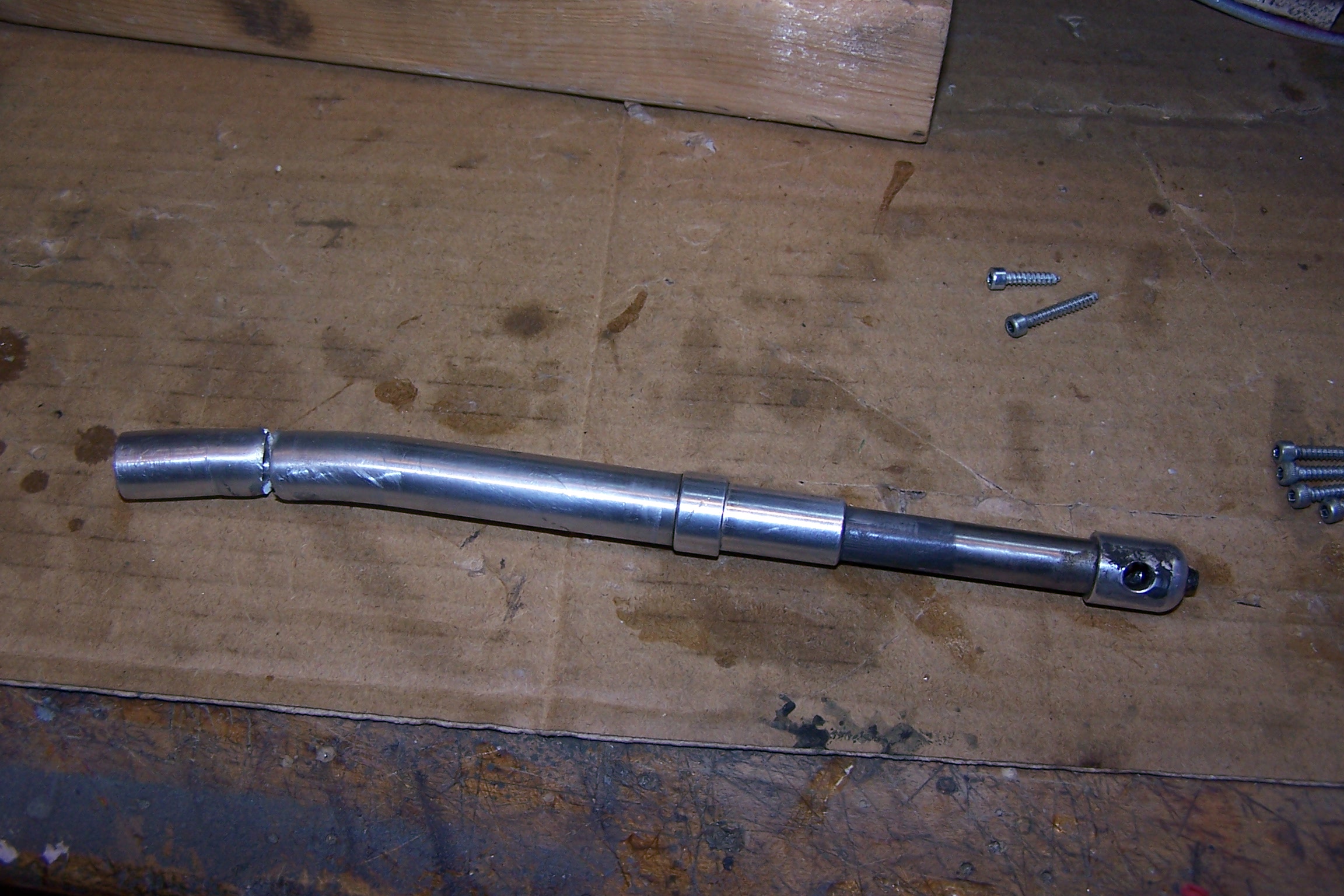

I got back in town and started on repair of the 109. It turns out the muffler was not loose, but broken. Looks like a design defect to me. Out to a welder who does aluminum, we will see. Darrell at Sierra Giant Scale got my strut repaired an back to me in two weeks. The gear is now reinstalled and operational. I relocated the throttle servo to behind the firewall to prevent this from happening again. I have 10 flights on the NGH 35 with no problems until the last one. So I suppose the broken muffler leaked too much hot gas into the rear cowl heating up servo causing it to malfunction. Another Xoar 17-8 three blade is on order but every website of those that carry it say "on back order" so no telling when if ever one will show up. I've got a Master Airscrew 16-10 three blade so I'll try that.http://www.rcuniverse.com/forum/atta...mentid=2103923http://www.rcuniverse.com/forum/atta...mentid=2103924

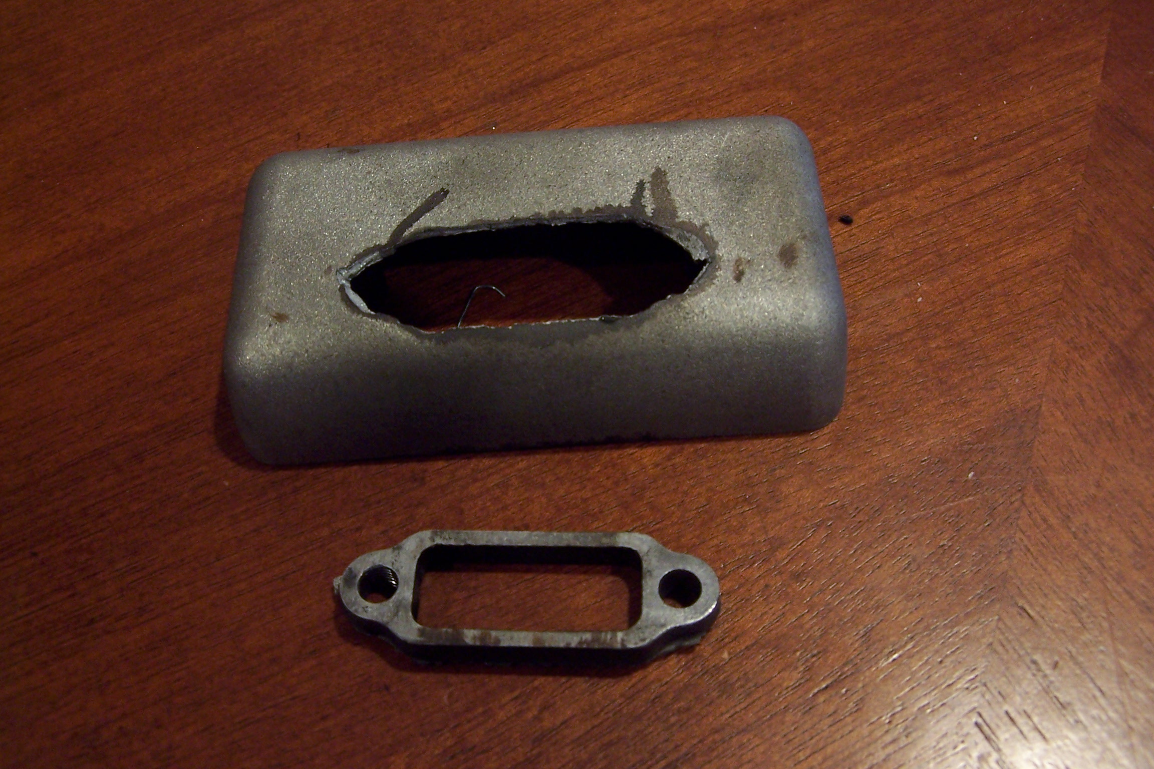

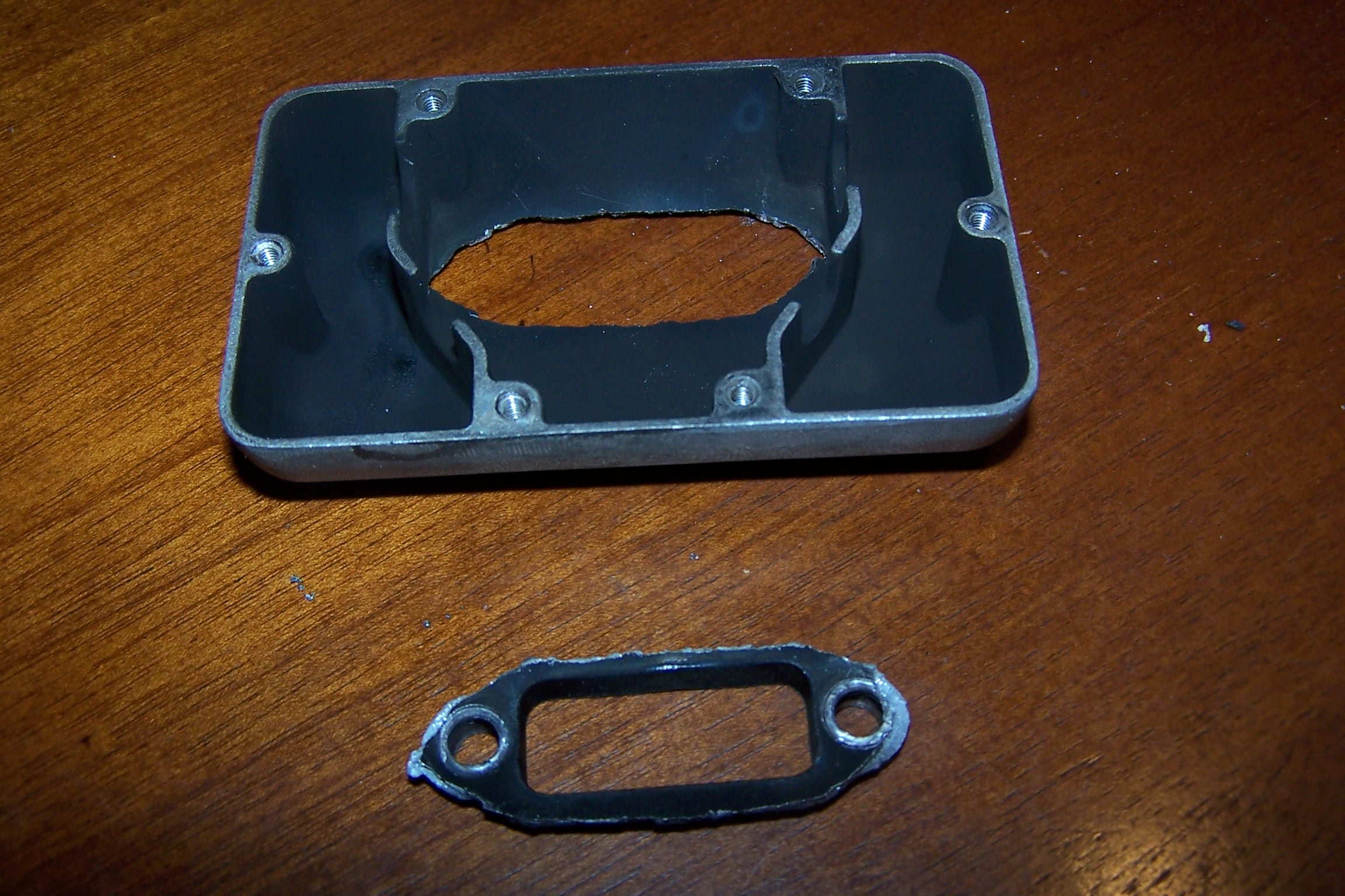

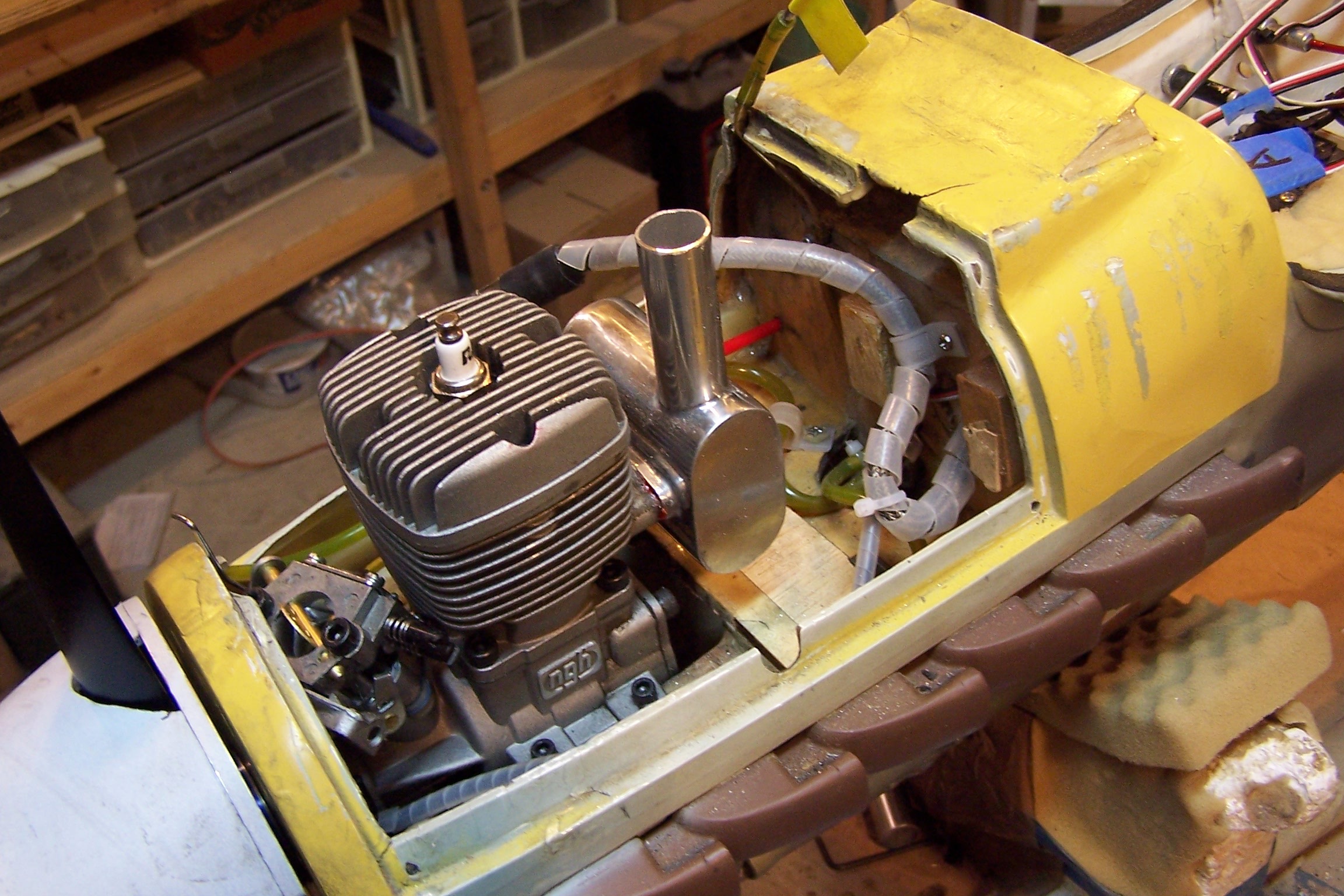

The 109 (or maybe NGH35) saga continues. I got one flight in chasing a Hanger 9 Mustang, or was it chasing the 109? Any way, the throttle was at mid range and went to full power by itself. Moved the throttle stick all the way up and back and had throttle control. Put gear and flaps down and landed ok. Once stopped no on the grass runway, I nudged the throttle to taxi off and went to full power. I hit full left rudder and it went into a tight circle while I hit the kill switch. Inspection showed the muffler was broken again. A club member said he had seen that before, and the broken muffler sets up a vibration the effects the throttle servo, even though it is attached by a plastic Golden Rod and not metal. I have acquired an after market muffler. It is smaller with no baffles so I'm sure it will be louder. Had to alter the cowl some, but not too bad. Have not run yet and no pictures.
RBean 07-04-2015 09:27 AM
4 Attachment(s)
Here are pictures of the new muffler. http://www.rcuniverse.com/forum/atta...mentid=2107468http://www.rcuniverse.com/forum/atta...mentid=2107469http://www.rcuniverse.com/forum/atta...mentid=2107470http://www.rcuniverse.com/forum/atta...mentid=2107471

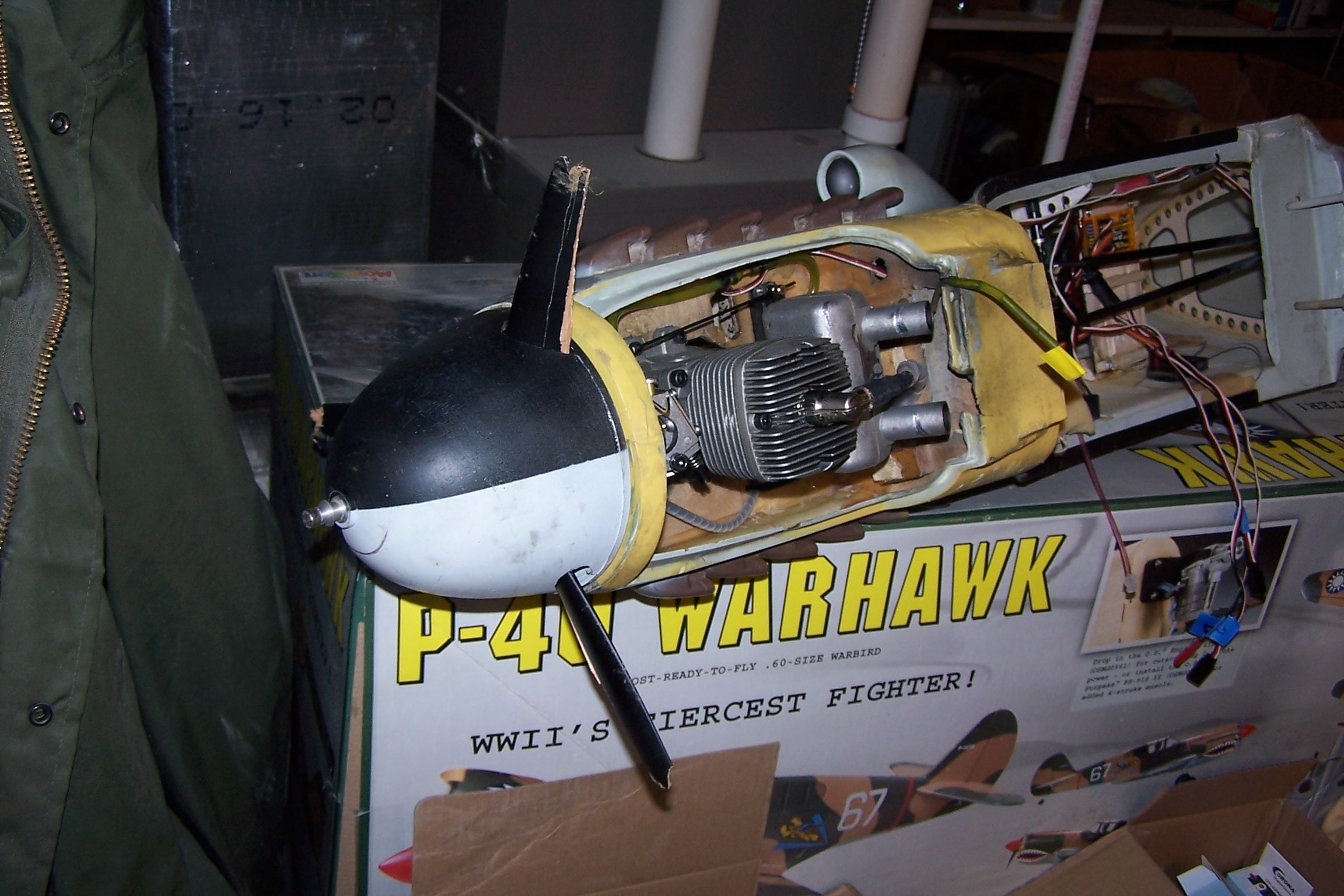

The 109 came to an end yesterday. I flew it for the first time with the after market muffler. Tacked at 7,600 rpm, so it lost a little power with the smaller muffler and more back pressure. However while getting ready to land at a high idle, I nudged the throttle forward and it just quit. I was able to land ok. I think it was just too lean on the bottom end. Changing the muffler effected to mixture. So I richened up the mixture, more on the low but a little richer on the high needle. Then fueled up and took off again. This take off was not as straight, but got off ok, but the engine was too rich, not putting out much power. Come around to get ready to land. On the turn from down wind the tail started osculating. Looked like the rudder gyro was malfunction. I was going to leave the flaps and gear up and belly her in. However, just come over the end of the runway, started going up and down and wing waggling the just rolled left and straight down. This was not a stall and snap, but an uncomanded roll. Hit just off the runway, engine at idle but straight down in soft mud. The plane is totaled, but engine appears to be ok.
I think the gyro malfunctioned and interferred with the receiver. This plane has been "snake bit" from the beginning. I'll put up a nice set of Sierra retracts up for sale. They survived the crash without damage.
