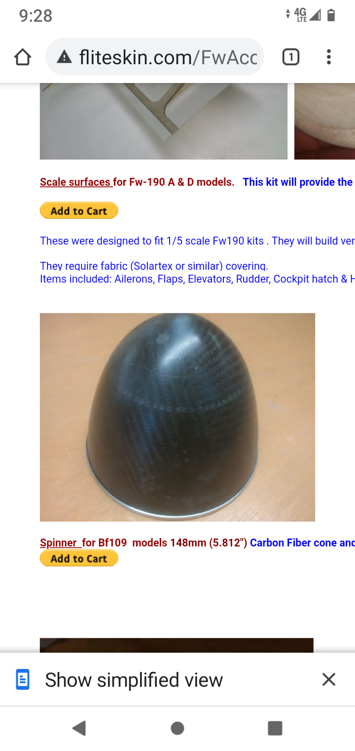

I order this spinner from Fliteskin in OR, don't know anything about them, does anyone have info on them?
Tks.
https://cimg3.ibsrv.net/gimg/www.rcu...54acdb1136.png
CARS II 05-31-2021 10:30 AM
I got an email reply today Monday, the spinner will be shipping tomorrow Tuesday :)
WWIIP38 05-31-2021 10:46 AM
I bought a couple of spinners from him for mine, when they were all aluminum.
Also bought a 1/5th scale SisT FW-190 A kit several years ago.
Quality products, good customer service.

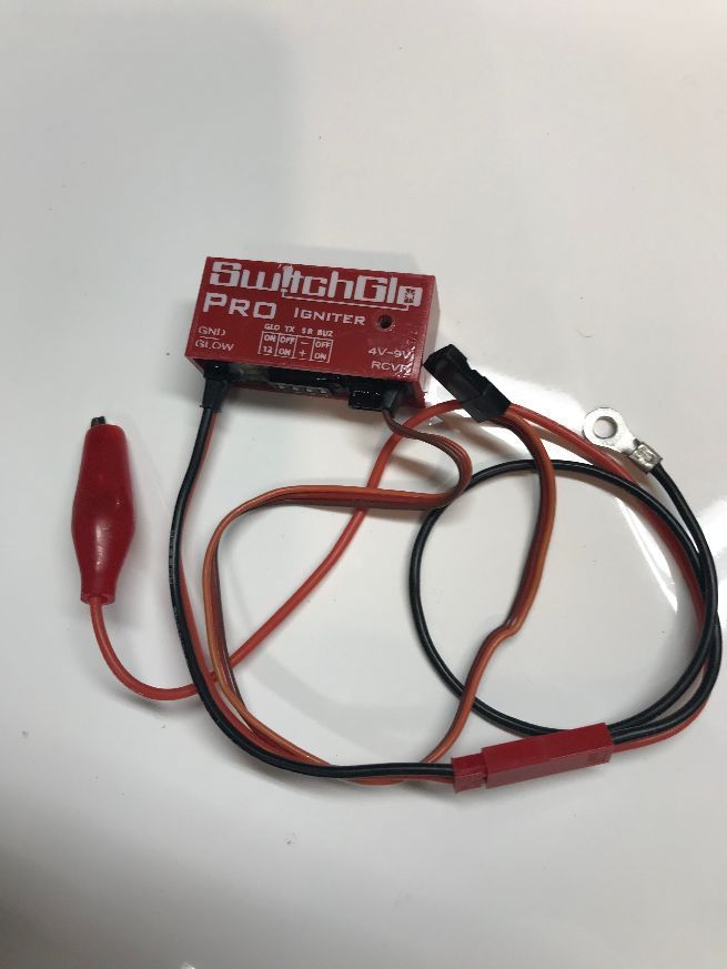

Do you have an onboard glow driver?
CARS II 06-05-2021 04:02 PM
No on board glow driver for this engine, I've used them on my OS engines before ( P47 ) this engine is holding idle around 2K, it doesn't look like it will need one, the glow plug is so down in the head that using a glow driver may be impossible, if the idle begins decade then, it's time for a new glow plug, keeping it a tad on the rich side will prevent the glow plug from been cooked.
WWIIP38 06-05-2021 04:28 PM
Personally, I always use onboard glow drivers for inverted nitro engines. They reduce the chances of flame outs at low rpm and allow for lower idle. I have used them on inverted YS engines using a small alligator clip to attach to the glow plug.
https://cimg4.ibsrv.net/gimg/www.rcu...2f909fb4b8.jpg

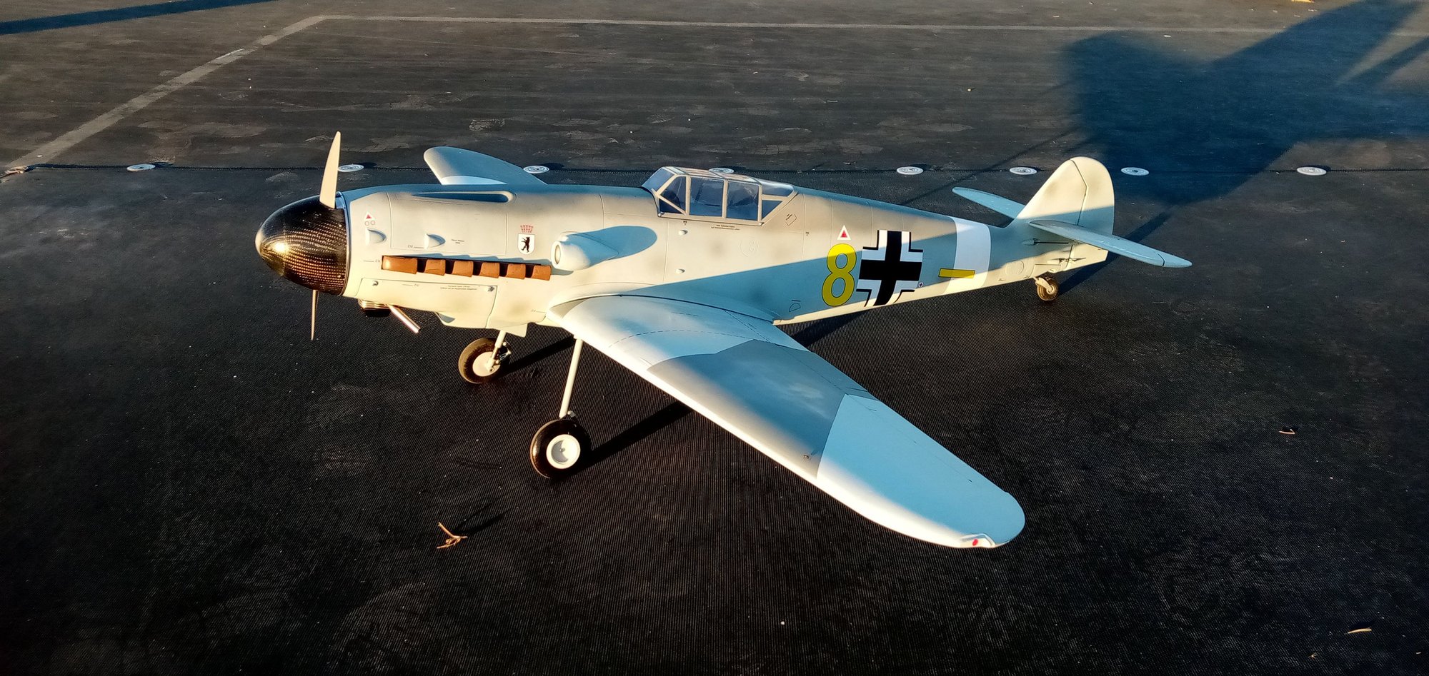

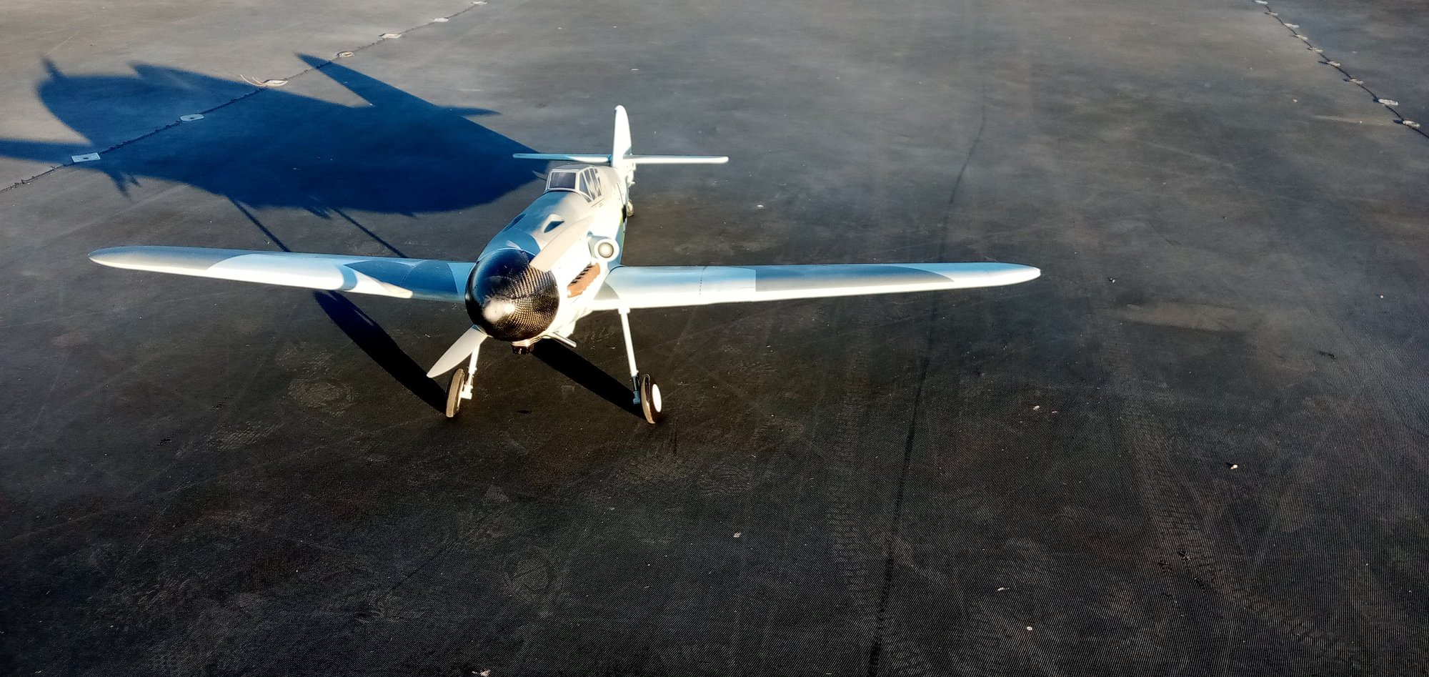

CARS II 06-12-2021 10:01 PM
Well, I finished the ME109 at my field today, we had warbird event today and decided to finish the 109 at the field and I did, it only needs a few more minor items, like painting the spinner spiral.
I got to the field around 10 am and worked on the 109 till 6 pm.
The maiden flight was a piece of cake, the CG was right at 110 mm, the TO was so straight that I felt like this airplane had flown before, plenty of power out of the YS120, the landing was straight forward, just have to keep the power on because of the airbrakes.
