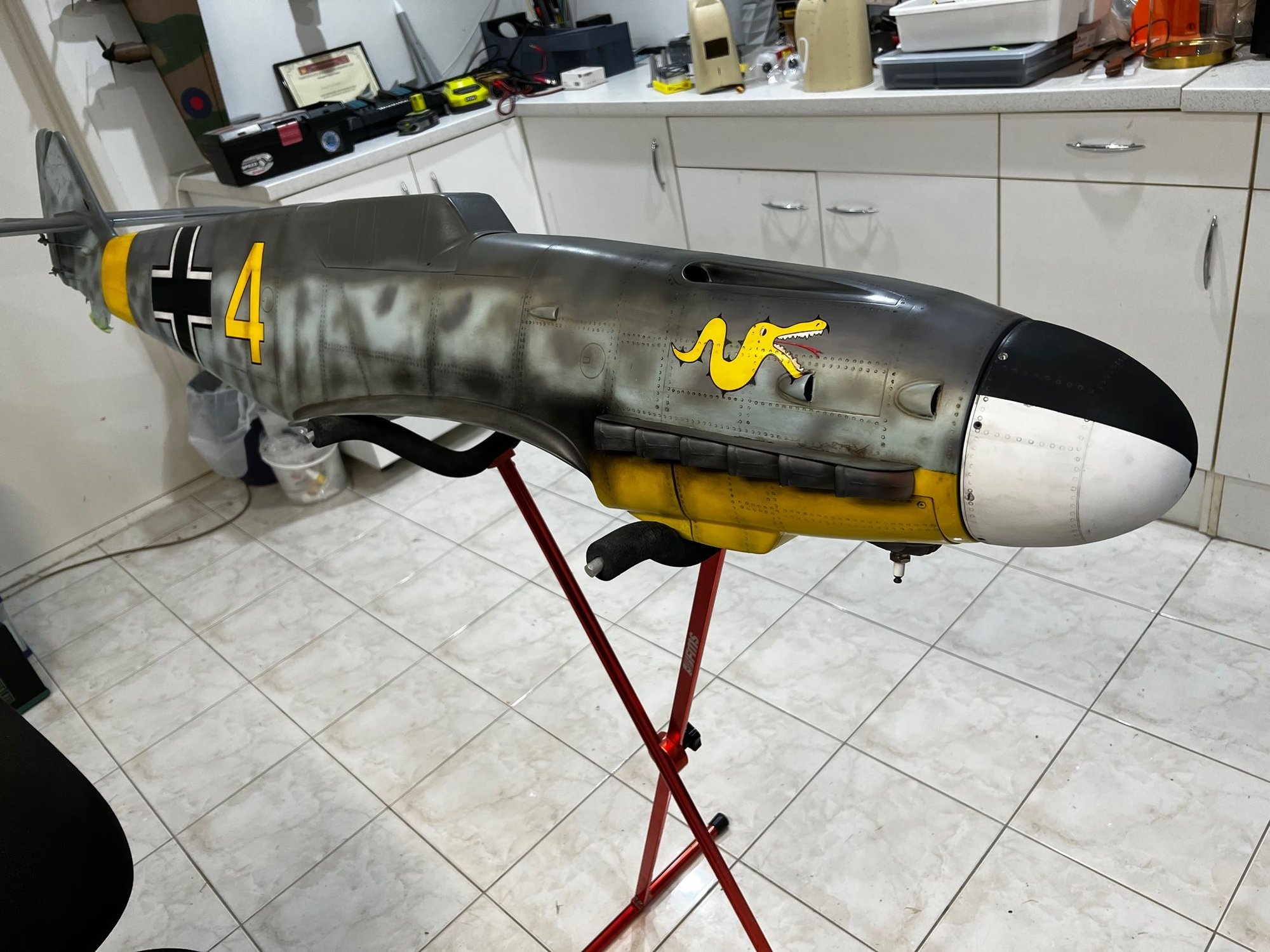

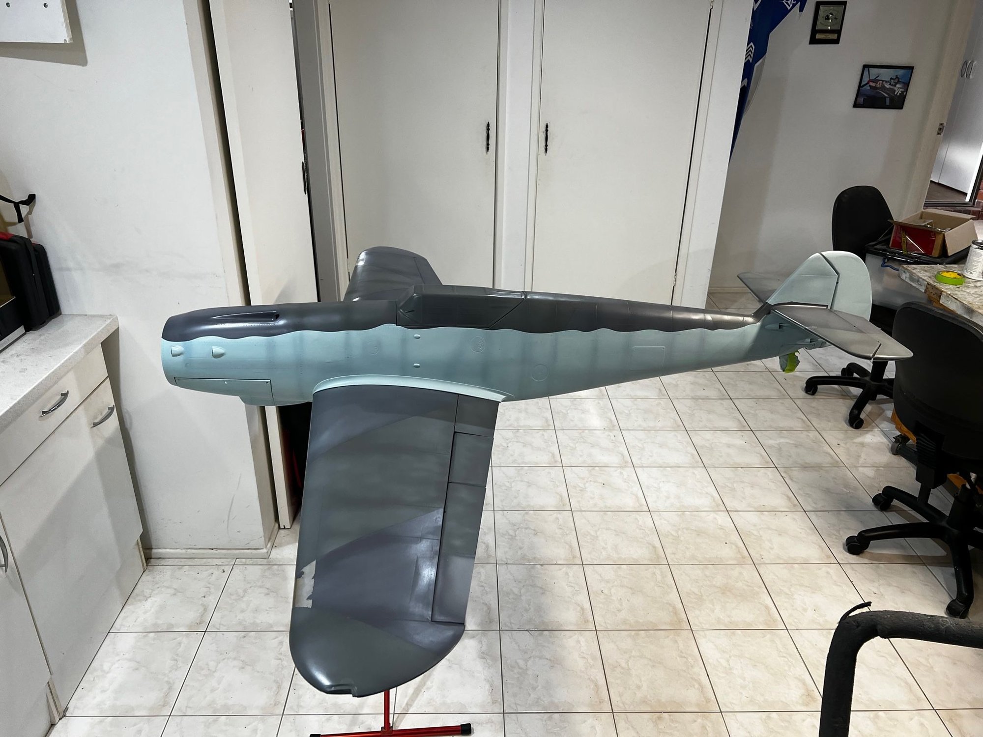

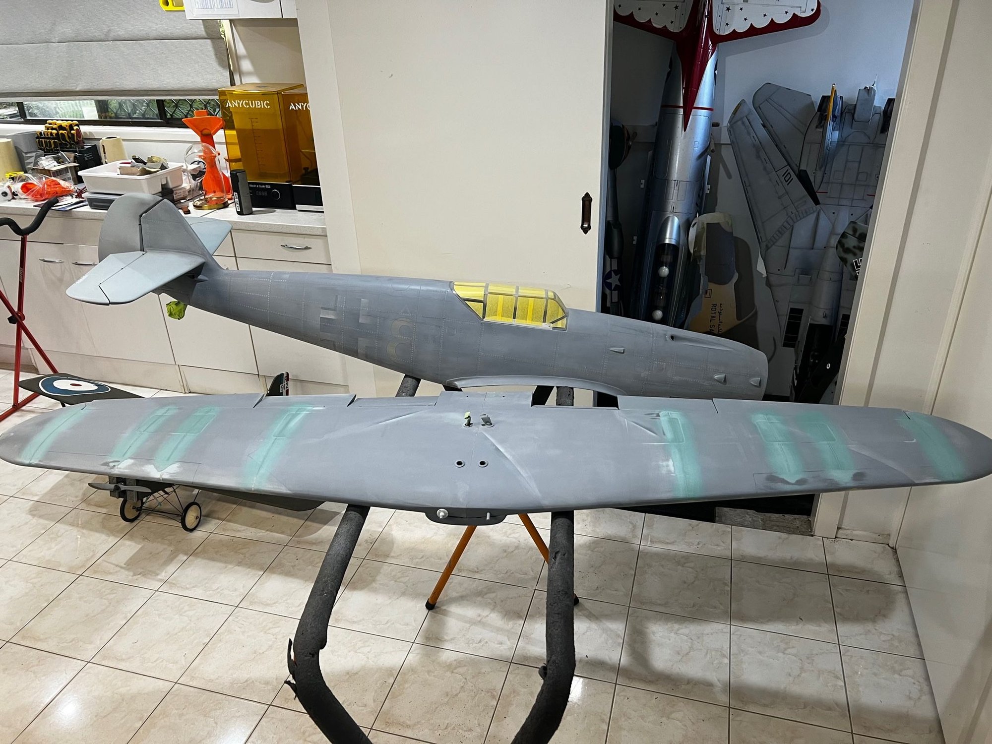

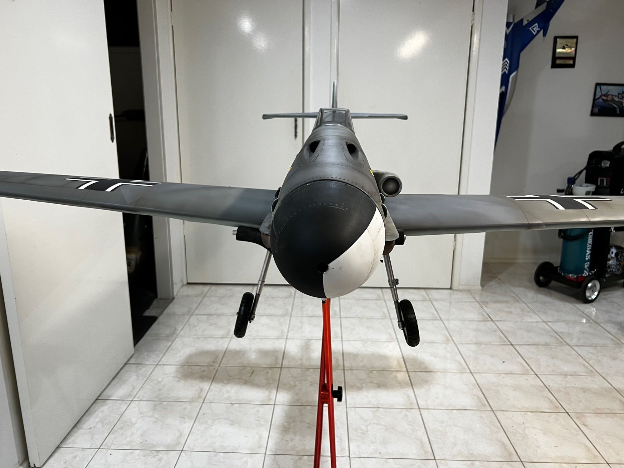

Long time since's i've updated this thread, but in the last couple of weeks I have made strides forward on the 109 project. I added rivets to the entire fuse, and panel lines added to the wings some time ago, as well as the exhausts and supercharger intake relocated, landing gear relocated, and new tailwheel. The model was just waiting on the final landing gear bay mods to be done and to make some mod's to the set of sierra's retracts i have for it. Since I last updated on this post I also had a new canopy made by a local modeler who does this and makes spinners in his spare time. The canopy is so much clearer and more durable now.!
So fast forward something like 612 months later and After re-painting a 132" B-17 for a mate, It got my painting juices going and I looking at the 109 being so close to paint made me decided to paint and weather the 109 as well. Paint is my now standard PPG dulon acrylic paint, and top coat is a 2k clear for a nice flat and durable finish. weathering is done with a range of products. All the markings are painted on. the only stickers that will be on the model are going to be the swastikas (which had already been painted on and then sanded off) do to some changes in laws here locally.
Now as time allows and realistically around other projects, I will be installing the last of the gear and getting it closer to being ready to fly. I have everything I need to complete her here already, just need the magical item.... time.

BJ64 06-24-2023 04:06 AM
Lovely work, Mate 👍
joey_snaproll 06-24-2023 07:15 AM
Cmp 109
Nice job, the 109 just looks so much better with the weathering Makes me want to bump mine to the front of the line for finishing, not easy having airplane A.D.D, but do have a good museum of planes hanging in the garage. And It does have a built dynamic bf-109 and my Parkzone me-109z.
this would look good though.
great job , your buddy with the spinner , did he make a mold and do a fiberglass one with aluminum back plate?
can’t remember was the consensus , was the kit spinner with aluminum back plate good for electric , but replace for gas/glow?
post some video of flights would like to see that.
Joe

Thanks guys. getting all the servos setup now but have also decided to part ways with the RCGF 26cc engine i have in it and replace it with... a RCGF 26cc rear exhaust :D even with a pitts muffler I would have to hack into the cowl more than i want to.
Joey, Russ makes an all aluminium backplate and a spun aluminium dome for the spinner. shouldn't explode.

I picked up one of these ARFs NIB with a TY spinner and Sierra retracts for $250. One issue is the TY spinner has no cut outs for the prop, what tools and method did you find worked best to get this accomplished.
After inspecting the kit I found the wheel wells unusable due to being crushed. Any one have assume extras to sell?

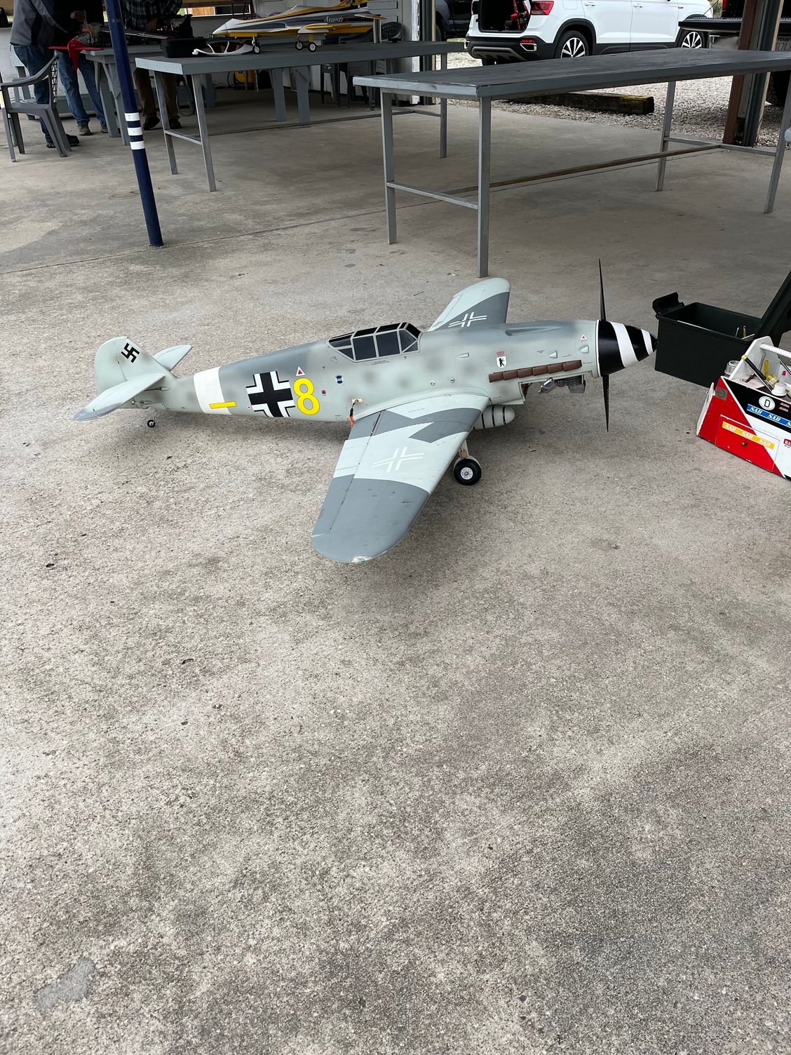

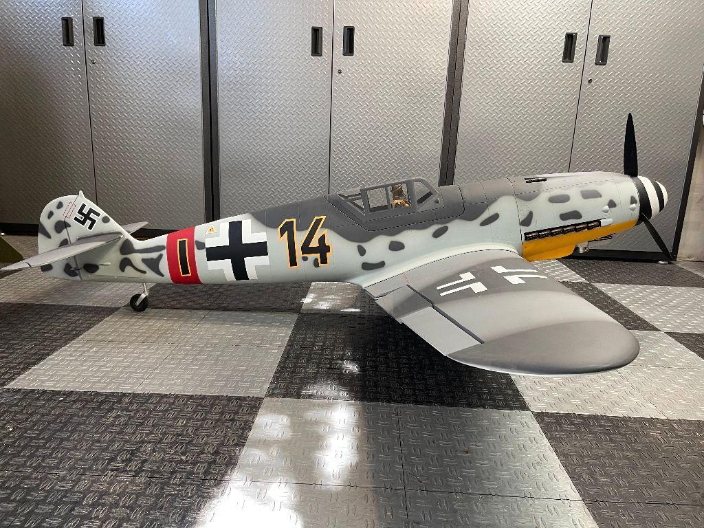

WWIIP38 07-16-2023 07:07 AM
You got a great deal!
For the spinner cutouts I make a paper template then trace around it. To cut out; a dremel with cutoff wheels and grinding attachments works well. If it's aluminum a sheet metal nibbler can also work.
Wheel well liners can be easily made using plastic cups.
