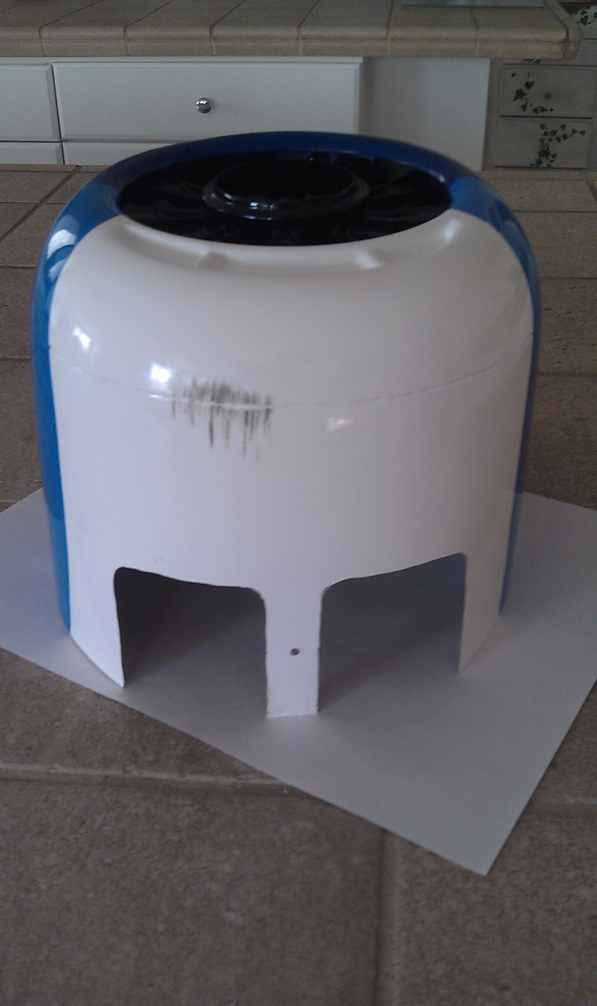

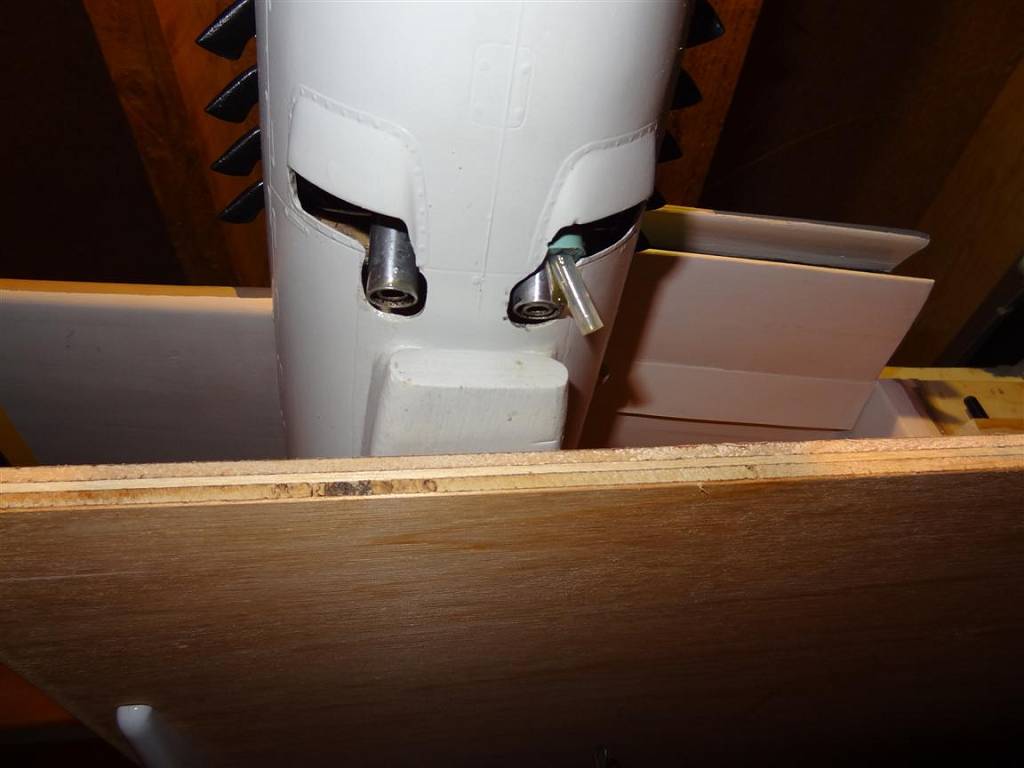

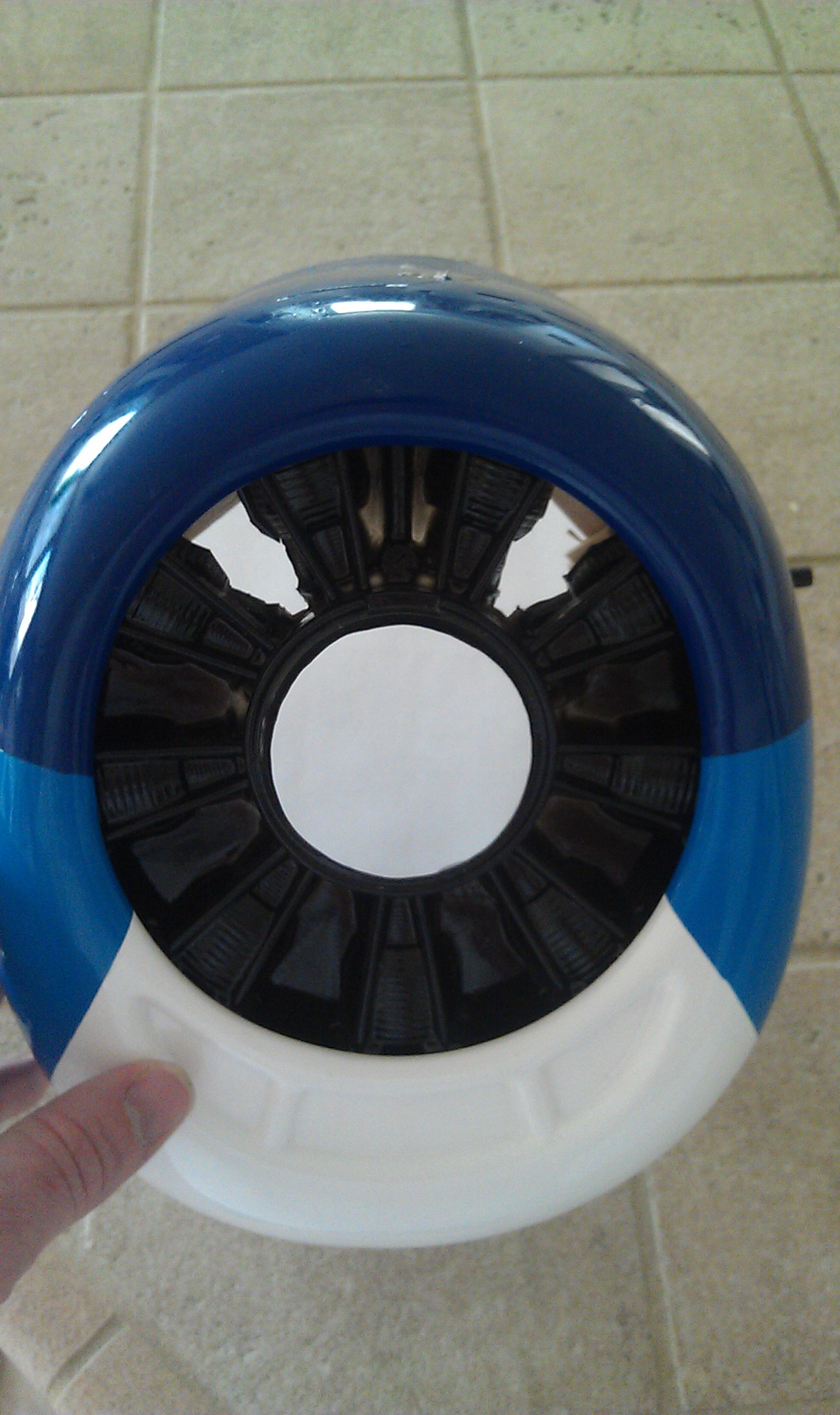

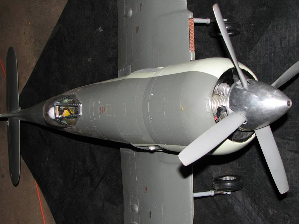

I have a 90SP in a H9 Hellcat. I cutout between the top two dummy cylinders in the dummy radial face. Then built two scoops in the inside of the cowl to redirect down across the engine. Then two big cutouts in the bottom rear to exit. The dimesions are roughly the 1 sq inch in and two out as recommended. Yet it still overheated and quit on the first flight.
I could tweak the inlets and stuff more but I have seen references in forums about big radial engine planes not being an issue like the tightly cowled ones (Spits and Mustangs). I haven't found any details as to why that's the case. Now I really don't care that much about a truly scale appearance and so I'm wondering if just removing the dummy engine (or a portion of) would solve the problem.

For efficient cooling you must have air coming in but you must also provide a way for it to exit too. Where can the air exhaust from? Usually the exiting air from the cowl needs aprox 3 times the area of the inlet to flow efficiently. Can the air exit around the cowl along the gill flaps on your model?

Hoggle can you take and post pics?
Try flying it 1 time without the dummy engine cover and see if the 90SP performs correctly; it may have died for other reasons than overheating.
ps. I thought the ratio was 1:3 not 1:2? I've always read to give 3X the exit area as compared to intake area for proper cowled engine cooling. But try flying it 1st without the dummy engine cover and make sure that airflow is really the problem... actually you shouldn't even have to fly it just running it up on the ground for a few minutes standing with your legs in front of the hoizontal tail fin to hold the plane back should tell you alot. And post pics!

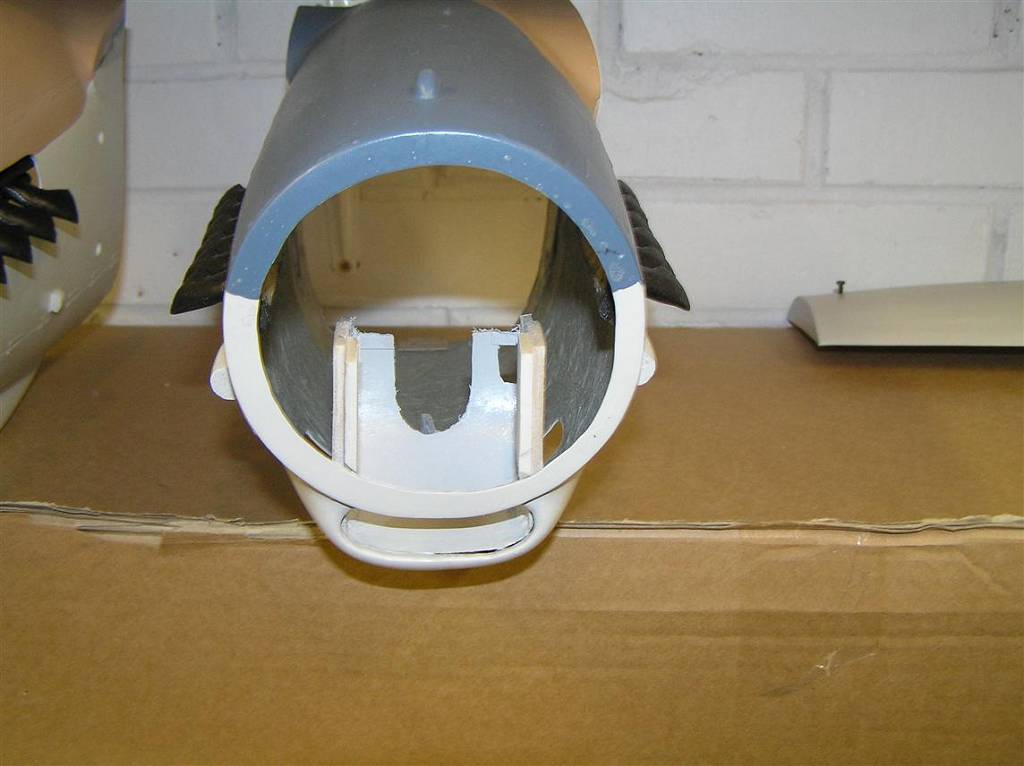

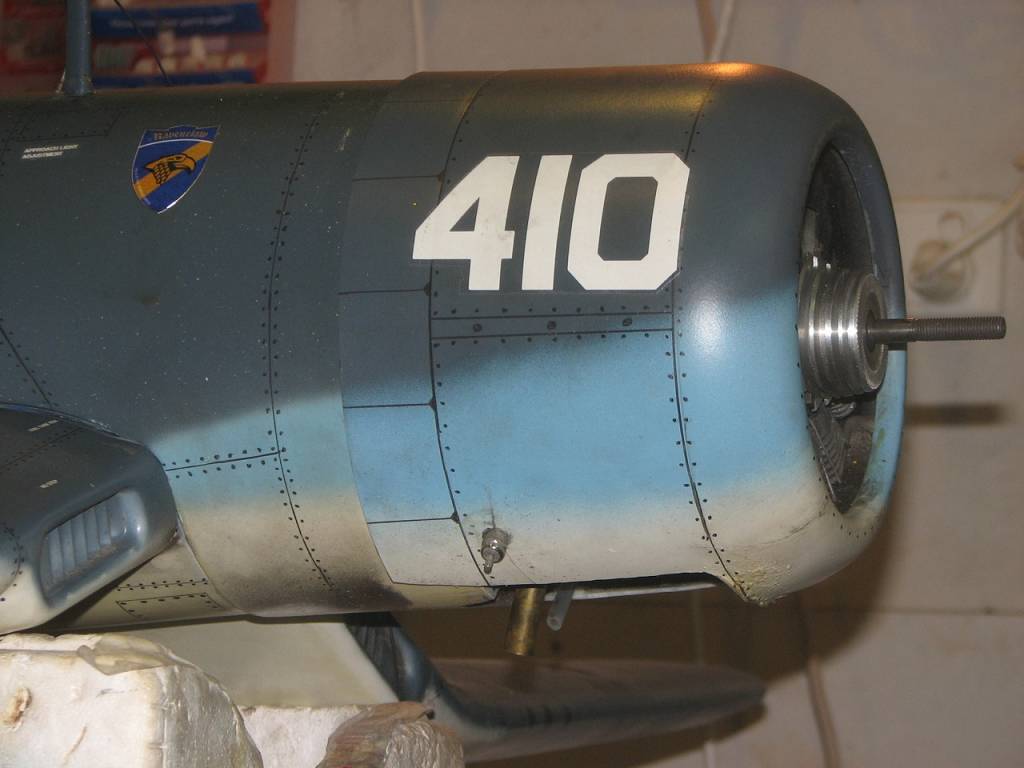

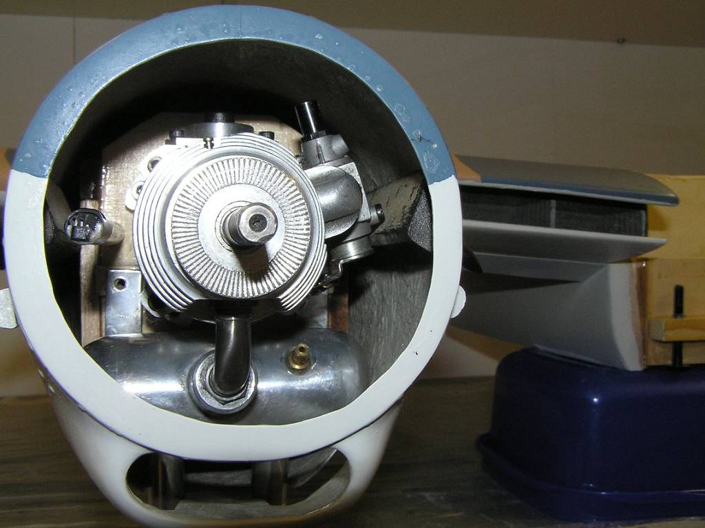

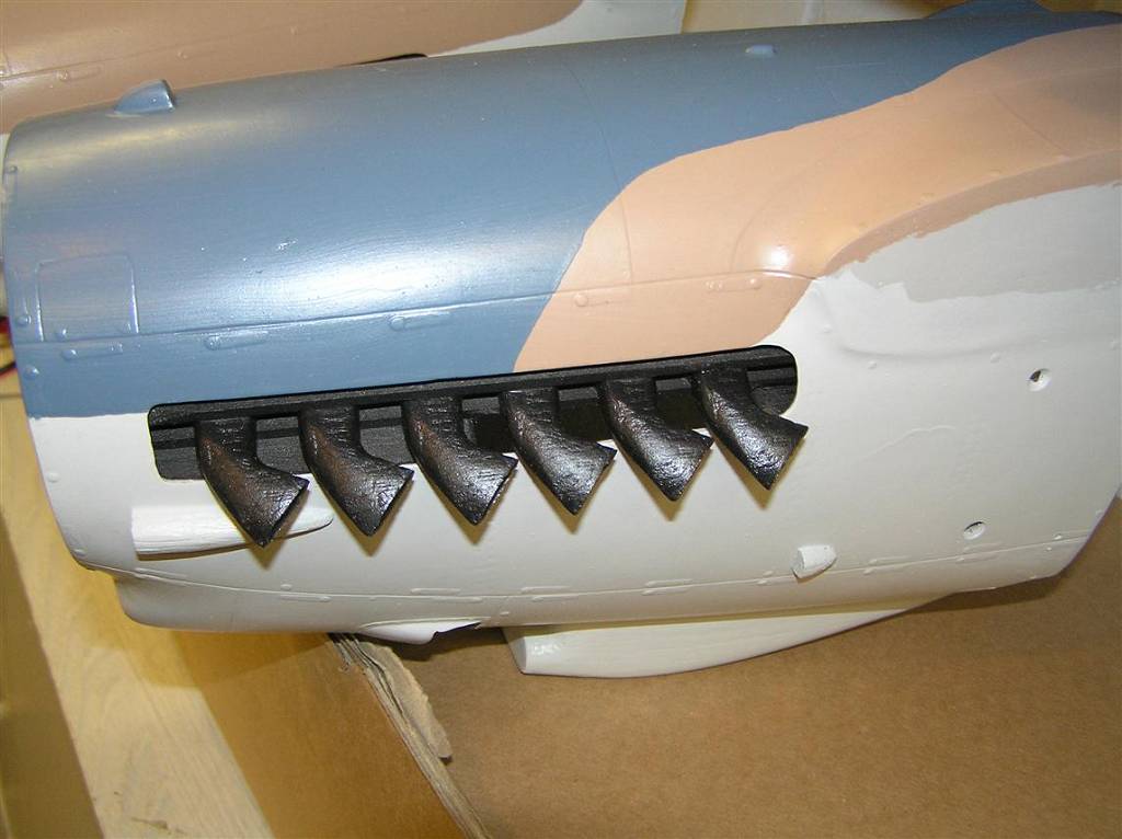

Here is the Corsair setup.
The ABS cowl did not stand up well to the vibration over time, and the baffle was not as efficient as it should have been, due to it not being close or tight enough around the motor.
You can see the lip created in front of the eflux hole which was just heated with a heat gun and bent. It did make a difference but I was having other issues with the 120SP and the Corsair now has a Saito 125 in it.
The 120SP was a loverly engine and pulled the heavy Corsair like a freight train. Not fast but with heaps thrust.

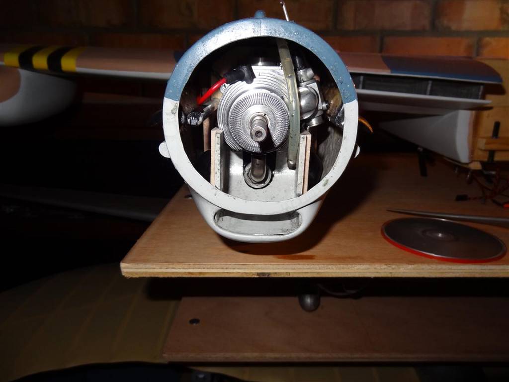

Joined: Jul 2007
Posts: 559
From: BouldercombeQueensland, AUSTRALIA

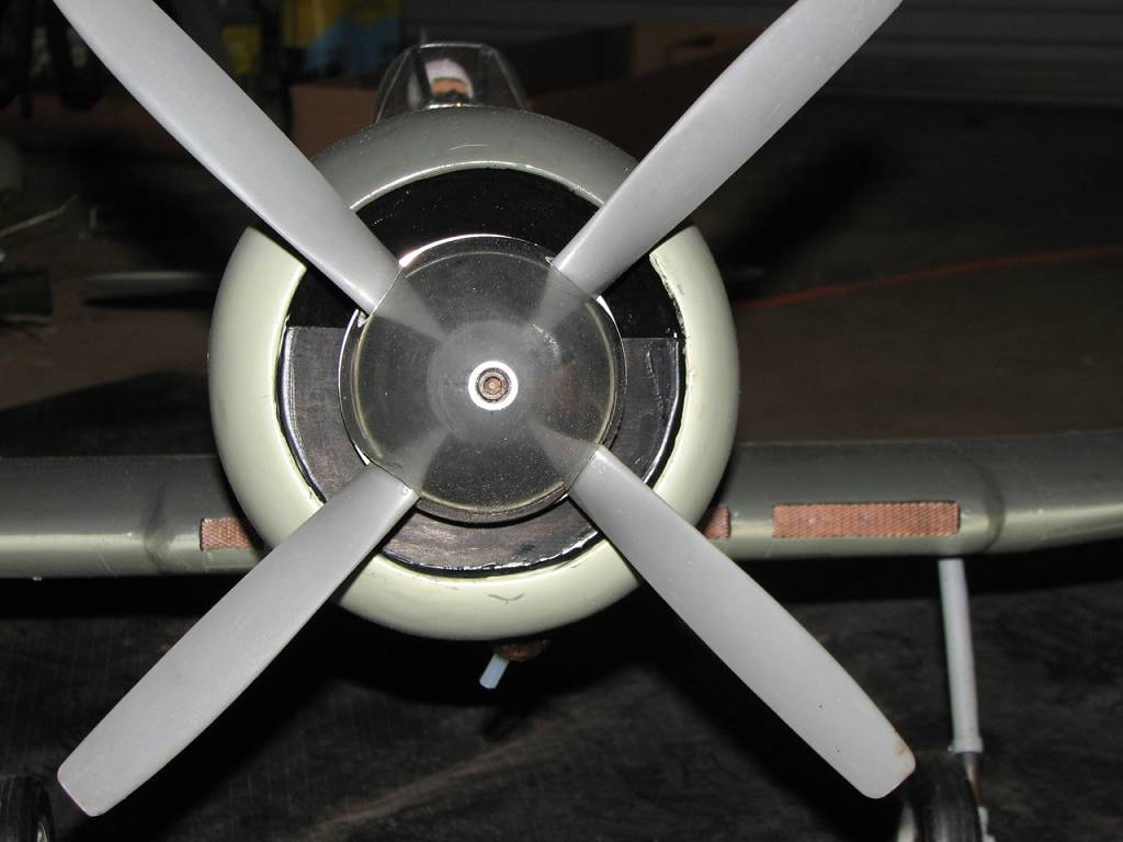

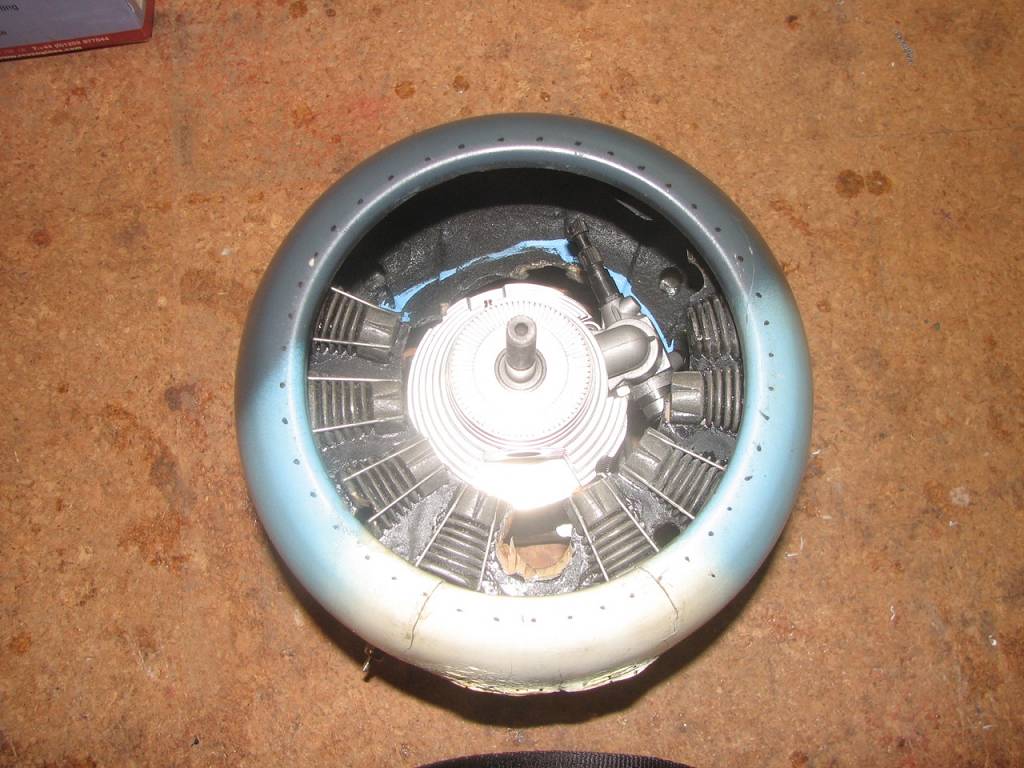

The Sea Fury is a more recent build with the 61SP in it. Just enough power but good scale flight.
It took 3 goes at the baffle to get the right shape and get it close enough, although I could still probably improve it.
What I ended up doing was carving a piece of foam I had shoved into the cowl until it was the shape I wanted, then glassed it, dissolved the foam, then bonded the baffle to the inside of the cowl. Apart from the carving time it was pretty quick and easy.
Air doesn't like going around corners so you have to think of it as forcing the air over the fins, cause it won't do it on its own.

I agree! You need to open up a few more slots in your dummy raidal engine plate around the top! Your exit areas look ok, but not enough inlet area there.

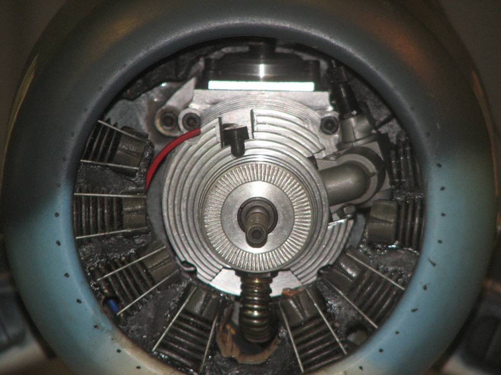

I am not sure that the air scoops will keep the air flow in the cylinder, the Weston UK site has some pictures of the recomended air scoop and this shows how th4e air is forced to flow through the fins as the side plates capture the whole engine.
[link=http://www.westonuk.co.uk/westonuk2_036.htm]WestonUK RCV page[/link]
On yours do the side plates but right up to the engine fins, if they do not then the air can escape around the outside of the fins. Additionally, if the end of the surve does not fit well against the fins then the air can escape backwards. Finally, with the V formation some of the air could short circuit out of the top of the fins, I would consider a blanking plate between the two air scoops to prevent this.

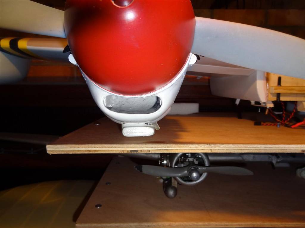

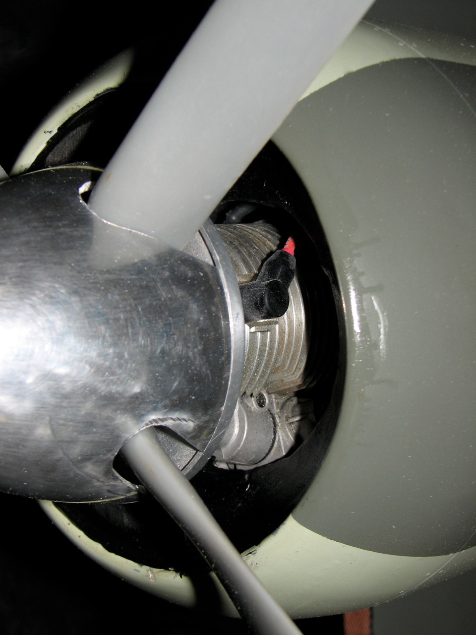

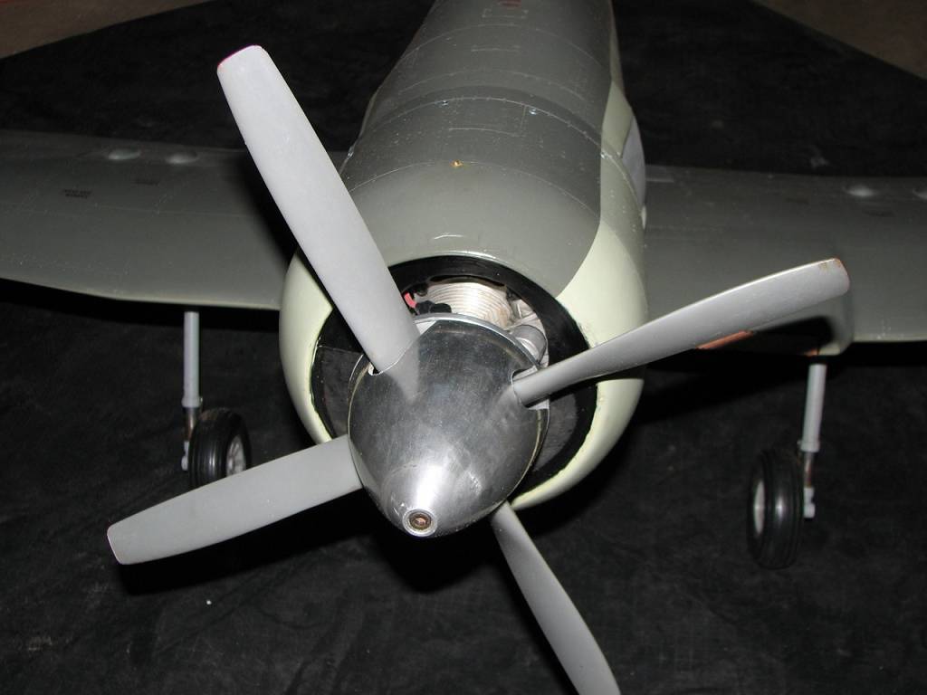

I have a pair of RCV60SPs in my Mosquito (I know it is not radial cowl but it is another example), I go in through the scale air scoop on the cowl chin, have a curved air scoop with side plates that fit closely to the fins so all the air flows upwards through the fins, it then turns around in the top of the cowl and goes down around the crankcase, some of it spills out around the scale exhaust slots and some carries on down around the WestonUK in cowl silencer and through a slots by the model exhausts. This works well and as the Mossie is 18-19lbs in flying condition the engines have to work hard.
The photos show
1. The air scoops in the cowl along with the mounts for the exhaust stacks
2. The cowls in place showing the tight fit between the fins and the air scoops so all incoming air has to flow through the fins
3. The air inlet into the scoop in the cowl chin
4. The air outlets at the back of the exhaust stacks which are by the side of the crankcase, as these holes are at the bottom of the exhaust stack the air has to flow through the fins and past the crankcase before exiting
5. The slots in the bottom of the cowl to ensure some air flows over the in cowl exhuast.
6. Shows the engine in the cowl without the scoop showing the in cowl exhausts.
Peter.
