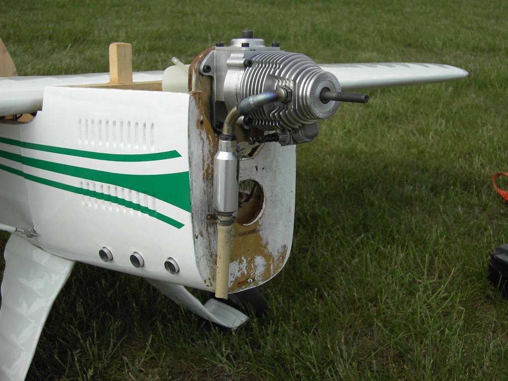

Here is a pic from the installation of the 120 SP in my Chester Jeep. Its not ideal since the firewall is supported from only 3 sides due to a big hatch. Firewall is 6mm ply glassed to the fuselage. The firewall is sandwiched between motor and the alu backplate.
So that works fine, its rigid enough.

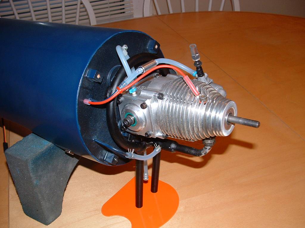

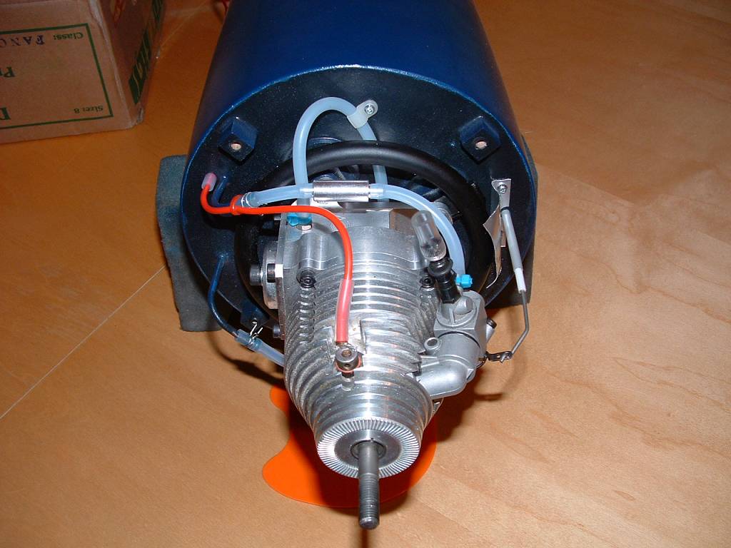

I have more then 3 gallons of fuel through mine on the bench, and it has calmed right down. When I first started and ran the engine for the first time, it would vibrate my field box right off the table. but now she runs quite smooth. It seems to be a 3D vibration coming from the torsional force of the prop and the unbalanced force of the piston and crank counter weight. I did buy a Great Planes rubber fire wall mount but have not tried it yet. The rubber grommets are very stiff with large mounting hardware. I know it says not to use one of these but what other choice do we have.
here is my set up on a Top Flite Corsair.

I guess what could - could
work is to mount the engine on the firewall, and to have the whole firewall vulkanised into the fuselage.
So there would be only little way for movement, but the rubber could take some energy.
Do you start your engine with the adapter, from the side?

yeah, I rotated the lower half so the socket is on the side, just for my preference. I really love this engine and plan to buy another for my P 47. Once it's broken in and tuned it's one bad mother, swinging an APC 15.5x12 4 blade prop at 5800rpm.

Good eye, believe it or not it is a wheel collar with a wire soldered onto it. I used a small fiber washer to space the collar off the plug and use the set screw to hold it in place. so far I have had no problems. I kept reading stories about regular plug caps falling off, and this was one of the cures mentioned. simple, give it a try.
