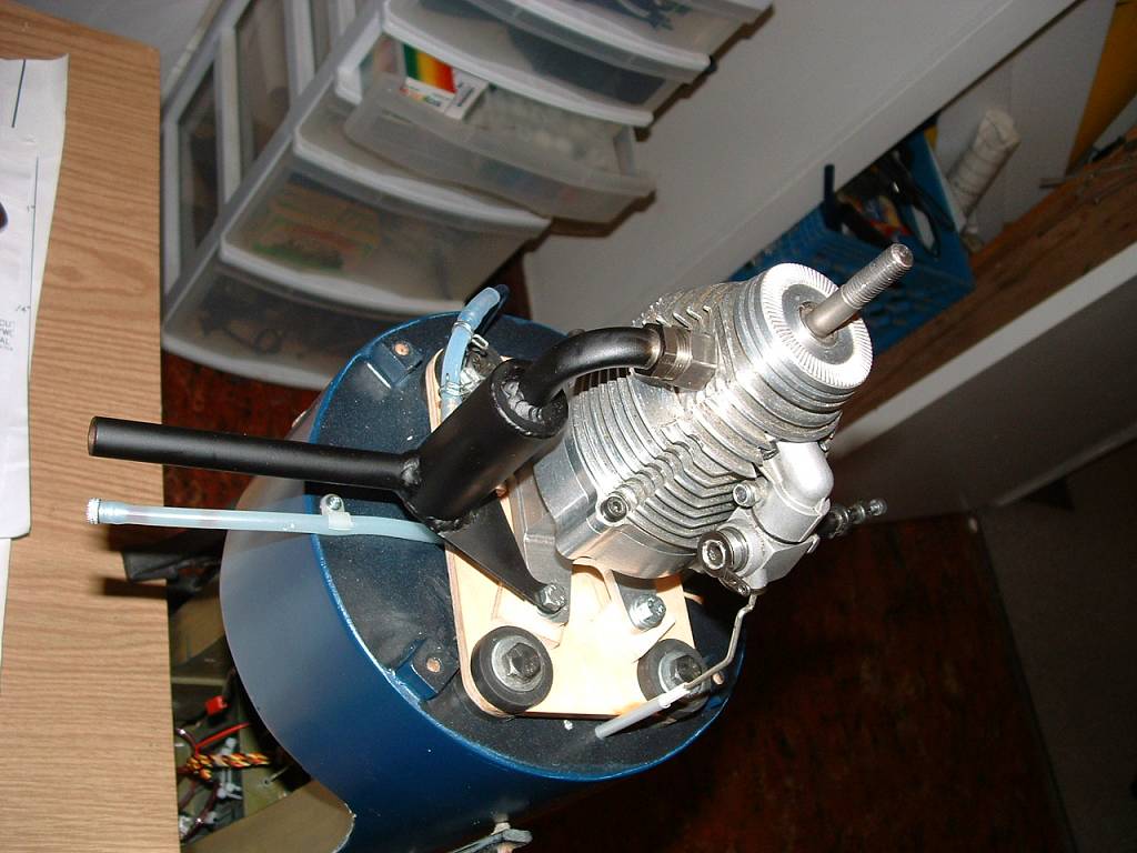

I bought it from Keleocreations.com It was redesigned and this is it. very high quality and outstanding service. $105.00. check him out. the first muffler had a ring and two down pipes and failed due to the vibrations from this engine. the new version is steel with a simpler mount. It also comes with an adapter that screws into the exhaust port, then the muffler threads to that.

Yes, the back of the muffler has a bracket welded to it that uses the lower mounting bolt holes on the engine so it does not move. I have run this set up with great success and It sounds awesome.
Although my engine configuration may be different then yours, (starter on the side) Let Kelvin know when you order, (stock or rotated). He made the bracket to fit my setup.
