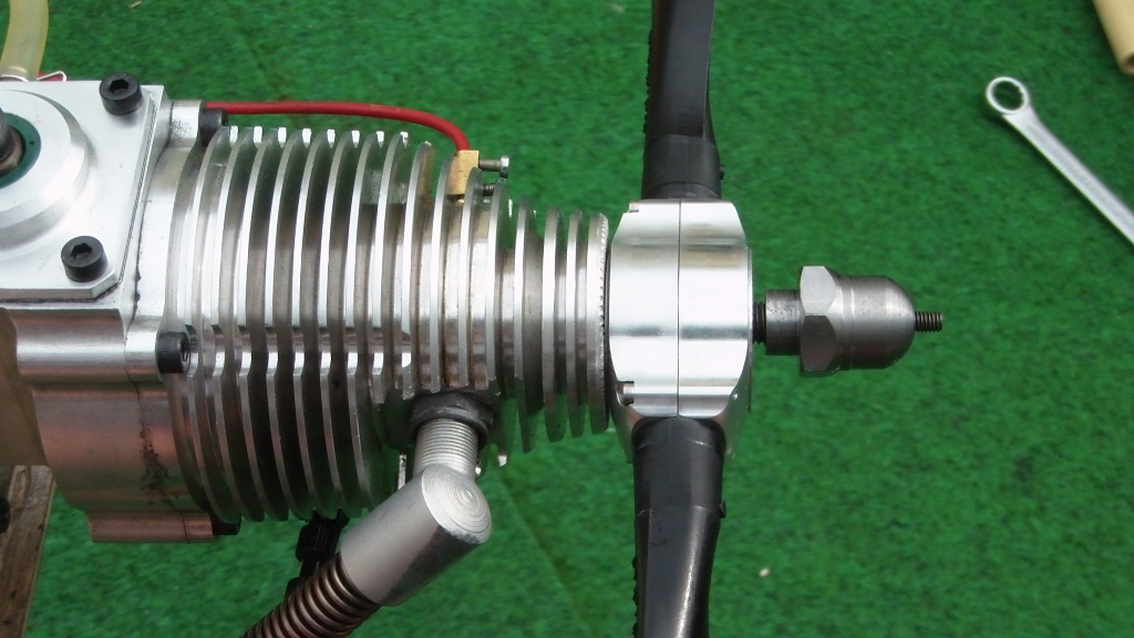

Received my 2-blade hub today, a spinner nut for the 120SP together with a pair of 19,9 inch and a pair of 17,9 inch SG blades. Quality is excellent, did not weigh yet but its low. The parts go together easily. I found that the crank is too long for the spinner nut (or the spinner nut too short), when the spinner nut is screwed fully in there are 10mm way to go to the prop. Contacted Mr. Ramoser, he offered to make a centering sleeve so I can get rid of the spinner nut (which is a heavy part) and use the original RCV screws for mounting the prop. As an alternative I think about removing the blunt end of the spinner nut so it can be screwed farther. There is no corrugation, neither on the rear nor on the front side of the blade hub, so I think I prefer the original lock nut.
regards
Andi
regards
Andi
Join Date: Aug 2007
Location: , AUSTRIA
Posts: 71
RE: Hope for Scale Props for SPs

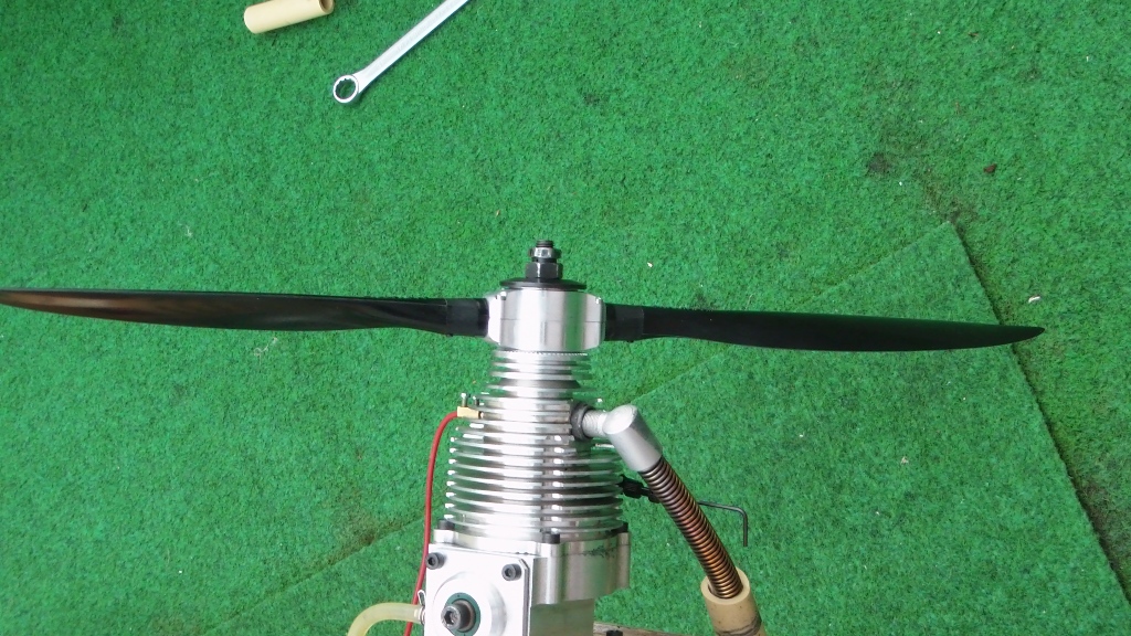

Today I made the first test runs. As planned I removed the originally prop nut and replaced it by the centering sleeve. Before mounting I balanced the prop and found it well balanced - no surprise, since the hub is CNC milled and the blades have the same weight. Well, the prop turned, , tracking of the blades is perfect. As expected the hub gets pretty hot, after a few minutes run you cannot touch it anymore. Since I have used GFK propellers before (Biela) I do not expect any problems. Nevetheless I will ask Mr. Ramoser about his opinion. Next step ist to adjust the correct pitch, that will need some test flights. The blades are very thin, similar to APC, so I hope for high rpms and maybe slightly more pitch than the APC provide.
Below some pics of the original setup with spinner nut, which turned out to be too short for the crank of the RCV.
Next is the mounted prop with centering sleeve and the RCV lock nut.

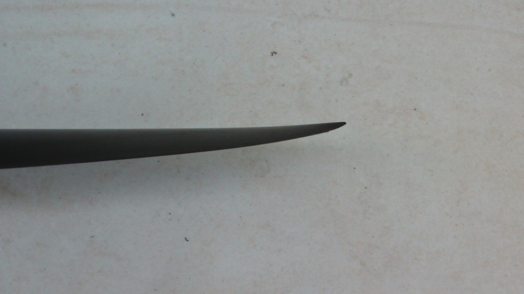

And last is a pic of the blade, seen from the side. The tips of the blades are bent forward, for whatever reason.
The weight of the blades+hub is 104 gramms. Togehter with the prop nut its a 140 gramms, another reason to skip the prop nut.

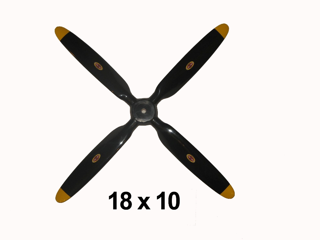

Just another source for a scale prop for the RCV SP series engines. I ordered a 16X8 and a 18X10! These are very wide and semi-scale to that of a Hamilton Standard prop, found on the P51 (Note, not all P51 had Hamilton Standard Props) Now which would you think would the better of the size???

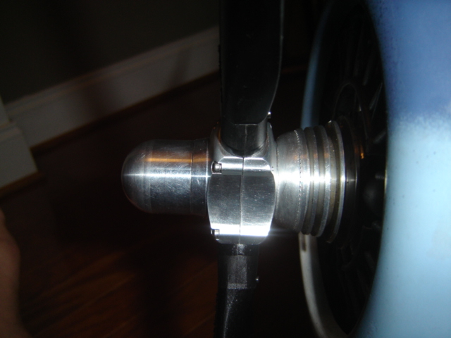

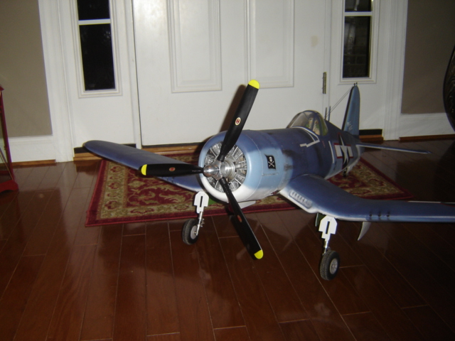

I just bought the VarioProp 16D 3-blade hub with 18.6" round tip blades for my TF Corsair. I used a slightly different method of marrying the hub to my 120SP. I designed a spacer to fit behind the hub, with a 12mm dia. flange to fit into the back of the hub. The setup works great. I set the pitch at 12" and ground tested it today. The 120SP turns the prop at 4660 rpm. As with your hub, mine got pretty hot but the blades were fine. I believe we've found a winner here and this hub looks great!
I like the idea of the aluminum spacer behind the hub. Adds just a little bit more heat disipation and moves the blades just a bit farther from the glow plug.
