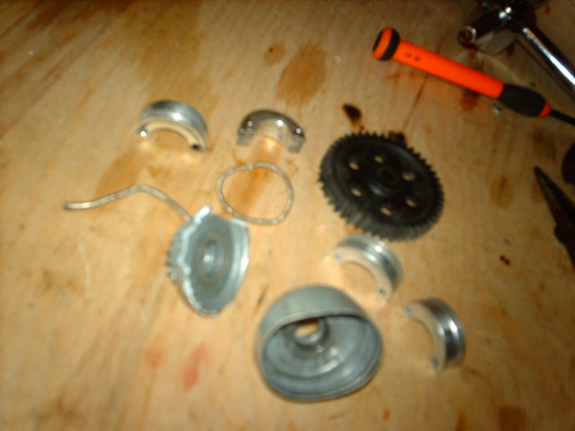

Can anyone describe the way the clutch goes on? Possibly a pic? I went though 3 clutch gears and im thinking my clutch is on wrong.

That did show me a few things but what im looking for is how to line the shoes up? There are 2 different ways you can put the shoes on. First does the spring go closer to the back or the front of the shaft? Second take a look at the holes in the pic. do i have the backwards? http://www.vantechworld.com/webimages/car/IMAG1167.jpg

Well its late here to but i want to show you all what happens.
http://www.vantechworld.com/webimages/car/IMAG1198.JPG
So what is the right way to place the shoes??

i would think the shoes should be pushing not pulling, more friction on pulling meaning more heat meaning broken springs and clutch bells. This sound like a possibility. HMMMMMMMMM I think this needs more investigating.

I 've a new Volcano STX coming from chubbysdad. (your nephews thank you for the buggy and can't wait for my truck to come so I quit breaking their car!) When this sucker arrives I'm tearing the cluch bell off and seeing how they're installed from china. Iwonder if they do them all the same or just guess. It seems to me that from those pics something very BAD happened inside that bell.[X(] Hopefully someone will know for sure and post an answer. I've only dealt with chainsaw clutchs but the spring holds the shoe(no pins) and they evenly expand to drive the chain bell. Yo Chubbs got an answer?

Wow that's one torn up clutch bell.
Chubbysuncle is right there.. the leading edge should have the pin in it.. As the shaft spins the front side of the shoe should be attached and the following end should swing freely.. Does that make sense?
Also.. What did you do to that poor clutch?!?! ..was a sledge hammer involved?? lol

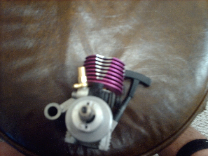

Well I got my Volcano today. I pulled the engine (btw: from the factory the engine wasn't square to the gears and way too much slop) to check the clutch shoes. The shoes are installed with the pin in the leading hole of the shoe and the spring cloest to the flywheel. In otherwords looking at the engine from the clucth bell side the crank rotates counterclockwise. get the pins in a 12:00 and 6:00 position. With the clutch slices together side by side you will have 2 holeson top @ 11;00 and 1:00 & 2 on the bottom @ 7 and 5. top goes to the 1:00 & bottom goes to the 5:00. If you are stripping gears, Exploding clutch bells and have had the shoes off to change or repair the cltch spring checkout the placement of your shoes.
OOHH... I ran 2 tankfuls of fuel thru the truck @ idle or just above and could'nt take it any longer. Blipped around the yard slow for 3 more tankfuls. Absolutly NO problems!. Starts right up 2 pulls right outta the box. I did blue loctite the engine screws after checking the clutch and setting the gear mesh. Another tank or two and I'll start the abuse. DHL beat the piss outta the box in shipping but luckily did hurt the truck.
