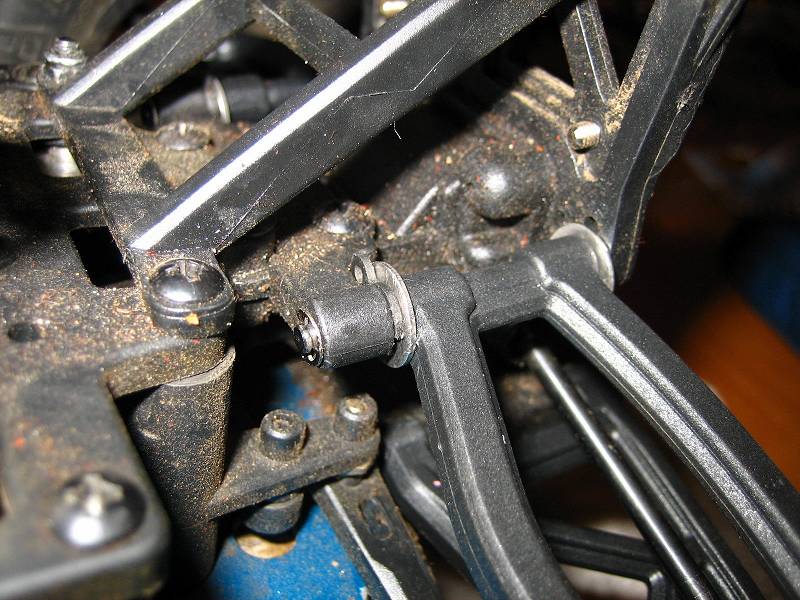

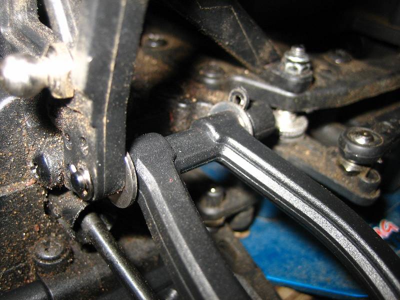

Just out of curiosity, has or does anyone's upper arms have excess slop in them? Since day one when I opened the box, my driver side upper arm had a TON of slop at the hinge pin. By the time it got to the wheel, it was just crazy. It was almost as if it was missing a shim, but it had 2, just like the passenger side. Anyway, due to a hi-speed crash into a chain-link fence, I needed to replace a lower arm. I ordered a whole new set, as I'm sure I'll need a part eventually, and replaced all 4 front arms. To get back to the point, when I put the upper arms back on, it was better, but still seemed a bit loose. I put some small flat washers in there to tighten up the slop. Worked like a charm! You'll notice I ended up using one of the 2 shims that were originally there. Basically it's just adding an extra shim, but I feel better knowing that the washers are metal and larger in diameter. They give it a more solid feel.
Check it out...

i think they are like that to give them some play for when you hit something if they are solid arm will break easier but if loose well theres more play so it usually wont break as eay

Just wondering if putting all of the washers on one end would change the caster by a noticeable difference. Maybe with pivot ball suspension or I guess centering the arm would eliminate the chance of binding with C hubs. I think I just confused myself again.
