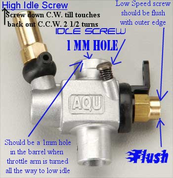

When you look down the barrel of the carb you should be able to see the opening getting bigger when you screw the idle screw in and smaller when you screw it out. set the screw so the carb has about a 1mm hole(about the size of the tip of a tooth pick) that would be your starting point. Use the picture below as a guide for restting your carb to a standard setting to start tuning your engine.

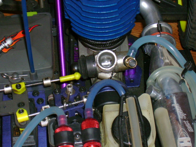

Here is some pictures and make sure to turn your idle trim all the way down and do all adjustments with the motor at running temp. And make a adj then drive the car around a couple of times and see where it's at. I was told to make adj like you are looking at a clock and you want to make adj in one hour adj at a time you know like from 1clock to 2 clock jsut little bit at a time. Hope it helps. Eric

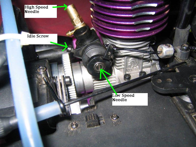

ok bro, put the high needle 2 1/2 out from closed, the low needle flush with the collar and have the idle screw set so the carb has a 1mm opening, this will get you going!!!

I have always liked those green arrows...lol

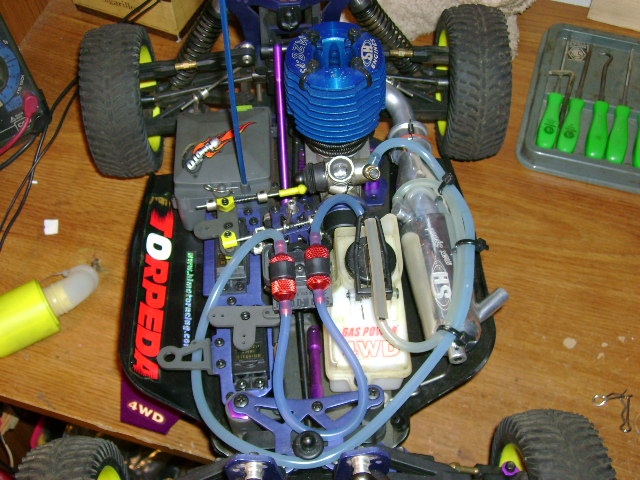

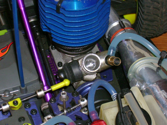

here you go, btw i think the throttle is not going allt he way back, can you check the spring thing??plz
Old 03-10-2008 | 10:47 PM
Joined: Dec 2007
Posts: 717
From: Kansas City, MO
Default RE: idle screw setting
it all looks ok to me, is the end of the linkage getting stuck on the support for the rear shock tower? i had to bend mine up cause it would always hit which would cause the throttle to stay open.
