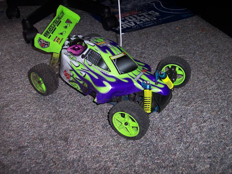

Today was a sad day, my beautiful baby isn't so beautiful anymore. Me and some of my friends took it off some ramps. I broke the wing, The 4wd, now its only 2 for some reason but now i can do donuts. The plastic body is cracked. Today was not a good day.......[]
Oh yeah and i accidentally bent the front shocks.

nice bro, nice bashing, lol. no problem you can fix it.

Do you know how i can fix my problem with only 2 wheels moving and the front to just steering now?

make sure the drive shaft is there, the cups holding the dogbone in are there, the grub screws in them tight?

yes they are all there i am pretty sure, but where are the grub screws, and i tried taking off the upper deck piece so i could get a better look but it was very hard to get everything unhooked.

if you look where the dogbone goes to the front and center diff, you will see drive cups, where the dog bone goes into, these are help on by a recessed grub screw, you could see it if you get the top plate off, there are screws, the handle and a small nut that hold the top plate on.

Yeah i checked and the grub screw is gone! Do you know where i can buy a new set of them? For pretty cheep?
