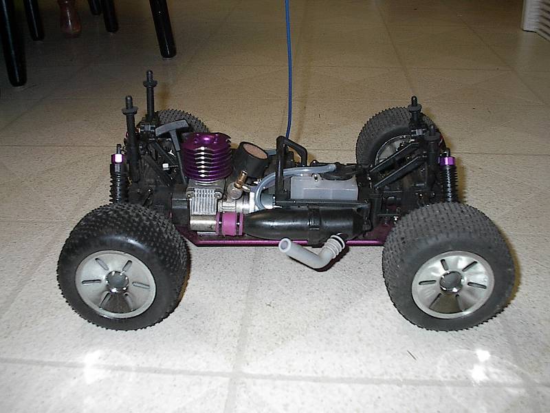

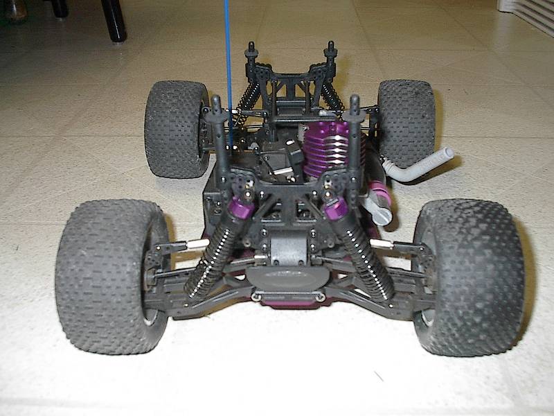

My son had a highly modded electric stampede and he wanted a nitro. I said I would sell his Stampede on ebay and buy him his first nitro truck. Well after looking at alot of brands I did not want to spend a ton of money on a name brand. After doing alot of research I ended up with a Redcat Tsunami. I was leaning twards the CEN MG16 or the Tremor xtk but I got a unbelievable deal on the Tsunami. Not expecting much of it I was very surprised once I received it. The quality is alot better than expected and the Taiwan cxp.18 engine has to be one of the best running engines I have had to tune. No kidding! I know it sounds odd but the motor runs very smooth and tuning was a snap. Once I fueled the tank I primed the line and 2 pulls it was purring. I broke it in and the power is very good and getting better. I would have to say the speed so far is in the mid 40mph range. The only thing I had to do was put thicker shock oil and some minor adjustments. Its not quite hobby grade but its damn near close. They did alot of right things when building it. Steel axles and drive shafts, ball bearings throughout, shock towers and body mounts look very strong and electronics respond well.. The best thing is the motor. Time will only tell how it holds up. Here are some pics.

Ok I didnt want to stick my foot in my mouth about the speed so today I hooked up the gps to my sons Tsunami. After some final tuning I wanted to see what this thing really does. The first few runs I was only getting about 36mph. I noticed it was shifting way too soon and when it hit second it would bog down. I guess it was not in its power band once it shifted. I ended up getting the shift point right after about 5 runs. Top speed was 39.2mph. Alot better but still running rich. I leaned it out and did 2 runs and got 41.4mph but the temps were really getting high. It ran 41.4mph on 20% nitro 10% oil. Outside temps are about 92 degrees and truck was running at 280 so I shut it down. Not 45mph but a respectable 41mph. I will richen it back up so his max speed will be around 37mph. So yes a redcat tsunami can do over 40mph.
