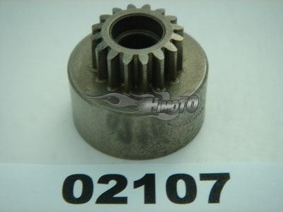

Ehroof,
I finally took you advice and ordered a single seed set up for my Tsunami. I was driving tonight (only my 4th tank thru it )(first 2 were on idle- 3rd idle and a few throttle snaps) and 4th i finally got it on the ground. at low speed it turns on a dime. got the throttle to about half and it was a mini rocket. i hope i ordered the right stuff for my Tsunami.

you did but i would go with a 13 tooth clutch bell to give you more low end, i am pretty sure clermontmotorsports.com carries them, it will give you better low end, the one you got is a 16 tooth i think but if you like it and it has good enough low end torque for you, keep it like it is, you will like the single speed much better bro, now get some action pics and video's up.

its pretty easy,
1. take the engine out and take the clutch bell off and replace back the same way with the single speed bell
2. take the 4 bolts off that hold the trans in
3. you may need to take the top plate off, try to change without doing this but it may be hard to get the drive shafts back in the trans
4. put it all back together.
its fairly simple, the trans is a direct fit to the 2 speed

Sebastien only has a 14 tooth bell. is that ok?
Old 01-06-2008 | 02:12 PM
Joined: Feb 2006
Posts: 16,490
From: howard beach, NY
Default RE: Single speed Tsunami Ultrawide
thats good, one tooth doesnt really make a noticeable difference.

i think i may have the wrong clutch bell (its a 14 tooth). when i assemble everything there is like 3/8 play from the end of the washers to the bell.
Old 01-09-2008 | 08:10 PM
Joined: Feb 2006
Posts: 16,490
do you mean like it will slide off or you can move it back and forth
Old 01-09-2008 | 08:20 PM
5lagd's Avatar
Joined: Oct 2007
Posts: 1,331
From: guelph, ON, CANADA
it moves back and forth- about 1/8" to 3/16"- also there is alot of play on the front transmission dogbone
Old 01-09-2008 | 08:23 PM
Joined: Feb 2006
Posts: 16,490
put a small piece of fuel line inside the drive cup to take up the slack in the dogbone, just dont make it tight. with the clutch bell, maybe you need to just add a washer to keep it in place. you can usually just put it together and it will stay in place and be fine
