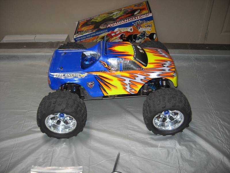

So, I fixed the clutch and took her out for a spin. After 1 1/2 tanks, the bolt that holds the cluthbell sheared off inside the crankshaft! I am done with this thing so to all that are interested it's for sale. You will need to tap out the screw and fix the clutch but other than that it is rtr. It will come with factory (digital fm) rx & tx, upgraded (Redcat) steering plate, hitec hs 645mg for throttle and hitec hs 5645mg with aluminum horn for steering. It has twomanytoys recommended steering bump stops and a motorsaver airfilter. Also, the glow ignitor and charger, rotostart assembly and shaft and pull start and some little odds and ends. $250.00 plus shipping...
