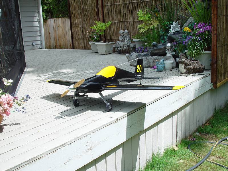

Well after 40 years, I actually completed a Rivets racer that my father started in 1967. The kit was from K & K Fibreglass, My dad had secured the fuselage halves, installed the firewall, sheeted the wings and then stopped. I remember it sitting in the basement for years until I inherited all his old R/C stuff around 20 years ago. I had been out of the hobby for the last 25 years and just got back into it in February. I decided to tackle this project so away I went and it wasn't long before I discovered why he shelved it. He had sheeted and joined the wing halves but forgot to install the control rods. back in those days of course dual aileron servos were unheard of. I was able to bore some holes in the foam to run servo wires and problem solved. All I had was the fuse, wing, wheel pants and plans. I decided that the "T"-tail was beyond my skills so proceeded to design and install a conventional tail. Painted it black and yellow with #20 on the tail since I remember that that was my dads original plan. I stuck an old Webra .61 on it even though the plans say it's a .40 size. I've had to leave the wheel pants off as our grass feild wouldn't accept them. Since I went with wing mounted aileron servos, I also modified it to have full span ailerons. I have 4 flights on it and just love it. It has very quick and responsive controls and sets up nice for landing, but doesn't like to slow down. I wont be doing any racing just sport flying.
Any one have a Rivets unmodified that i could see a picture of?

Very nice effort at restoring an old project!
Actually, that was the method used in building those old F1 airplanes. You sheet the cores, join them, sand it out and glass it first. Then you cut out the ailerons, and cut into the bottom of the wing for the torque rods, and hinge the ailerons. After that, one would glass the center section and finish out with a second resin coat and wet sanding......days later.
If I remember correctly, K&K was down in Sunnyvale, Ca. The Rivits was one of the earliest glass kits, and was somewhat derived from the wood Rivits that Joe Foster won the Nat's with around 1967. Foster's Rivits design was featured in Flying Models magazine in 1967 as well.

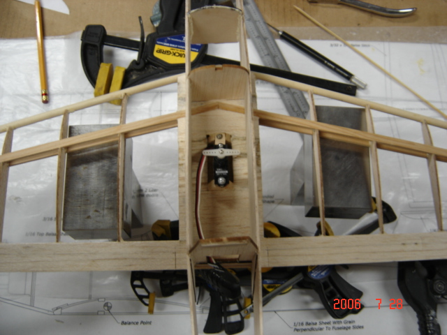

Where did my camera go[X(]? I am currently building ROG's short kit and will post a few pics soon. I have the wing done and the fuse started.

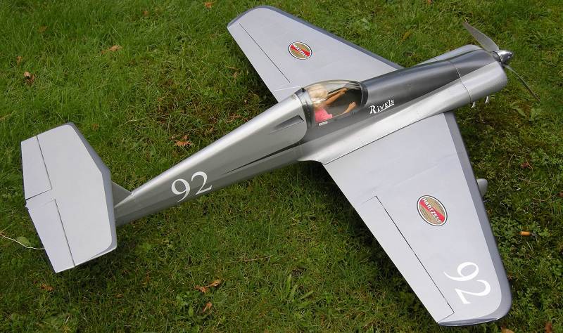

My version

Ahhh the photo thingie is working again.[8D]

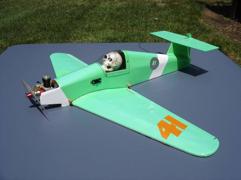

Jean,
Do you have a group to race that plane with??
It looks great by the way.
This is my 1/2a version. I've come in second twice with it at our annual reedie race and it was recently featured int RC Model Wold magazine. The plane makes for a very good racer.

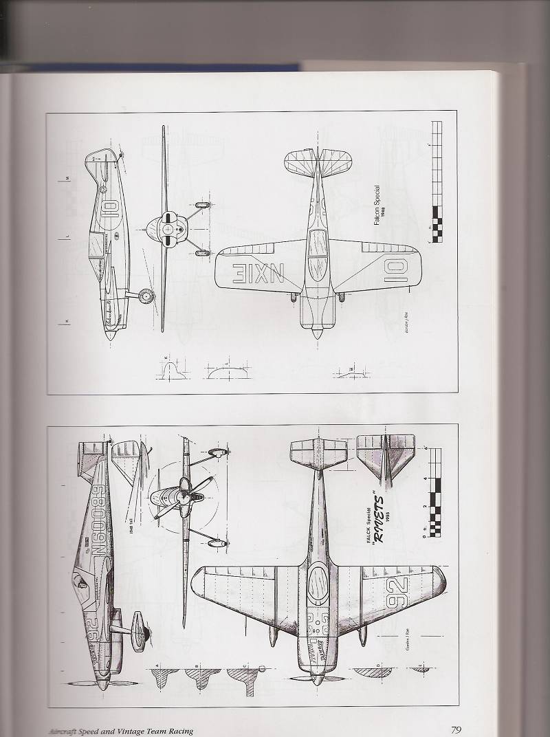

Any one know of just how many different designs of tail groups the Rivets took on?
I got a very poor plan of a low mounted Hoz-stab on a Rivets by Jerry Nelson. He says the original plan was erased and a newer High mounted Hoz-stab was then used. It worked better too.
There were other alterations he mentioned before the whole thing was scrapped as obsolete.

Bill,
Hopefully you can tell in this scan that there were indeed two tail versions. The regular (1948) was changed to the well known T-tail.

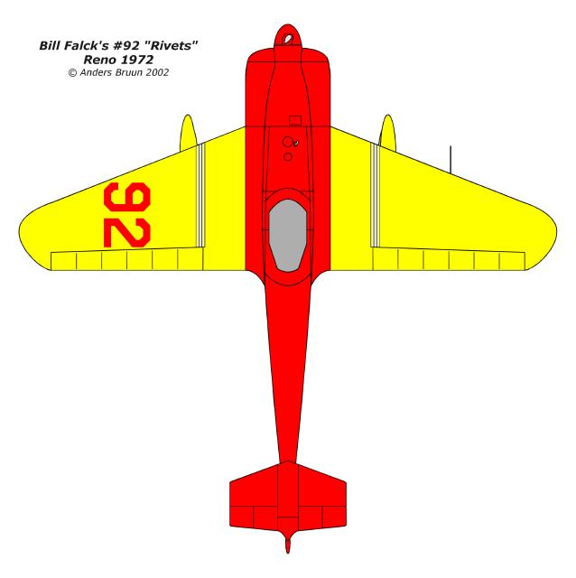

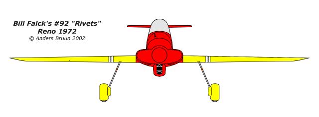

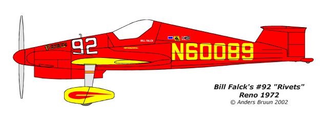

There a fews profiles color pictures of the RIVETS ,also yo could see the real racer in the Model Airplane News in the section of the Midget Race plane in page 40 in september issue 1990
