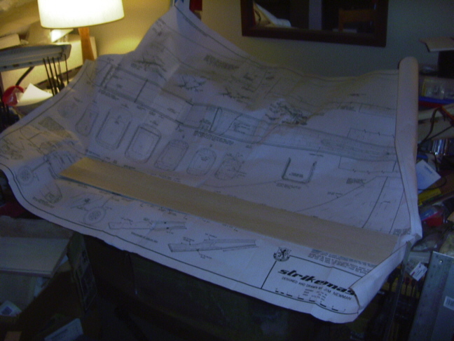

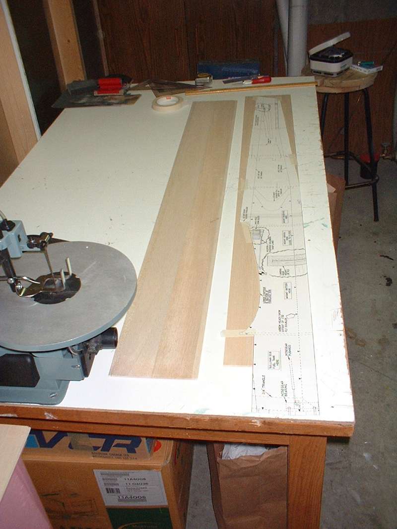

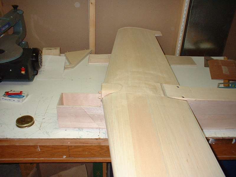

Pete has a bigger work area so most of the pictures will be from his end of the project (right, Pete?

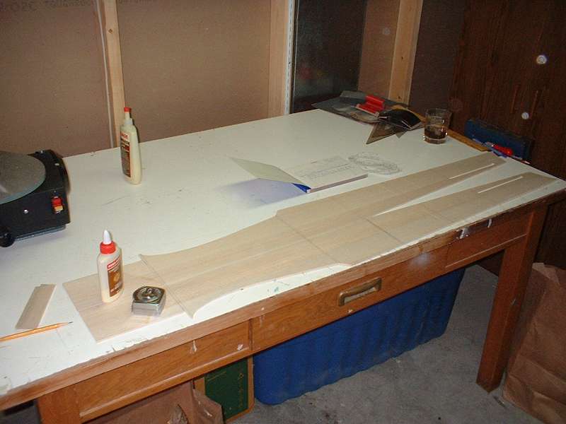

The hardest part was deciding how to build a 4.5 foot fuselage in 3.5 feet of work space (pssst...the solution is to clean up a bit).
There is also a shot of splicing the forward piece of wood onto the main fuselage plank. The 3" wide splice onto the 4" wide fuselage plank is a perfect fit for the canopy shelf.
)The hardest part was deciding how to build a 4.5 foot fuselage in 3.5 feet of work space (pssst...the solution is to clean up a bit).

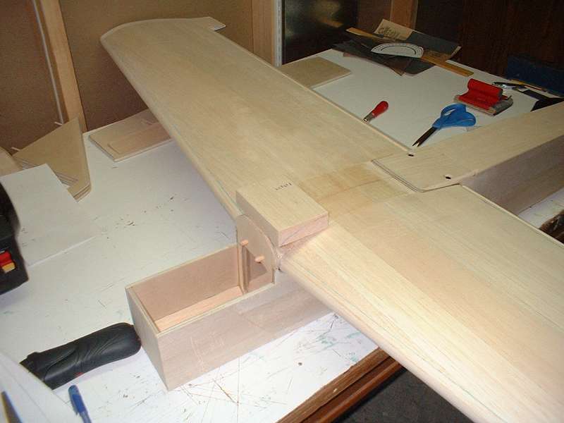

The fuselage is constructed with some 1" tri stock on the sides of a 1/8" balsa fuselage sheet which helps makes the fuselage very twist resistant plus it helps you sand some really nice radius curves on the sides. There are also some 1/8" balsa and 1/16" plywood laminates which helps give the forward fuselage and wing saddle area some heft to help carry the load. Note that the rear of the laminations are radiused to prevent a stress riser where the laminates end near F3.
The other picture shows the 1/4" ply firewall and 1/4" F2 wing mount former, the 3/16" ply F3 former and the 1/8" balsa F4, thru F6 formers dry positioned just to check alignment.
Yes, I still need to clean up some.

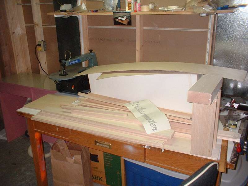

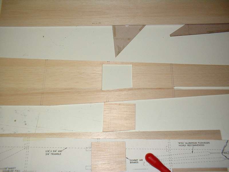

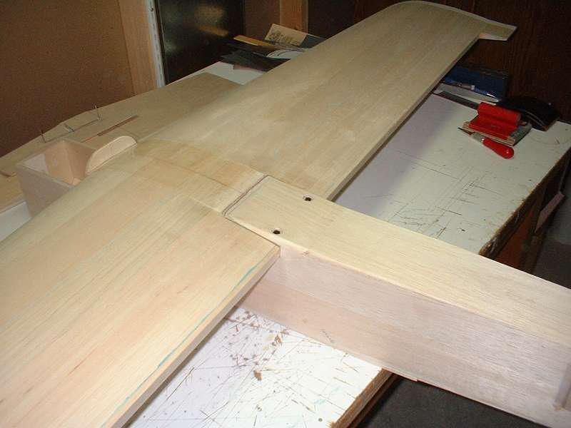

ok here we go with fuse sides and the Speed Brake Doors. The doors are in place as per the stock plan. You will also see that I have (as I call it) Trenched in the formers from F4 to F6 into the 1"Tri stock for a better fit over all.
To quote Mr. Jim Newman "you will also see that I do not follow the herd and ask the builder to "crack and bend" the sides at the trailing edge, in order to pull them inwards to create a taper. I don't know why modelers do that but, they have done it since time immemorial - and yet there is absolutely NO need to do that as you can see. Spread the word to your buddies who fancy themselves as designers."
So in order to get around the "Crack and Bend" I used the trench method it worked will in the end as you will see <g>
Pete
Proto #2
Pete
Proto #2

Ok now with the wing skins, Formers and fuse side cut out time to move on. The next pic shows all the kit cut out with the foam wing core's covered. you may also see a hint of what the tail may look like.
Pete
Proto#2
Pete
Proto#2

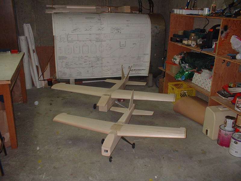

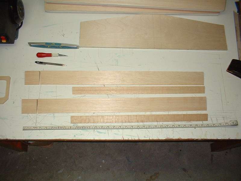

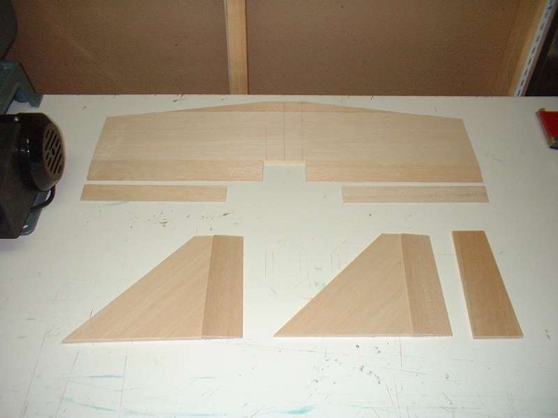

The next four picture will show 1) lay out of the Stab and twin Fin's note the size difference in elevator to stock and single rudder on the right to twin rudder size. 2) Flaperon's with end caps to the stock size aileron's 3) Strakes general size that will be tested on a later test flight 4) 25% larger wing over the stock stikemaster wing.
Joined: Jun 2003
Posts: 1,216
From: Whitehorse,
YT, CANADA

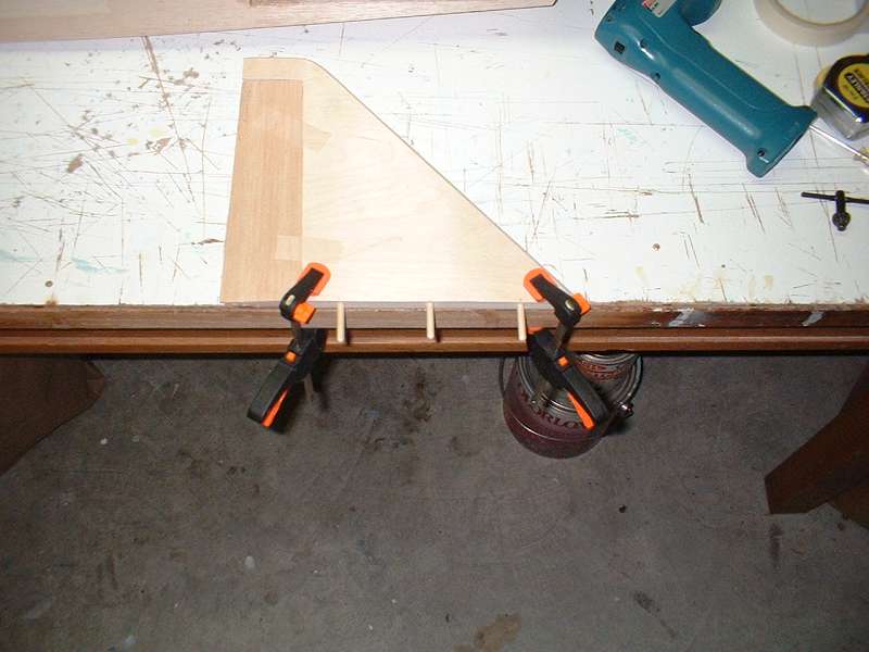

Next set of pictures: 1) It was decided by the team to increase the Area of the Fin's By adding End caps 2) Putting holes in the fuse sides at the C/G location will help with the final balance 3) Aaaah Now the Basic outline of the SSM 4) We found that inlaying the main gear ply 1/4" plate will give it more strength and make it easier to radius the edges
Joined: Jun 2003
Posts: 1,216
From: Whitehorse,
YT, CANADA

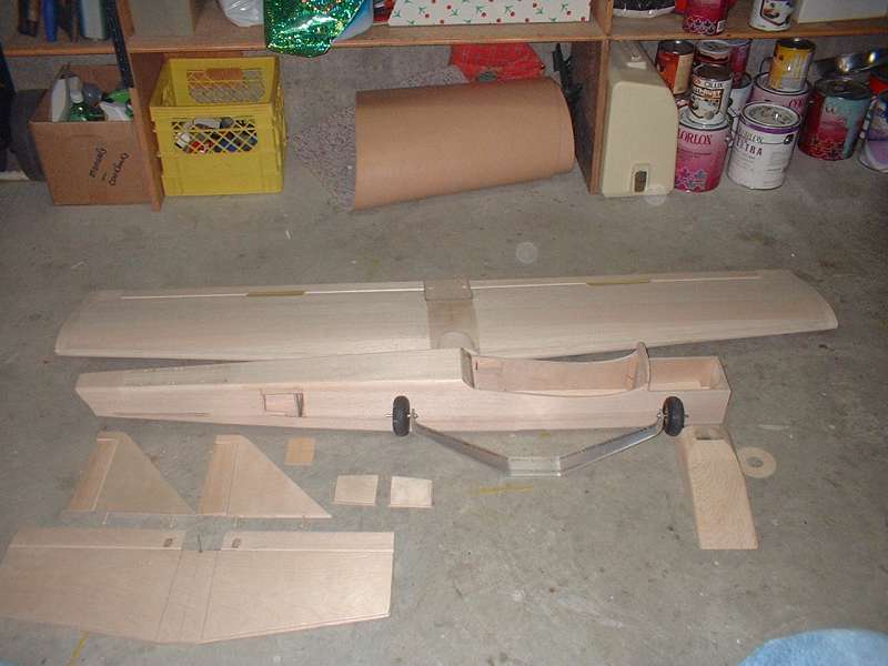

Next set: 1) Used 3/16" x 2" pegs to fasten to the top of the fuse. 2)Placement of Fin's with 18 degree of bevel on bottom of fin. 3) Inlay of main Gear 4) More shape to the SSM

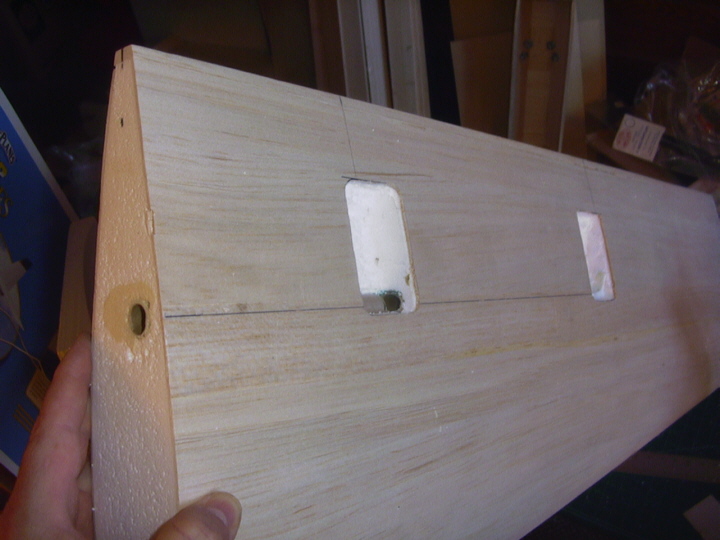

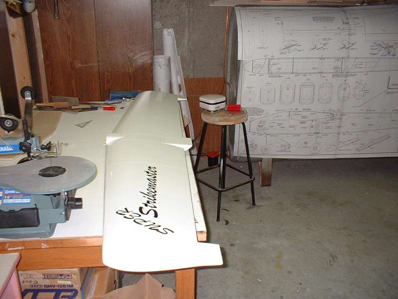

Well, as you can see from Pete's pictures, the plane goes together quite easily. Even if you don't have any room to build, like me.
Pic #1 is a picture of my first stock kit Strikemaster (1973-74), just to jog your memory of what the completed .40 size plane looked like. Enya .45 and GeeBee plastic floats.

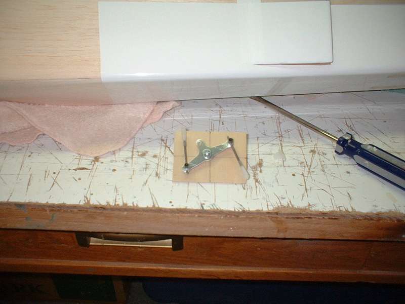

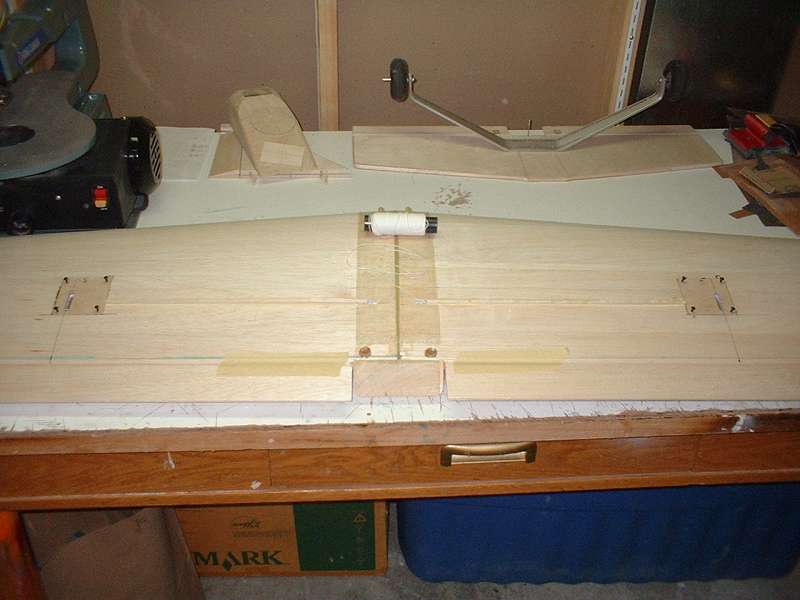

Pic #2 shows the flap and aileron servo hatch positions. The stock plane uses torque rods but on a plane this size, we think you really should have a servo on each aileron (and/or flap if you have them). Besides, servos are cheap.

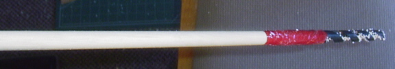

Pic #3 shows the super complicated drill bit I made to drill the servo lead holes in the foam wing. You could always trench the leads holes on the surface of the foam but I like to be different. I'll say this though, it takes a lot longer to do it my way. The drill bit is 1/2", using zagi tape to attach it to a 1/2" dowel about 24" in overall length. It is a hand drill and it helps if you have a third hand to ensure that you are going into the wing at 90/90 angles. The Estes BT5 rocket tubes are a perfect fit.
Pic #4 shows the servo pockets and the rocket tube installed.
Don
Don

1) Time to cut the servo holes into the wing. Unlike Don I did not put the holes in before I had jointed them OOOPS hehehe Had to trench over to the center and use string to pull the wire in. 2) How about a short kit ? >>>>Anyone? 3) Just had to cover the wing to see how the Decal would look.
Pete
Proto #2
1) Time to cut the servo holes into the wing. Unlike Don I did not put the holes in before I had jointed them OOOPS hehehe Had to trench over to the center and use string to pull the wire in. 2) How about a short kit ? >>>>Anyone? 3) Just had to cover the wing to see how the Decal would look.Pete
Proto #2
