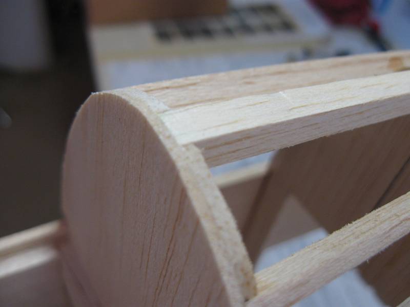

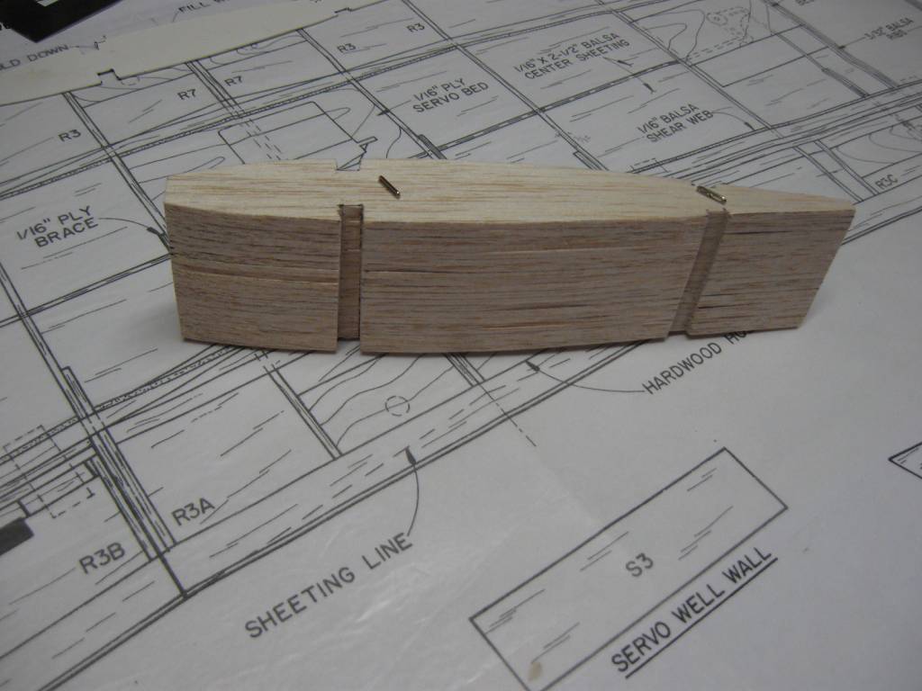

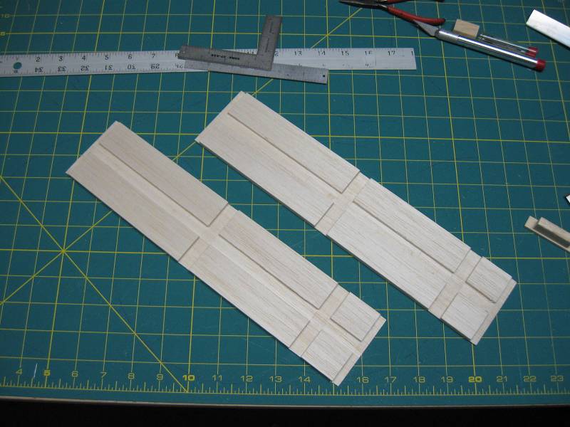

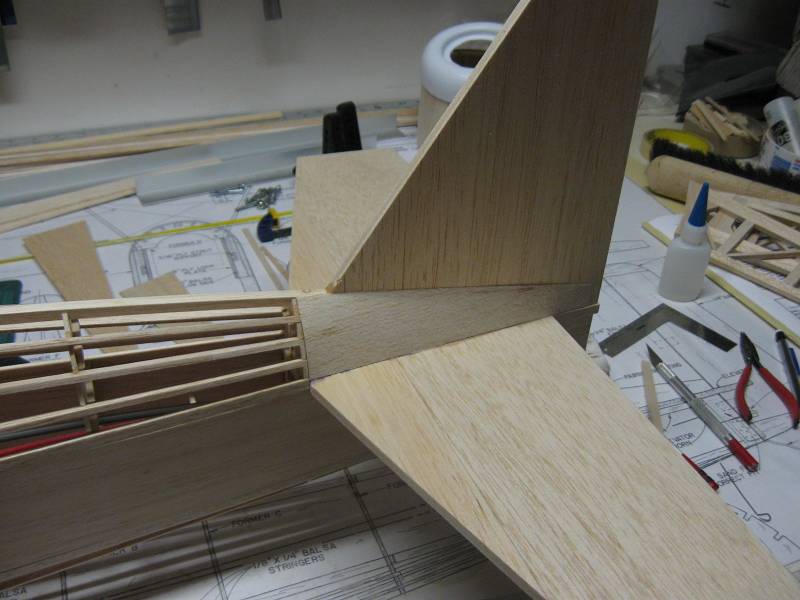

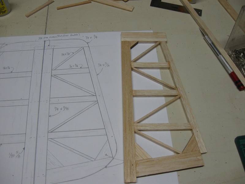

Here is my first attempt to build a model aircraft from the plans only. Listed is the photo documentation of my progress as well as some modifications to this design. First off, I decided to create new drawings for the fin/rudder and stabilizer/elevator so that they are built up construction as opposed to solid pieces of balsa. I am open to any comments concerning my choices for this build. I have constructed many kits since this hobby got into my blood back in the mid 1980’s.

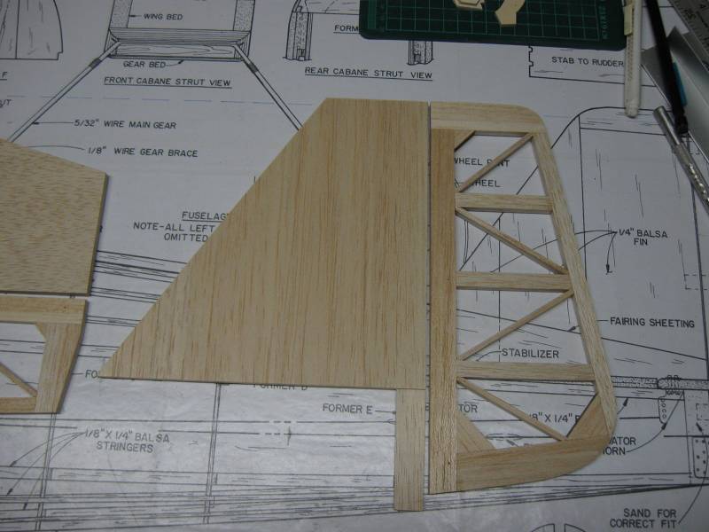

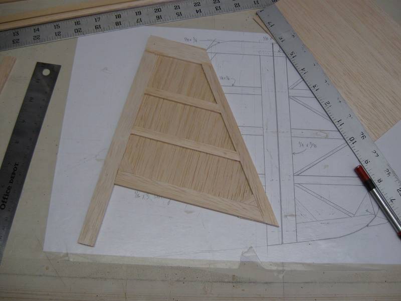

Here is the new tail control surface I drew and then built. Using the dimensions from the plans I decided to increase the rudder size by adding half an inch to the length. The stabilizer and elevator also were increased by about 1/8th inch to each side. I wanted to have a little more surface as I intend to build the larger wing configuration with ailerons on both wings.
This will begin with construction of the stabilizer and rudder.

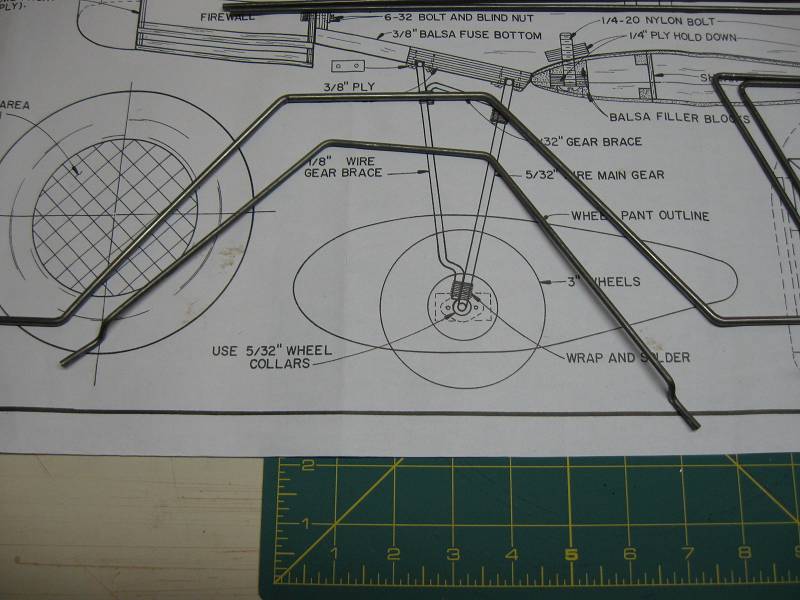

I have been debating the whole landing gear thing myself. I Really like CrateCrunchers Cowl. What kind is that? Can they still be obtained?
As far as the Tail section, The Stab and Fin are bilt up and sheeted, while the rudder and Elevators are open design.

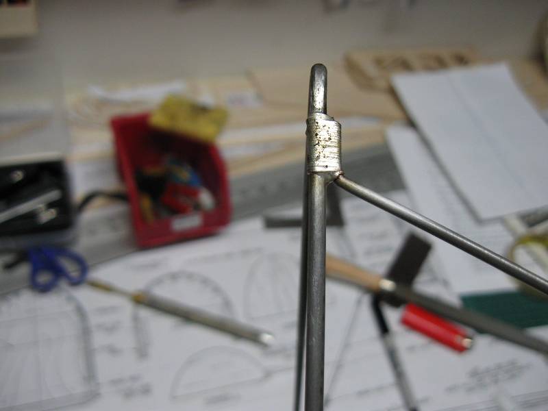

The next thing to do is begin the fuse sides and the fun task of bending piano wire, weeee....

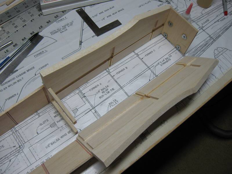

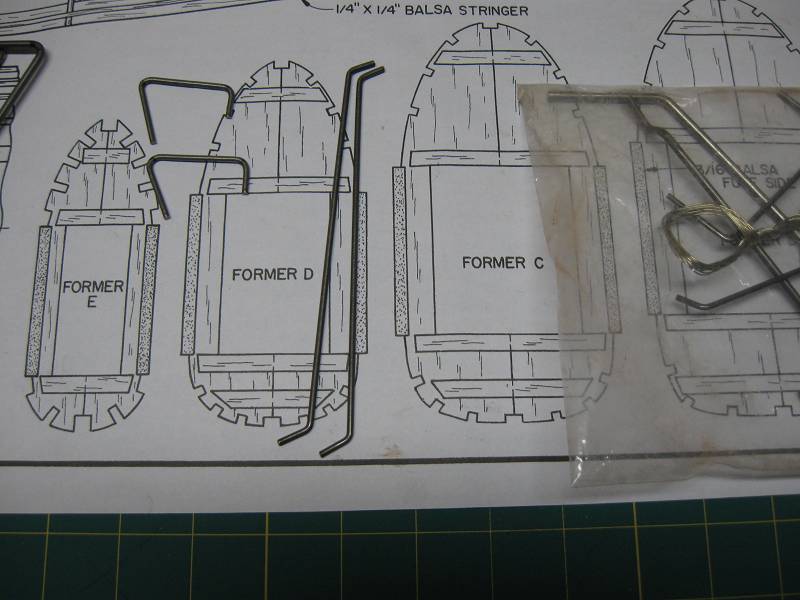

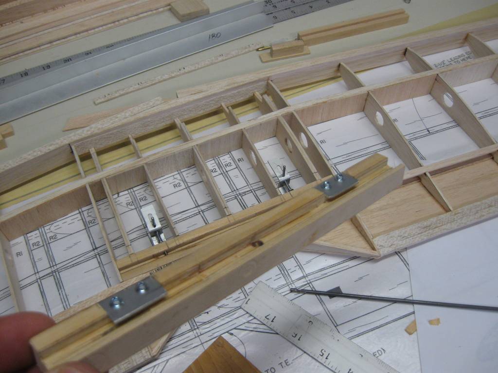

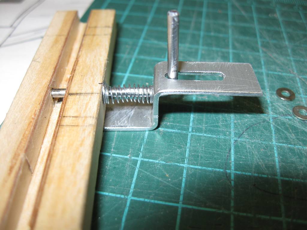

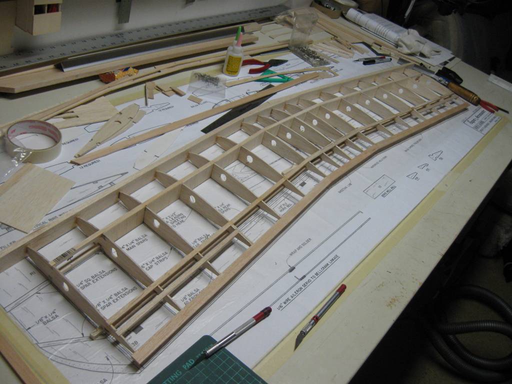

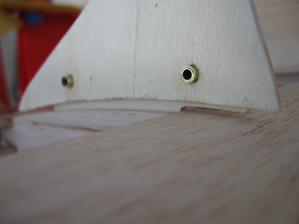

As this photo illustrates, I am comparing my parts made to those of the original kit. My hope is to complete this project without disturbing the integrity of the original. I have a very large table vise which was used to cold bend piano wire up to 5/32 inch. Most of the wire needed is 1/8 inch., oddly though the only wire to give me trouble was the 3/32 inch wire; it was breaking during bends exceeding 90 deg.
While this upper wing can be held onto the plane with only the center cabane, I plan to add some outer supports to this build. I feel it will enhance the look and assist in stabilizing the wing for the aileron setup I’ll be using. Upper and lower wing will have ailerons with a servo in each side of the lower wing, utilizing a tie rod to the top wing.
I am exploring several ideas to attach the top wing without needing to use a herd of screws for this process…

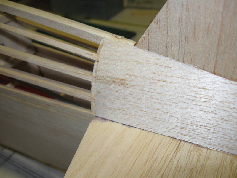

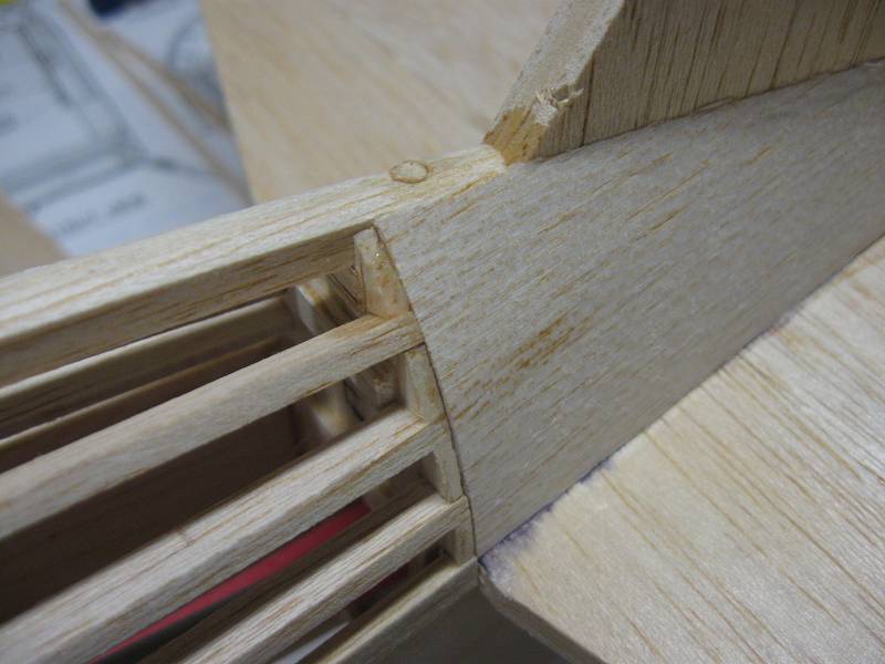

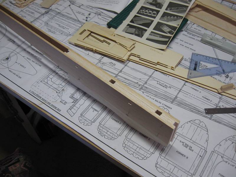

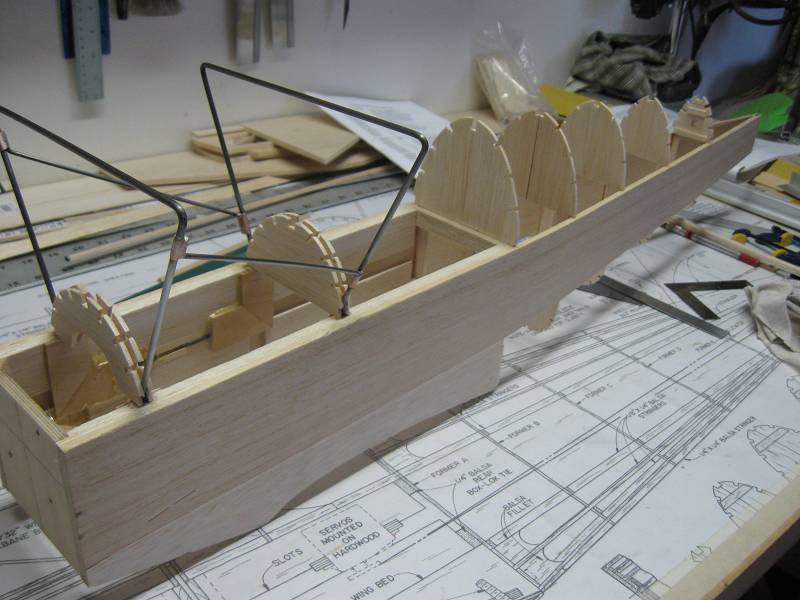

I am getting close to the completion of this airplanes fuselage. The tail section has been installed and the cowl is near complete as per the original plans. I am looking into the idea of adding the rocker details to the cowl. The build is progressing quite well and hopefully I will be able to fly it this coming summer season. I have made arrangements to utilize a pull-pull rudder control as well as a single servo to each individual elevator. My choice for power is this old O.S. .91 Surpass I have from an old trainer.
Here are some current photos…

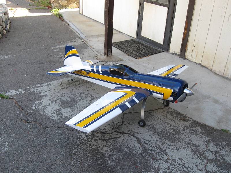

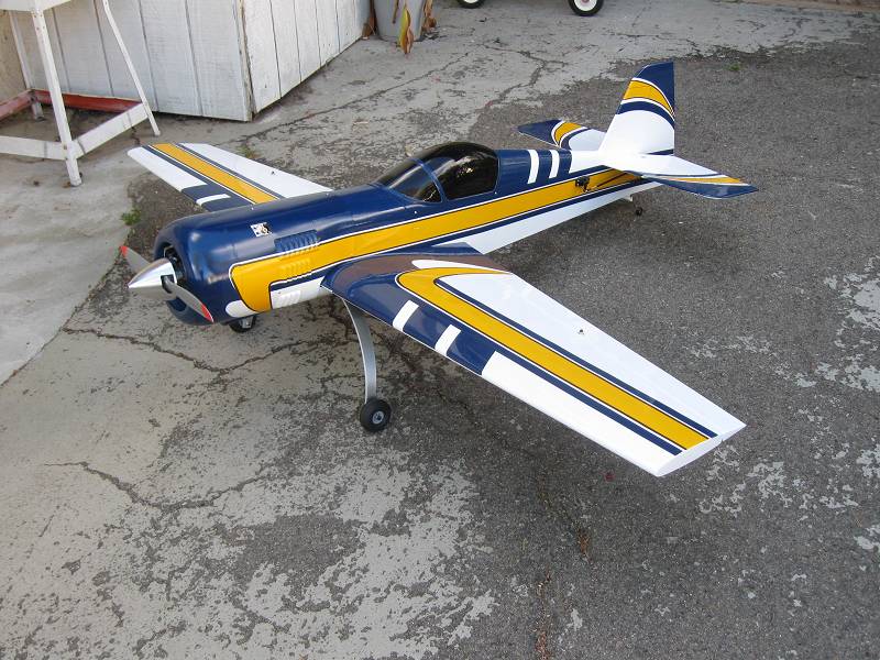

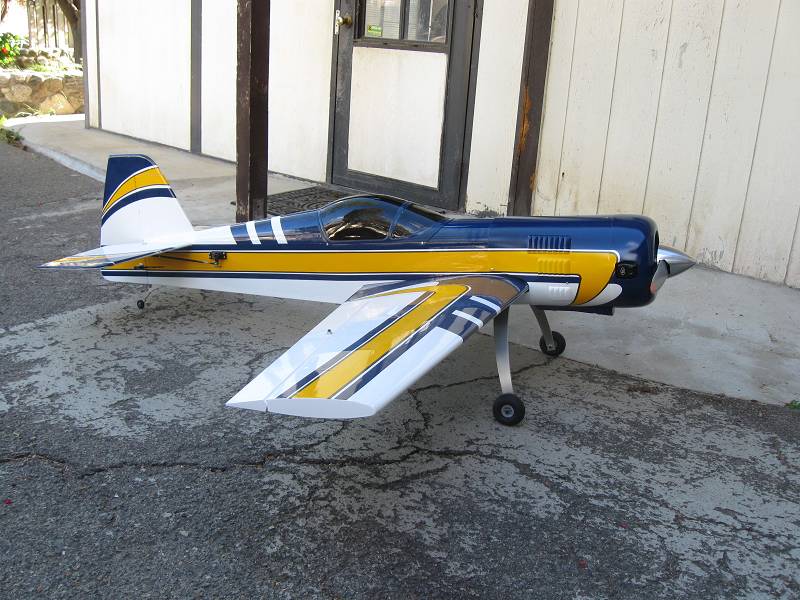

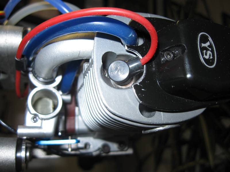

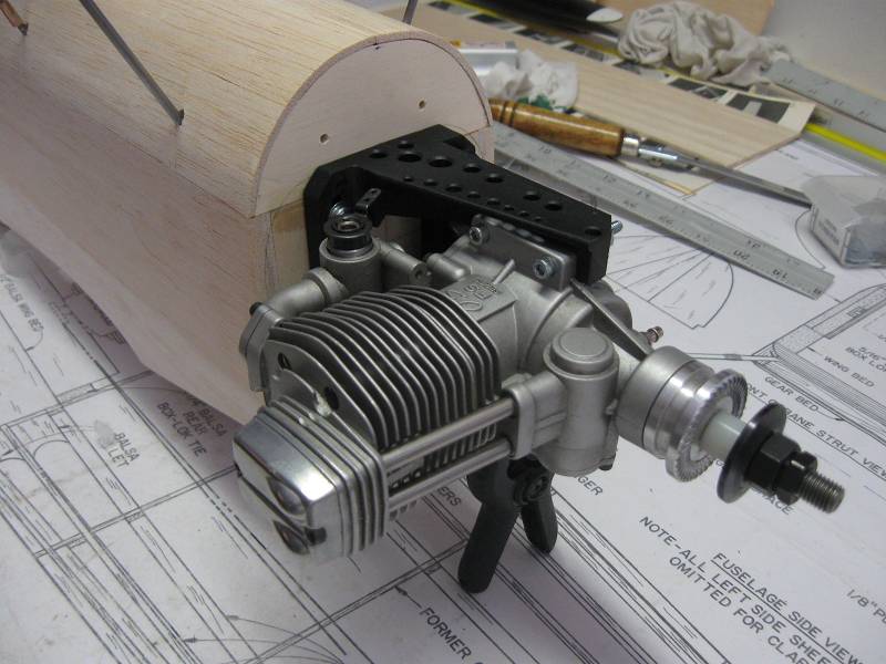

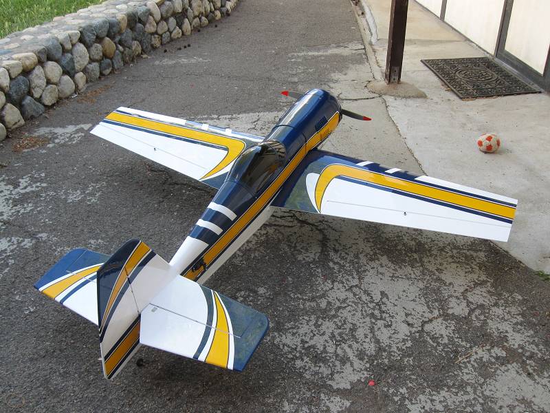

Finishing up this project for my nephew.
This is a C.G. Sukhoi SU-26M ver-1.

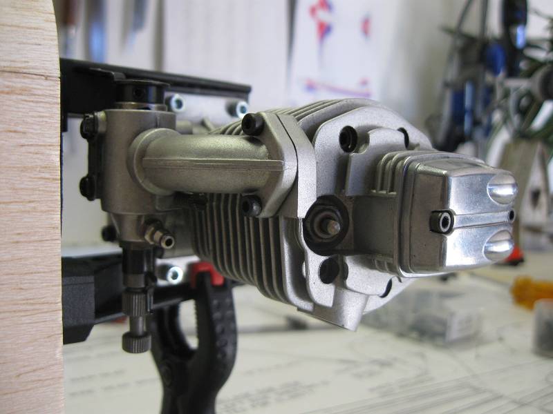

Modified with carbon fiber inlaid wing spars, hardwood tail feather spars, aircraft hardwood replaced firewall and landing gear location points.
Y.S. 140 DZ and pitts style muffler, c.g. mounted fuel tank and onboard glow ignition.

Now that I have hade some spare time to spend on my project build recently I can show the results for my efforts in the upper wing mounting system.
This is what I have so far, my front cabane will slot into the wire groove then the rear will have a spring tension pin to hold the wing onto the cabane.
I plan to use four small servos in the wings to activate my ailerons. The next step is to mount the upper and lower wing to the fuse and then make the
outer wing struts, as of yet I haven't decided whether I will use aluminum or wood to construct the parts.

Great news about the arrival of the kit. Mt plans are to power my plane with an O.S. .90 that I have, it's an older engine but it pulls great.
I'm also considering a possible swap to a SAITO 1.00 if i can get a good deal on one. If you want 3-D performance go with a Y.S. 1.10 or
something similar and use the short wingspan option.
Here is the latest bunch of photos for the build, these are the I struts I'm using for this build, they are hard balsa ply and balsa. there will be
pins made to hold these in place as i'm not going to use any screws for this application. I made the pins from two sizes os brass tube and
soldered washers to the smaller diameter tube which will be drilled to accept the clips made from piano wire. The larger diameter tube is used
as the sleeve in the other part for the wing mount.
