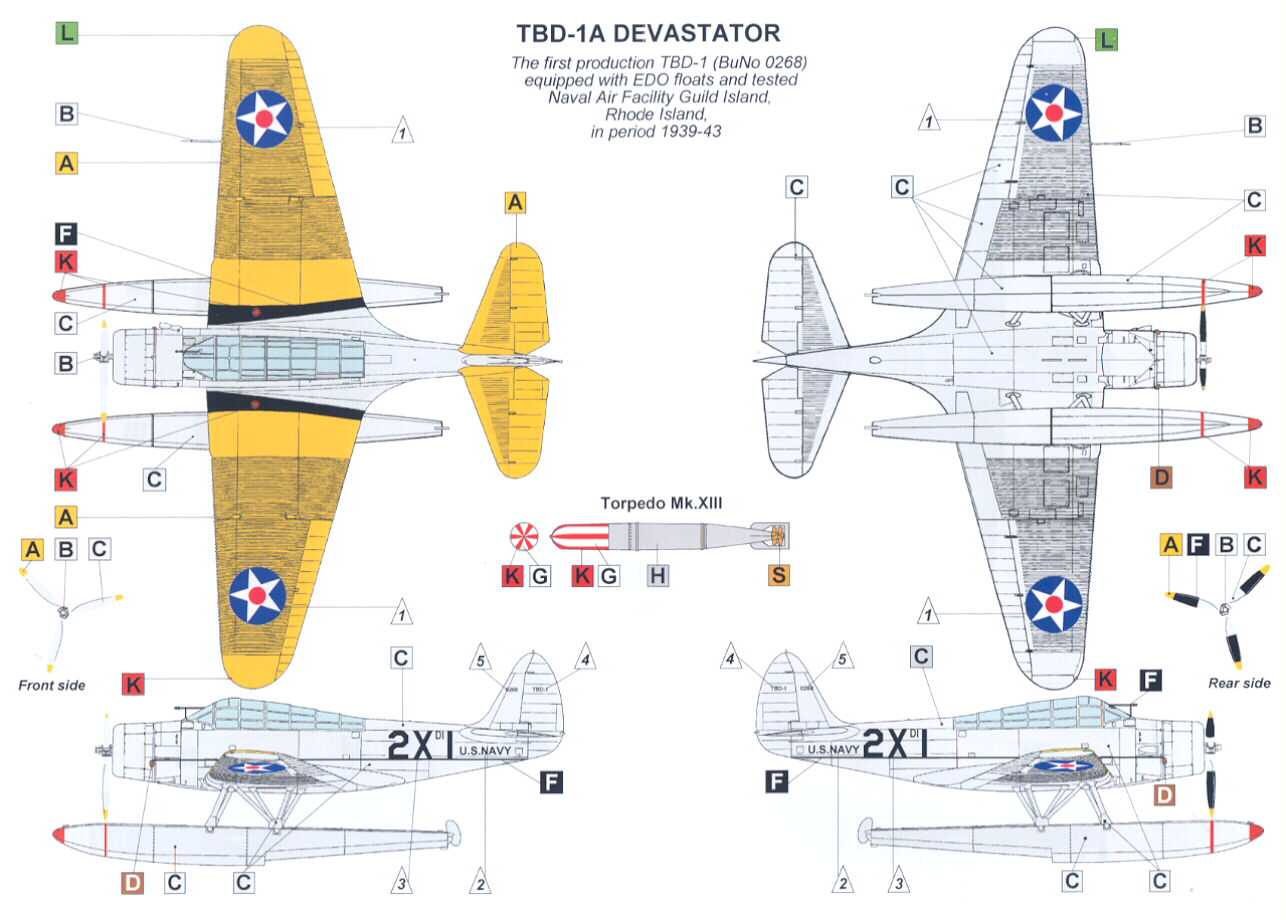

For some reason I just got the urge to build something different again even though I have lots of kits already to build including my Marutaka Rufe. I saw this plastic kit for sale and did a little research. Found the Dick Katz 1/12 version to my size preference and ordered a set of plans from Scale Plans and Photo Service. I received my plans and looked them over. It is powered normally with a .40 TS in land configuration, has a generous chord, and pretty thick airfoil. Though the Katz design seems more simplistic than my Brian Taylor Kingfisher, the characteristics of the two airframes seem very similar. I believe in the float configuration it would be a nice compliment to my OS2U. Again a .80 FS would most likely be more than adequate as long as I keep the weight down. The floats will have to be either built up or foam and seeing since they appear to be basic EDO's I might go the foam route for simplicity.

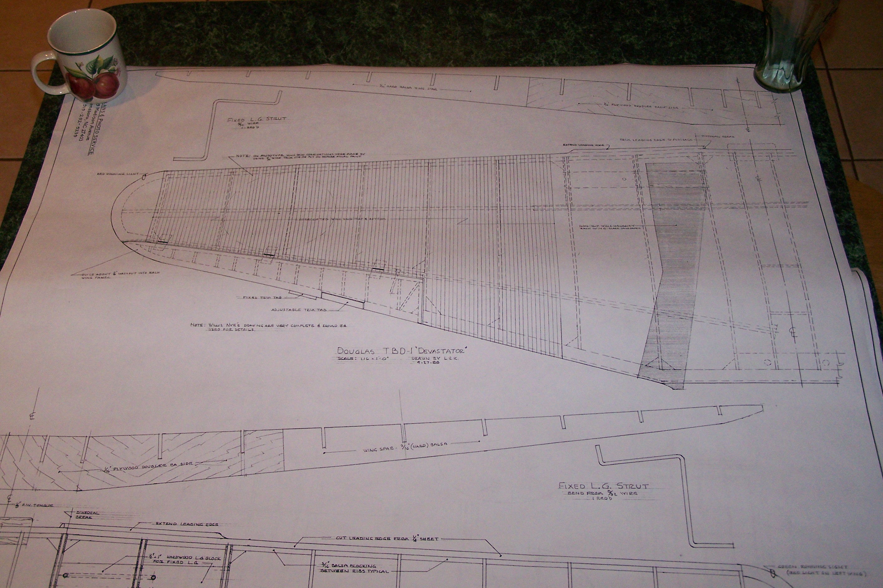

I have contacted Joe at Kit Cutters and will be sending him my plans for him to make me a short kit. He told me by end of Feb. or beginning of March he could have my short kit done and shipped to me. I will be going that route. Is anyone familiar with this airframe in this configuration and have they seen one fly?

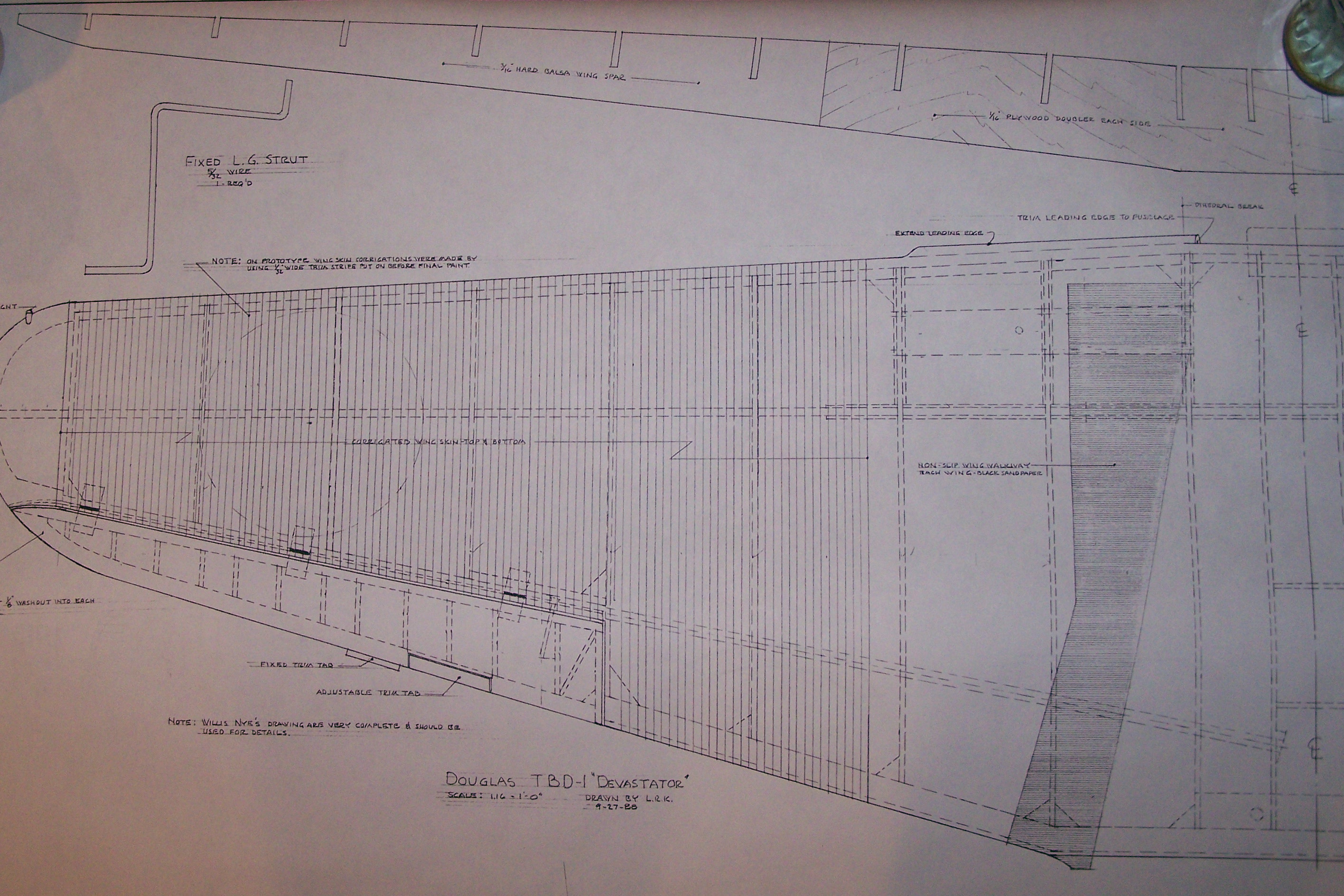

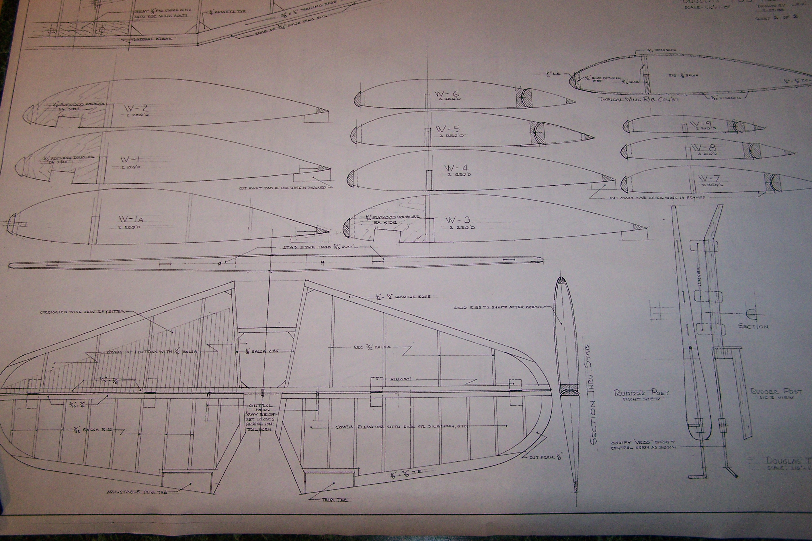

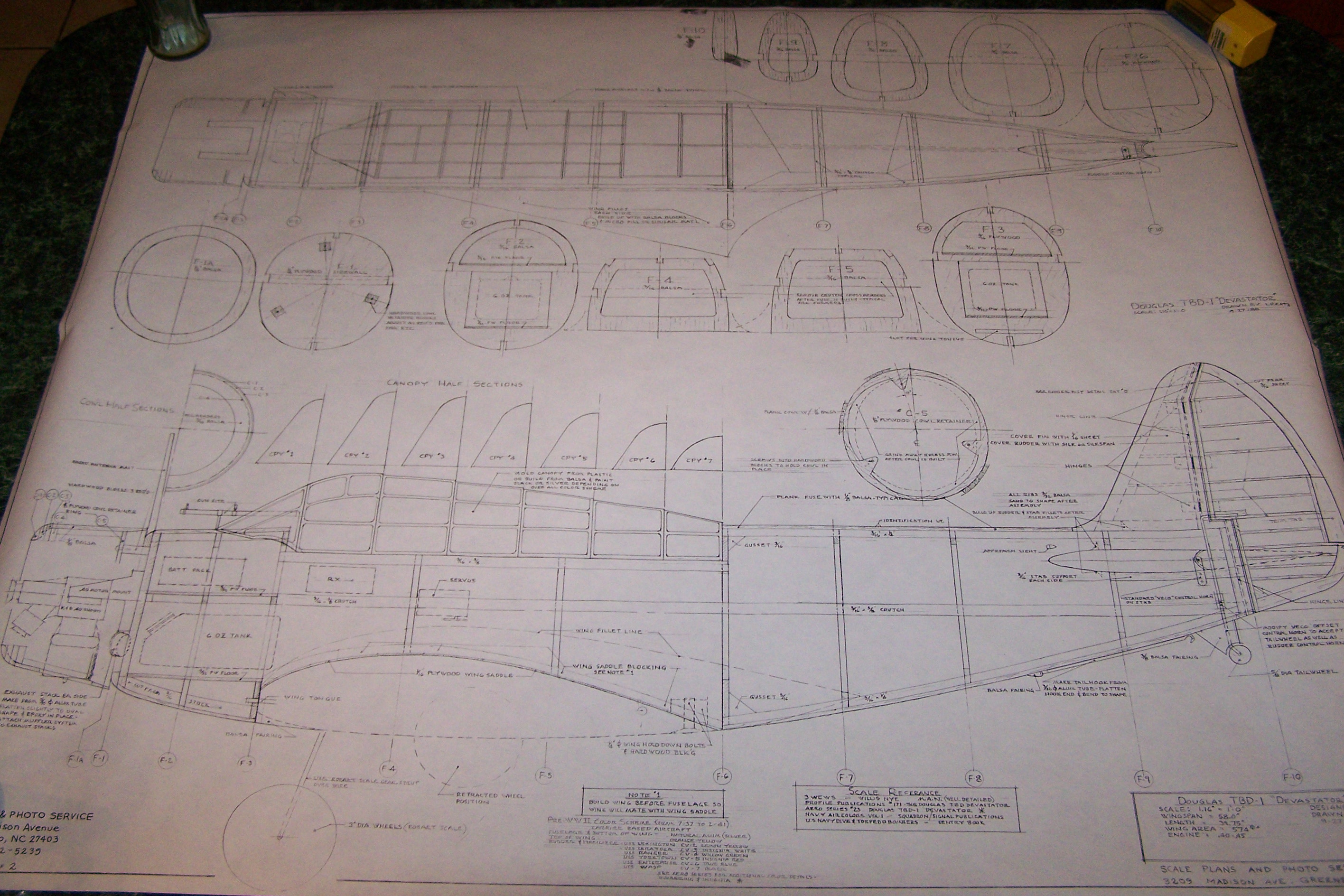

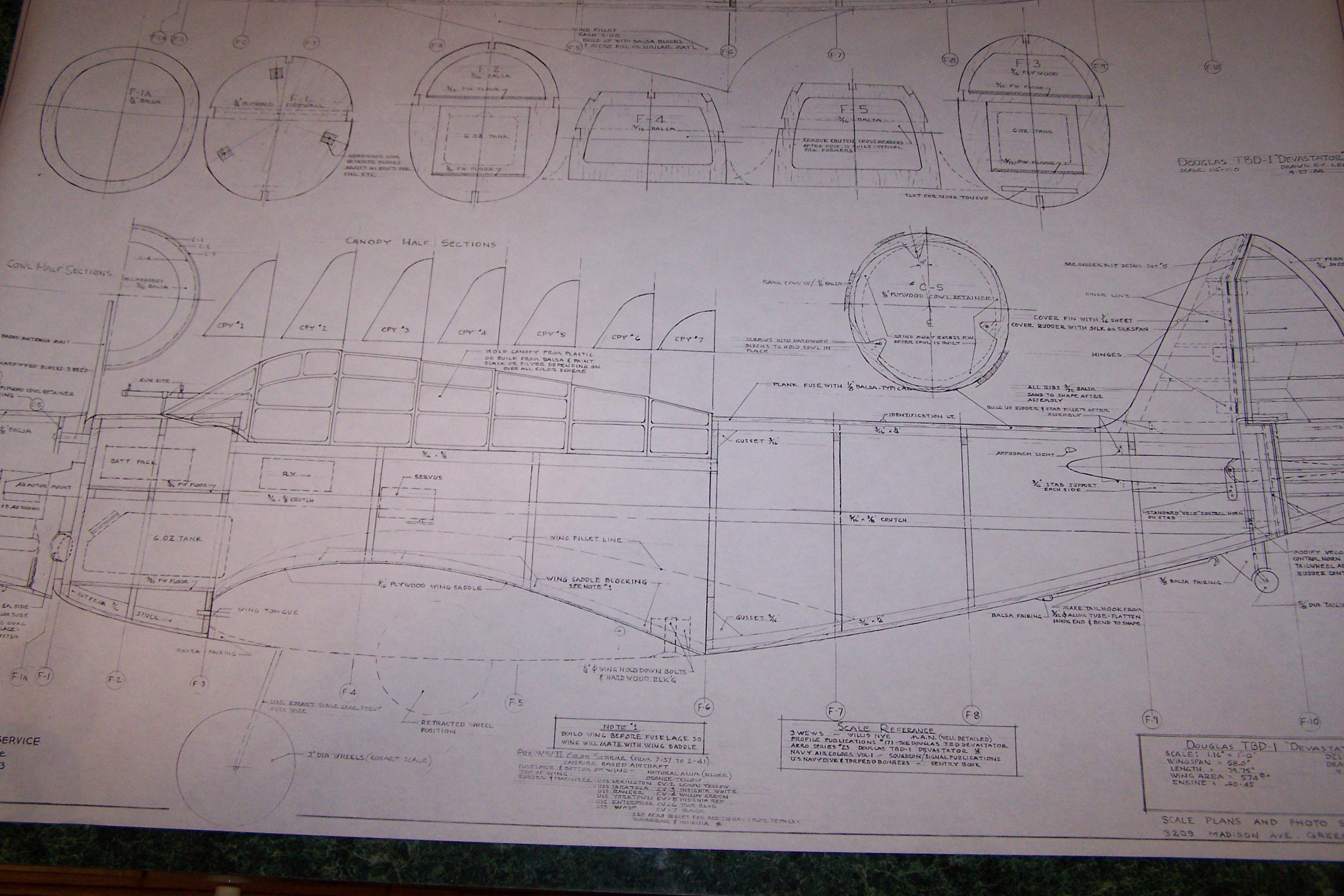

Here are some pictures of the plans. I have them ready to ship out tomorrow to Kit Cutters. Thinking of having him do 2 wings so I can make a land version and a float plane version. Just an idea. Would have to add a tail wheel though.

My short kit is on the way. Turns out the wing ribs shown separately on the plans do not fit the plans drawing of the built up wing so they re-cut the ribs to fit the drawing of the assembled wing. If they didn't when the wing would be built over the plans the parts would not line up with the drawings. (hope I explained that correctly). Got my Signal Squadron book in and have been going over that. Turns out a float version was designed for overseas sales to Denmark and it had a enlarged fin that looks pretty cool. Not sure if I'll build that version but if I do it will only be a proposed prototype as it was never built. Not sure of colors or markings so it would kind of be a fantasy plane.
The original was flown for over 4 years at the RI base and had a reputation as a good flyer. There was some mods made to it and and it was rebuilt once during those 4 years of service. It's main job after the rebuild was to help solve problems with the torpedo the US was using at the time. The airframe used for this plane was the first production TBD off the line and once those 4 years of service were done it was just scrapped. The two EDO floats were the largest ever attached to a single engine aircraft at the time.
Hopefully mine will fly as good as the prototype did. Will get some pictures up once the short kit arrives. Still finishing up a Jemco PT 19 and a Davey Ind. P47 right now. Got to get those off the bench first before the Devastator gets started.

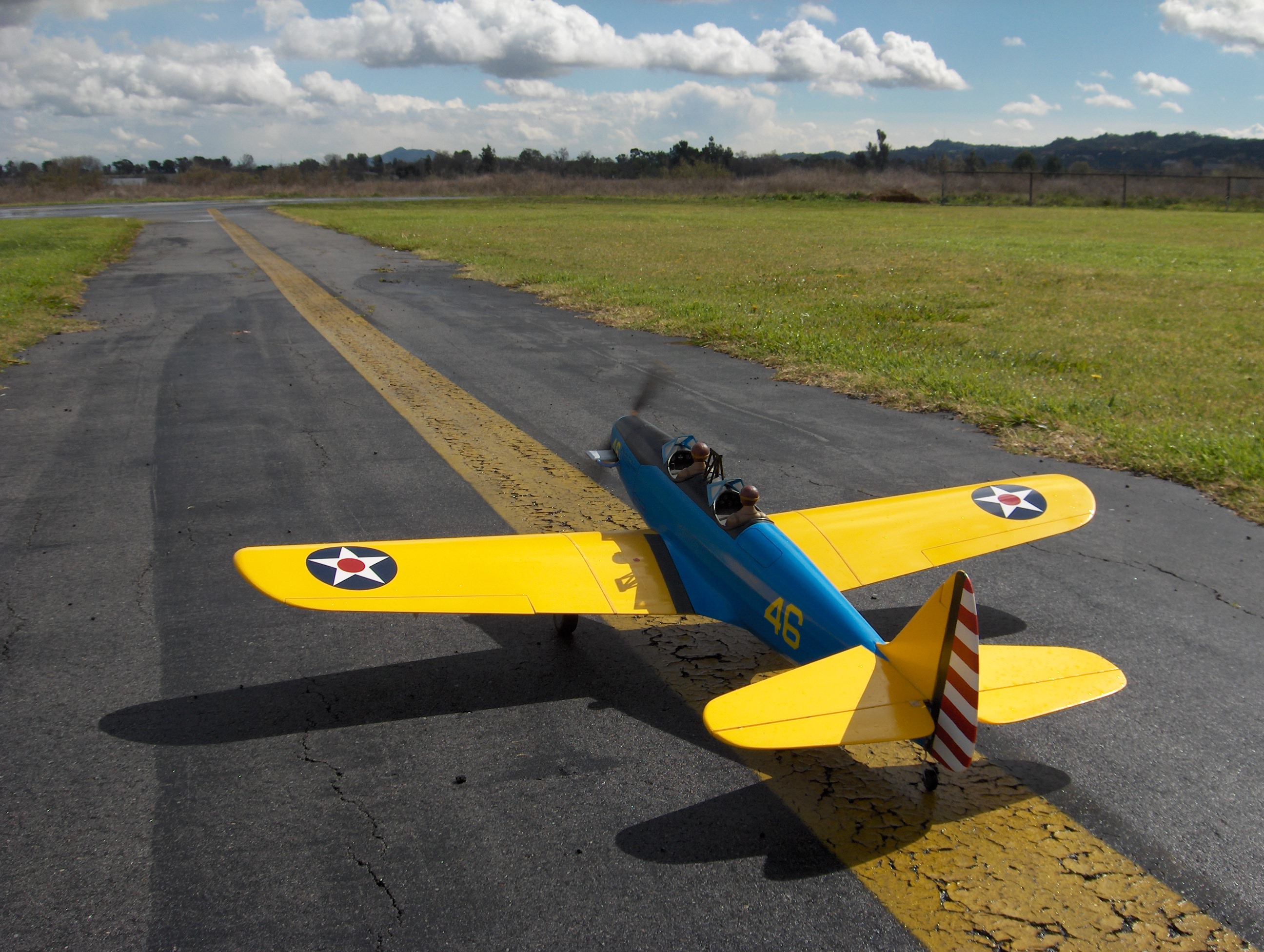

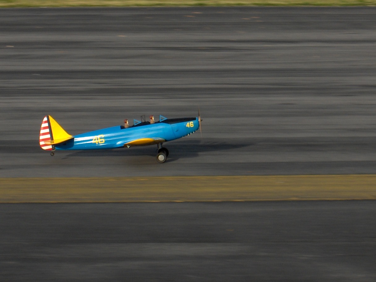

I'll be watching this build. Here is my Jemco PT-19. It is 10 years old now with just under 300 flights. I love scale models the size of the Devestator

Wow, I feel bad for you having to fly off that black top runway! LOL Your PT is a beauty. I, like you, enjoy the 40-50 size models. I will make some changes to the build to be more scale, like the elevator shape for instance and try to keep this one closer to scale than the Katz plans actually have it, more so in the line of my Kingfisher. Will probably do the panel lines and some of the other details I didn't do on the Kingfisher though. I will be doing the corrugations of course as how can one build a Devastator without them. I know they will be somewhat of a challenge with this smaller size but will figure it out. Have some ideas on how to make them but if you have some please pass them on. Sometimes I wonder why I don't do more common stuff but then I realize I do like to have something different so it's worth it in the end.

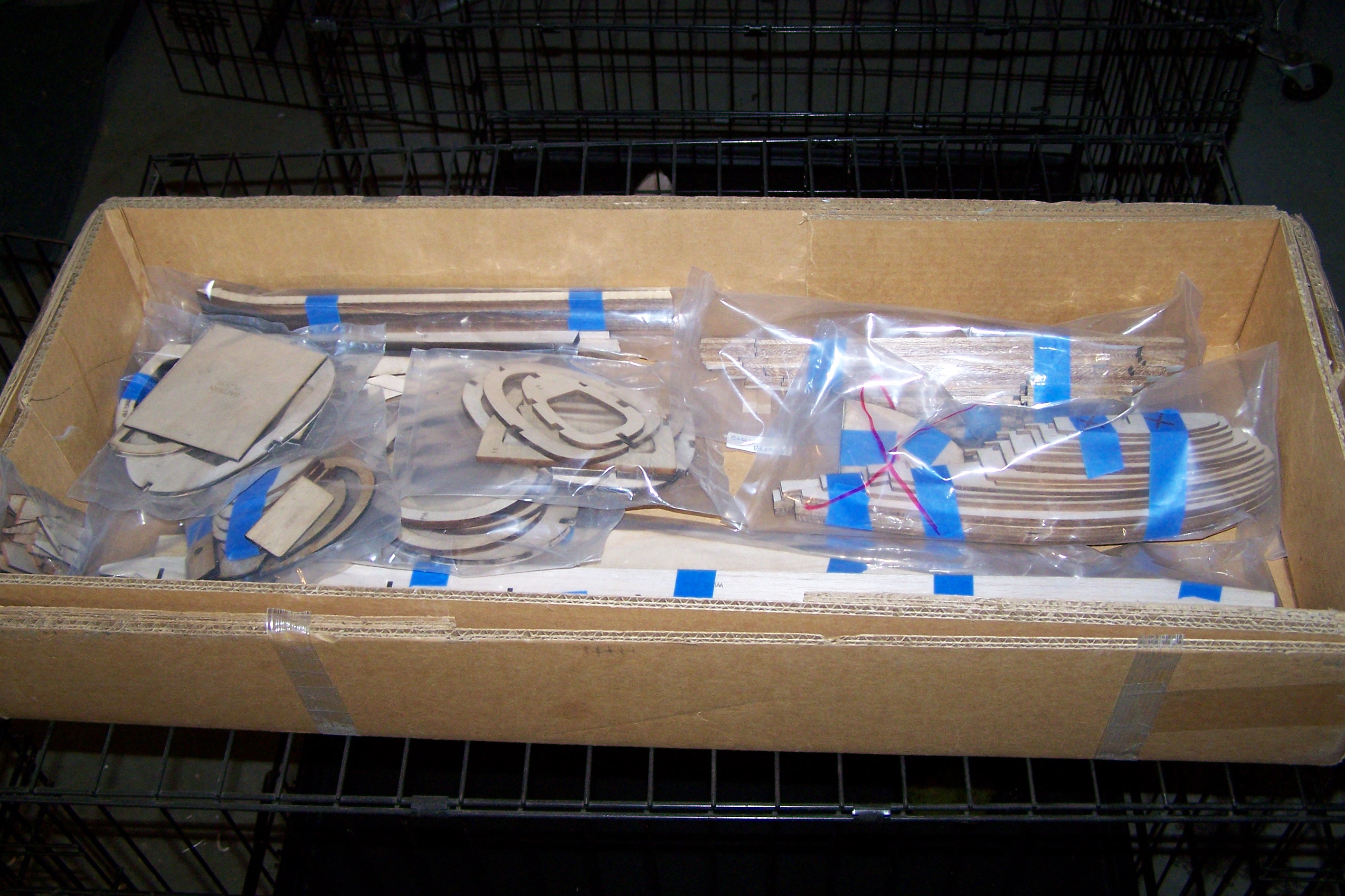

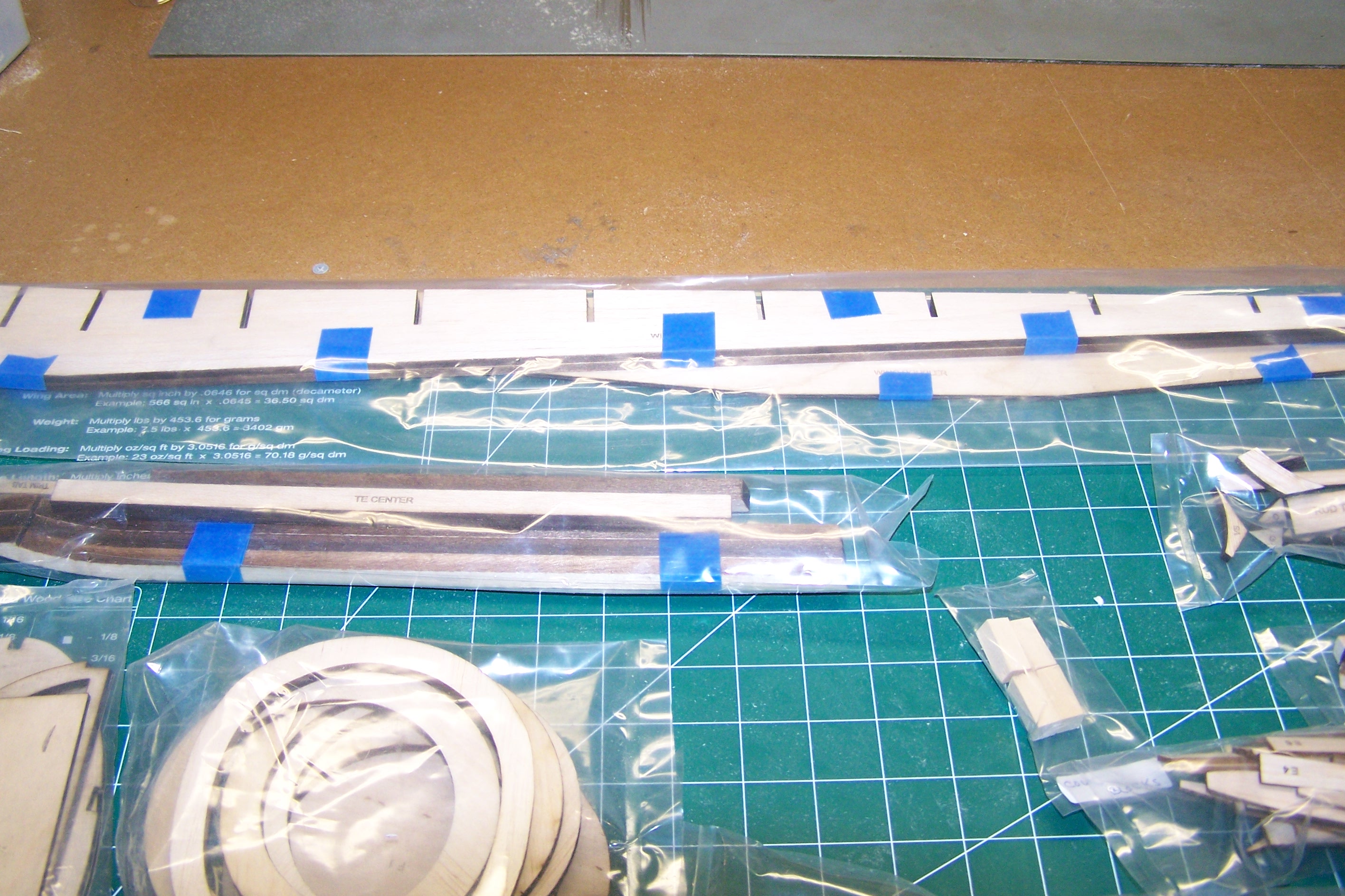

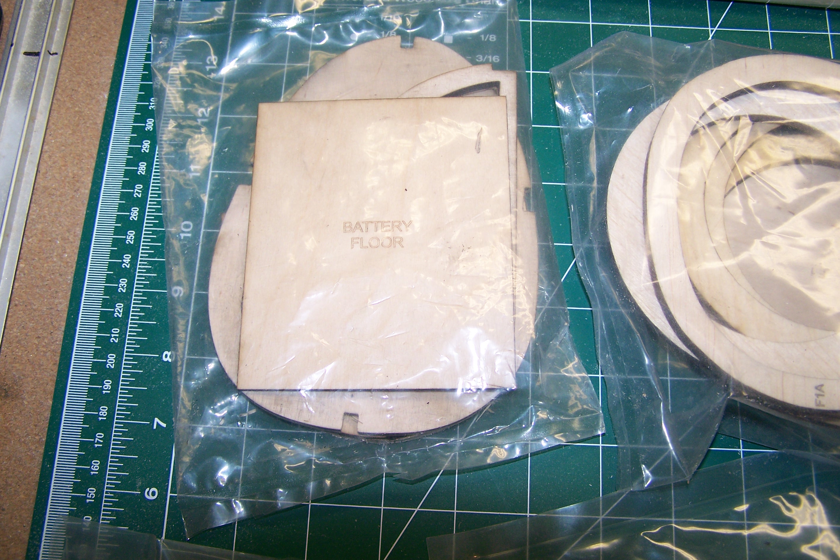

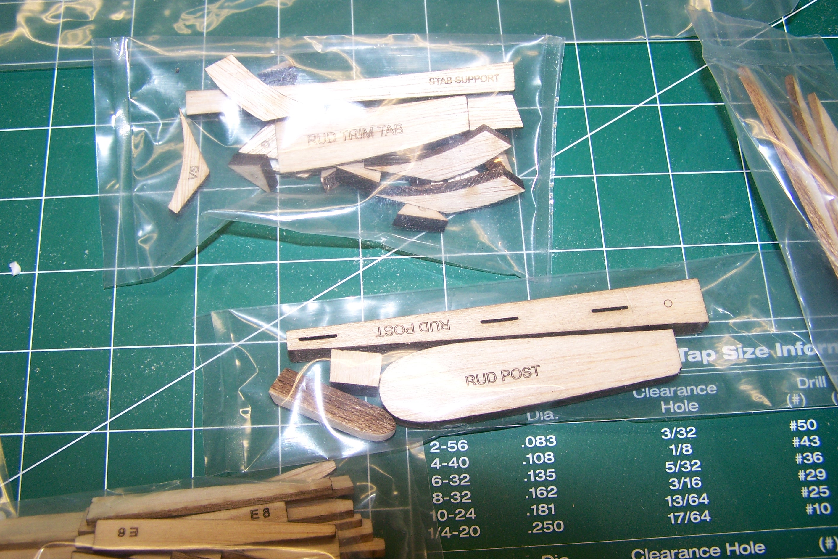

On Saturday I had a package arrive on my door. It was a nice double weight corrugated box taped up nicely. Here are some pictures of Joe's work at Kit Cutters. First, I am very impressed with Joe's communication with me during this process and his concern if I have any problems when I get into the build to let him know and he will correct the pieces for me. Second, the packaging of this short kit was excellent and the pictures show how things arrived minus the packing peanuts. The parts have been packaged in plastic bags in the appropriate groups they belong to. Parts are also taped together to prevent them from getting interlocked and broken during shipping. Another thing I didn't expect was the part's description being laser printed on the part. This alone is a great help and makes this short kit more like a regular kit just minus the stick and sheet wood. Joe included the hardwood landing gear blocks and the cowl mounting blocks. I mentioned earlier that the first cutting of the ribs Joe made to the individual rib drawings proved to be ever so slightly oversized so he cut a new set yet included the others. Those were packaged separately and marked accordingly with a red "X". There is a lot of thick wood in this kit and Joe's cutting is very good with only one piece of ply a little splintery on the edge. If I was judging the entire kit's manufacture I would probably rate it a 95. A few little edges that need some cleanup don't faze me one bit and anyone who is a builder shouldn't worry either.
Another thing I didn't expect but am excited Joe did was make ply formers for the canopy. In the plans drawing it shows each segment of the canopy but only in half segments. Joe cut full segments out of 1/8" ply. I can now take these and attach to one end of each plug segment I'm going to make. I can also take the adjoining segment (which is just slightly larger) and make another ply piece that is just 1/16 of an inch smaller all around to go on the other end. I can then make each canopy segment using these two ply formers as a guide. It might be hard for some to understand but once I start the build you will be able to follow what I'm doing.
What you see is as far as I've gotten so far as I have two others to finish first but they shouldn't take too long. Hopefully within the next 30 days or so I should be able to start building this wing. I will also be building in the split flaps on this and most likely going with a glass cowl instead of the wood one shown. I also need to step the firewall back slightly for the FS engine I will be using. I might be powering it with either a Saito .65 or a Magnum .70 I have. Both use about the same amount of distance so the firewall change has to be done. This is normally a .40 TS sized plane but with the floats and the fact that we have wind here in New England most of the time the .65 or .70 should be about right.
NOTE: Forgot to mention that during my communication with Joe I asked him if he would cut lightning holes in the ribs for me. He told me to email him with the details I wanted and he would do it. If you look at the ribs and the size of them you will understand why I wanted to lighten them up. Joe again did a great job accommodating my wishes. You should be able to see the holes in the ribs in the picture.
