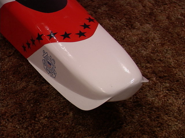

I have seen one. As you see in the pictures, it looks like a scaled-up aquastar. It also has water manners like a scaled up aquastar: meaning the one I saw wanted to push its nose under water when power was applied. Add chines/splash rails to the edges of the hull. It seemed to fly OK, and it looked nice.

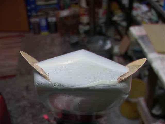

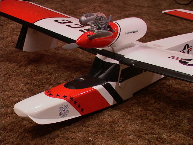

I have been flying a Sig Sealane over the past several months. It did tend to submarine but the most severe problem was water spray into the prop. I added chines to front and it really helped. Now it takes off without prop spray, gets up on plane faster, and is a joy to fly. I will try to attach several pictures of it.
Bill

Bill:
That looks real nice. Since you've been sucessful with it, makes me wonder if I shouldn't do one next. I have the plans for Laddie M's "Arrow", and am leaning towards that. Seems like everyone likes it.

ORIGINAL: willyb
What type of material is that?
Old 05-15-2005 | 06:14 AM
Mustang Fever's Avatar
Joined: Nov 2003
Posts: 3,225
From: Cadillac, MI
Default RE: sig sealane
Oodi
Look at the left pic. Seems like balsa to me, maybe light ply.
